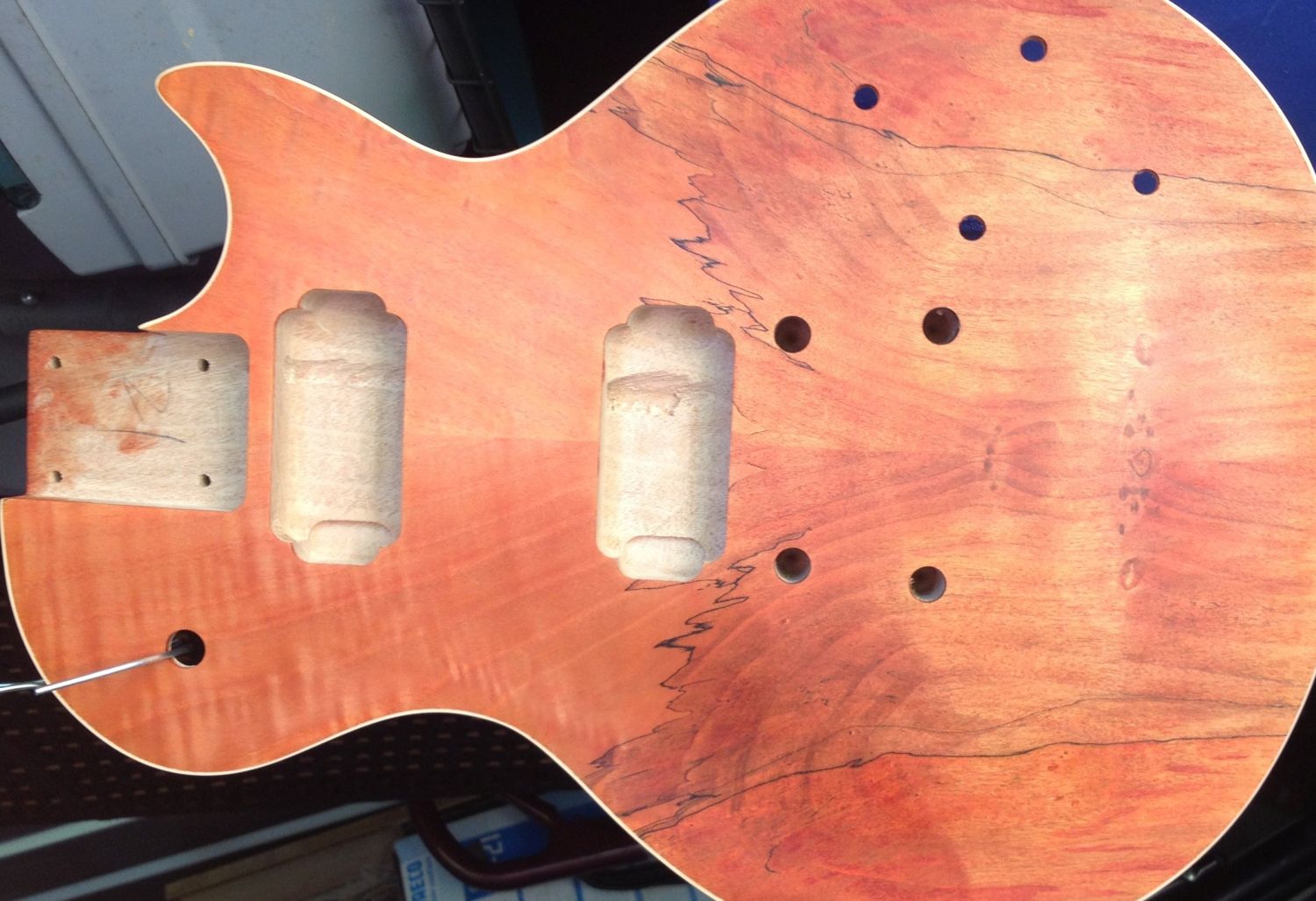

Attachment 8523
This is my LP kit stained with Bush fire Sunrise dingo tone, still to apply the intensifying coat..
Thanks DrNomis, I downloaded it and it worked. The pics don't come out great, but at least I could get something to actually upload..
Cheers mate
Looking good, Hugh.
Looking good Hugh. The Dingotone looks great on the spalt.
Nice work Hugh, first one I've seen with a coloured top, looks good

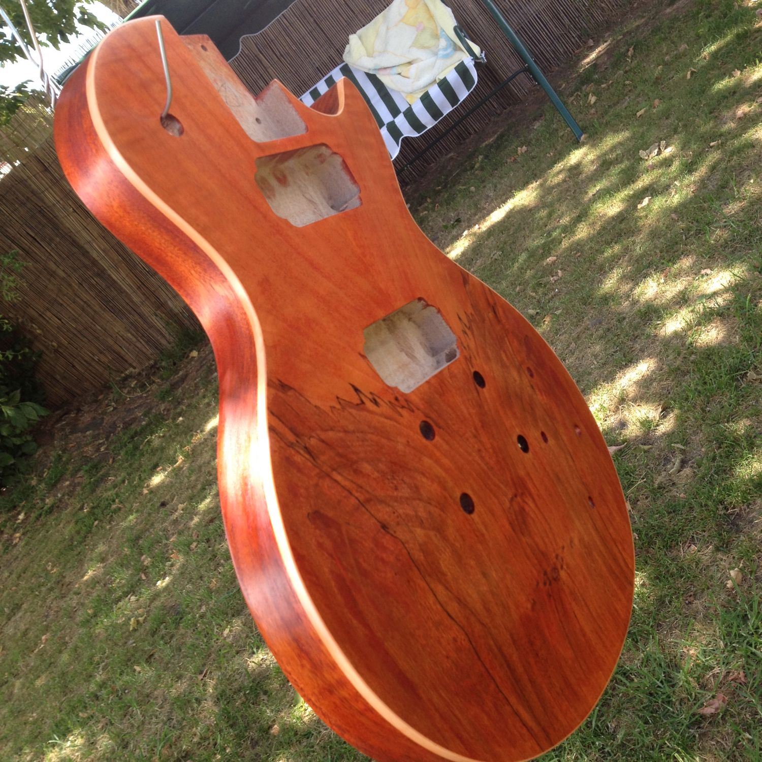

Attachment 8563
First layer of Dingotone intensifying coat..
..and cheers for the support too guys, it's a good community you've got going here..
Veeery tasty LP ya got going there, Hugh.
Wow thats a really cool pattern in the spalted maple hugh!
Thanks Dingobass, Fretworm and Andy40
It is a good piece.. If you notice there is almost like a flame formation in the grain. I actually toyed with the idea of staining that area with a red colour then contrasting the rest of the body with say coolangatta gold to highlight the flame formation... I decided against the idea as I thought it may look a little 'dickie'. But I am happy with the kit I was sent all the same..
Thanks DB, I am happy with the Kit sent to me. Only problem is if you notice I think I may have missread the grain around the edges near the control knob holes and on the opposite side near the top, it's hard to tell from these pics though. Not sure how noticable it will be or whether to just leave it in as a little 'character' for the guitar..
coming along really well Hugh, love how the spalt pattern looks so cool.
Great colour bushfire sunrise one of my favourite DT colours

That LP of yours has a nice earthy tone to it, should look great once it's all finished Hugh, apparently the veneers on some PBG kits are thin and if you sand too much you can end up sanding through it.
I'm going to be starting my first ever PBG kit soon after I get it ordered next Tuesday, it's the STA-1M kit, feel free to check out my build diary.
[QUOTE=DrNomis_44;95826]apparently the veneers on some PBG kits are thin and if you sand too much you can end up sanding through it.
QUOTE]
Ahh.. I see, that could explain it because I did sand the body a lot!! Especially those particular areas as I was trying to 'fix' where I had gone across the grain a little.. Maybe I've sanded the veneer off in those places??

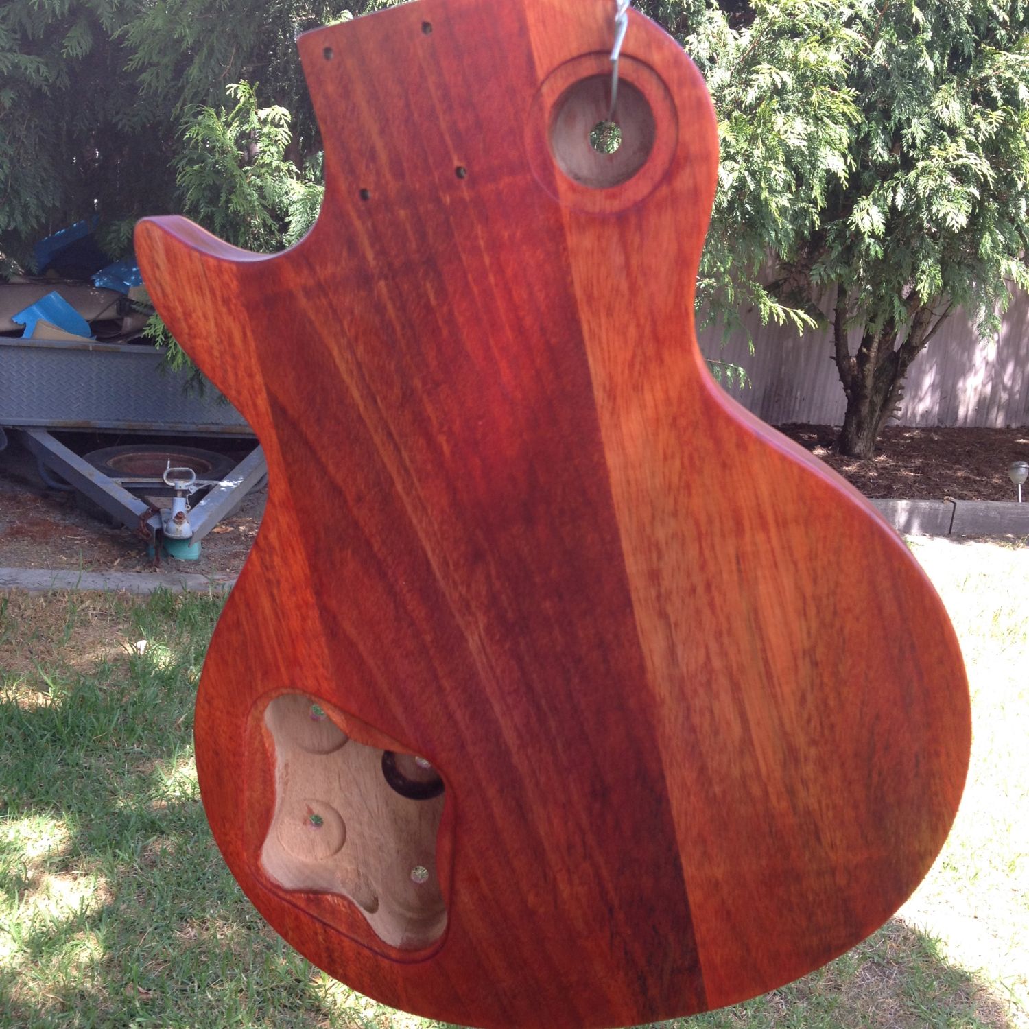

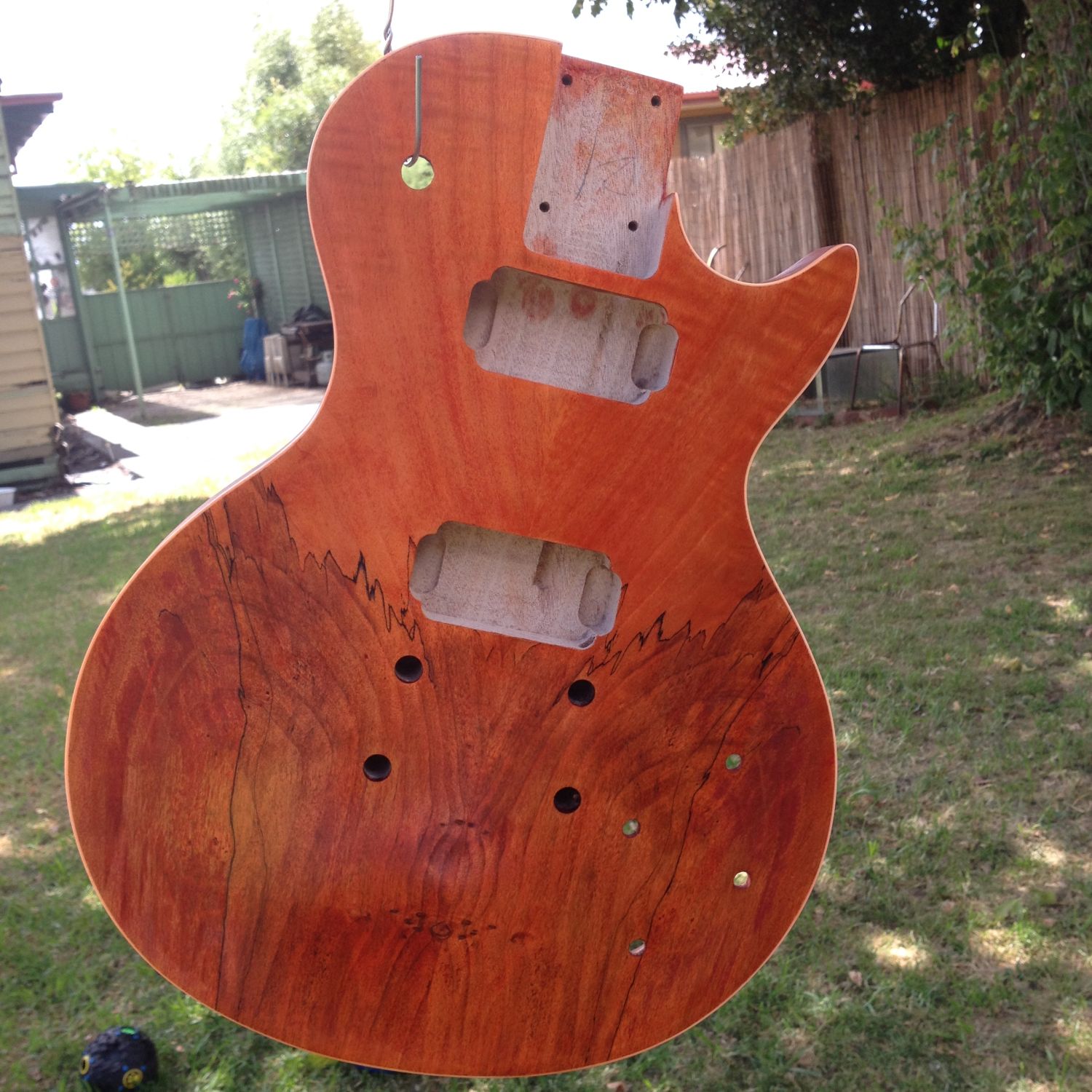

Attachment 8659Attachment 8660Attachment 8661Attachment 8662Attachment 8663
3rd layer of the intensifying coat of Bushfire Sunrise for the body and head stock.
Only 1 coat of clear stain for the neck as I was pretty happy with it's tone after the first application.
Thats such a minimal looking finish but with the figuring in the wood grain it pops so much. Very pretty, you should be immensely proud of that effort Hugh.

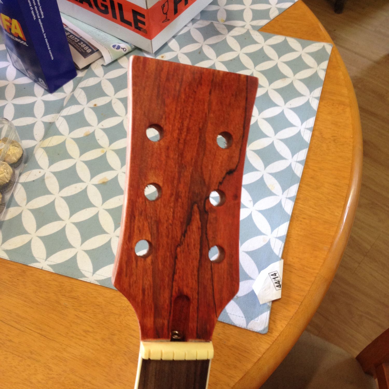

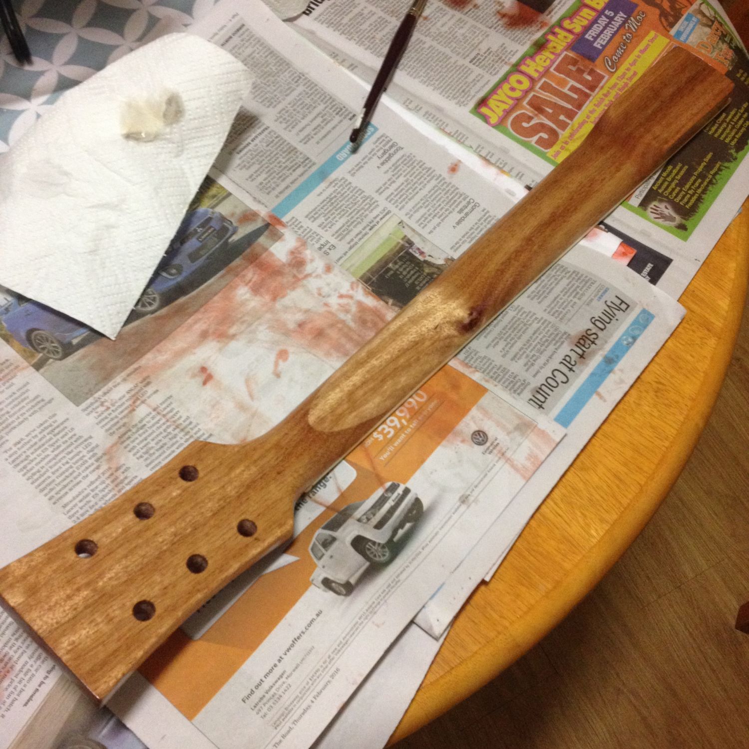

Attachment 8695Attachment 8696Attachment 8697
First layer of finish on the neck, looks pretty good I reckon.
About wednesday or thursday I will put the first layer of finish on the main body of the guitar.. really looking forward to seeing how that turns out!!
Yes, that is one nice looking neck!
