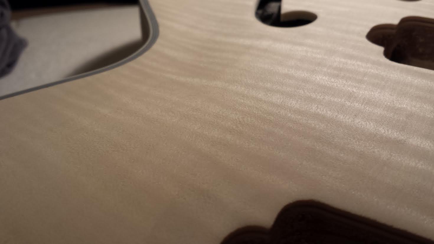

The first being, how much sanding is required?
I bought the Dingotone kit which goes from 180g through to 400.
I've done a run through all of them but I've noticed some slight pitting between the veneer grain that runs across the body. The surface itself feels very smooth, but the pitting (if that's what you'd call) is noticeable under light.
I'm not sure whether trying to sand the pitting out with the 180g would be overdoing it.
Would post a photo but It doesn't show up. Any advice much appreciated.

Hey John, looks like a great kit! Be very careful sanding the veneer - it's very thin and there's a good chance you'll sand through. When that happens it sucks the big one. Any chance you could post a picture of the "pits" in the surface? Maybe some steam might be a possibility to raise them out, but hard to say without looking at them.
1 Attachment(s)
HI Gavin,
Thanks for the reply. Pic attached, probably doesn't show it very well, actually it makes it look slightly worse than it is.
I spent maybe a 2-3 minutes sanding with each grit? I'm new to this whole sanding lark.
As i mentioned, the surface is very smooth, so maybe once I apply the stain etc. it won't be as noticeable?
Thanks again
John
Attachment 6501
Hey John,
Noice kit :)
With the veneers, you can always expect some pits.. Best not to over sand it as Gav pointed out.
Sand it to 400 and go mental with the stain :p
Most of the pits will be filled by the Intensifying and top coats. As each layer cures, you can gently scuff sand with the 400 grit... Just don't get too carried away :)
By the end of the finishing process most if not all will be filled.
If you have any dramas, just yell out!

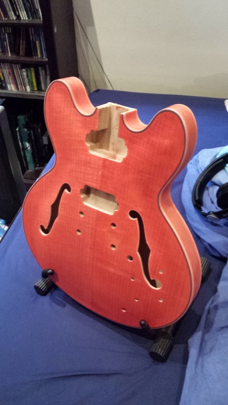

1 Attachment(s)
So heres the body after 4 coats of Karijini (front and back).
I'm after a deeper red but wood colour is showing through giving it a salmon-ish hue.
So getting a second bottle of stain delivered so i can apply maybe 2-3 more coats.
Attachment 6592
hi John,
good move to get another bottle of stain coat. 2-3 more coats should be getting deeper and ready for intensifying coats.
There's no need to steel wool too much between coats, just a light rub so you don't lose too much colour
thanks wokka, you just answered my next question.
So, light rub with steel wool before applying more stain coats, got it ;)
that's it John, just to remove any high points or lint from the cloth that stuck and to give the next coat bit of tooth.
Usually 2-3 minute light rub with super fine steel wool is enough. Any more and you will remove to much stain

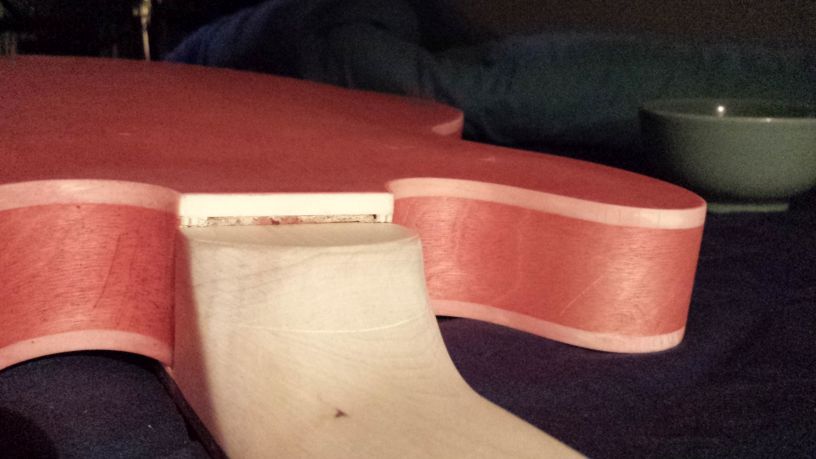

1 Attachment(s)
also noticed a wee gap underneath the neck.
Not too fussed about it to be honest, but has anyone else had this?
Attachment 6736
Hi John as long as there is no gap between body and fingerboard ?

1 Attachment(s)
there's no gap, the neck is just sitting on the veneer, if that makes sense.
can't get closer as i'm using my iphone and it blurs out. heres a larger photo,
Attachment 6738

Hey John, might be worth trying to get a white filler in that area between the neck heel and the body binding, looks a bit messy as it is. Might blend in better if you try and match the binding colour, or another option is to get matching binding, cut into small pieces and put in a bowl of acetone and it breaks down to a liquid and use that to fill it
thanks wokka, good advice, i was probably going to stick some filler in there, but the binding/acetone thing sounds interesting.
I guess either the body is thicker or the neck is thinner than usual, as i noticed on Swanny's 12G it doesn't looks so bad.

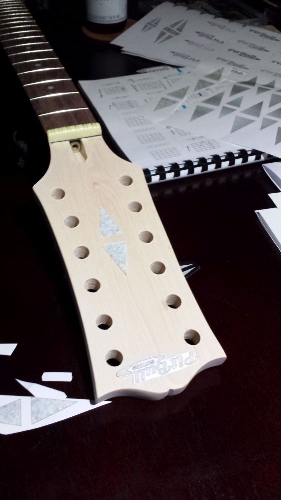

1 Attachment(s)
I've gone the easy option with the logo, The Diamond thingie I saw on an old ES 12 string, and the Pitbull logo.
Made them up on CAD (hope thats OK Adam?) and printed on a pearl background. Will send them off to Nova to get them printed on decal paper. Hoping they'll look almost pearlish under a couple of finishing coats
Attachment 6821
That logo should look good John. Are you putting colour on the head stock?
yeh swanny, i'm going to try and put a black stain on the top face, just have to make sure I mask the sides off
That's what I was planning for mine. It seems that masking tape is prone to leaching, so maybe don't flood the edges with stain.
Guys you might want to get some 3M pinstripers tape instead of normal painters tape. It makes a much better seal and you get very little leakage. You still should be careful just in case, but it's heaps better. Personally I love the 6mm 471 tape from 3M and use it every time I mask off to create the edge I need. I use blue painters tape attached to the 471 to mask off the rest of the area.
hi swanny/gavin, I used 3m blue masking tape on a test piece with black stain and the results were disastrous. lots of seepage under the tape. I've been told that using a light coat from a spray can over the finishing coat might be a better idea?
gavin, did you use the 471 tape with stain?
No, I must admit not with stain edges. Sorry it wasn't of more help.
Gav
John, I guess the nature of a stain is to soak into the grain, which will hold the colour of the stain applied. From what I've tried, it doesn't matter if you tape off an area before staining, when you apply the liquid it will be absorbed by the grain, and depending on the density of the timber, will leach through the grain under the tape, like a sponge.
For a flat surface like the headstock, if the sides are stained a lighter colour than the black you have planned for the face, then maybe spraypainting the black would be a better option. The paint will dry before it has a chance to be absorbed into the timber to show up around the edges.
Maybe many light applications of the stain would have the same effect, so the stain dries before it can be absorbed into the timber.
This is just my thoughts on how to approach the leaching problem, and others may have a better option.
What I typically do is to paint the headstock face and dye the rest. On my current LP build I taped the edges with 471 tape (and stuffed the tuner holes) and sprayed black auto paint. It was easy to clean up the edges with sandpaper because I hdn't stained there yet. I then added some lacquer for protection (using 471 again) and cleaned up the sides with sandpaper again. In both cases there wasn't actually any paint on the sides (the masking took care of it) but I wiped with sandpaper anyway just to clean up the paint/lacquer edge. After I was happy with the face, I then stained the rest of the headstock, just being gentle care on the sides and top that I didn't disturb my nice black edge. It worked well for me.
thanks for the info/advice chaps, looks like i might grab a spray can.
Might use your method next time gavin, headstock face first, then the rest
