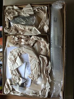

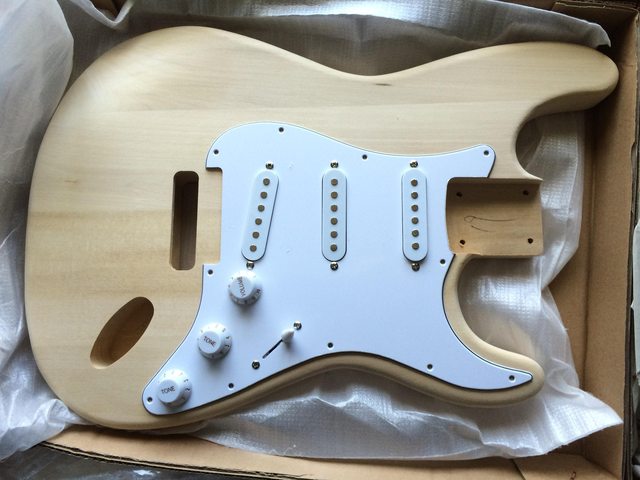

So this is an ST-1 I bought in the 3rd Anniversary Sale. Seemed like a good excuse to buy another kit.
Attachment 5000Attachment 5001
Still figuring out what I'm going to do with it.

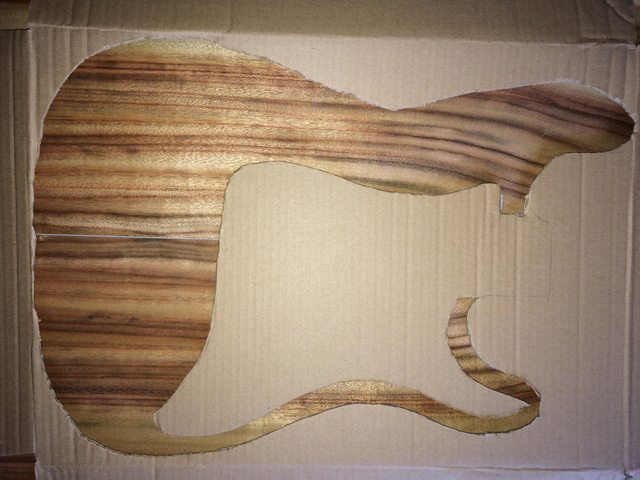

So learning new build skills. I wanted to do a veneer. The basswood ST-1 is a bit plain, so it seems like a good candidate.
I have some camphor laurel bookmatched veneer.

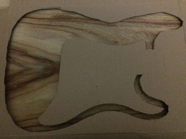

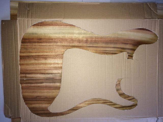

Cut a cardboard template to see what it might look like strat shaped...
Attachment 5004

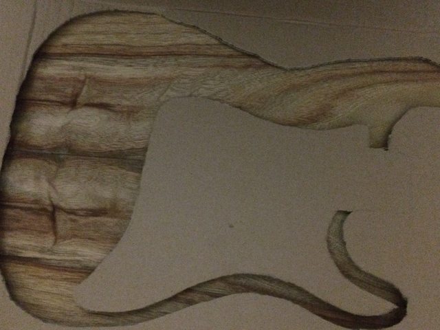

And again, slightly moved over.
Attachment 5003
hnnng...
Hopefully there'll be some veneer left to do the headstock as well.

By the way, those photos might look like I've started cutting already, but the only thing I cut was the piece of cardboard that is sitting on top of the two sheets of untouched veneer. It's a mask.

So I got out the body and neck, check the fit and the scale, etc...
Nup. That does not fit. No one has even checked that before.
Attachment 5066Attachment 5067
I don't mean it's tight. I mean it would take a hammer and then it would never come back out again - or break.
Attachment 5065
Doesn't even really match the same shape curve at the end.
That's as far as I got with the unpacking.

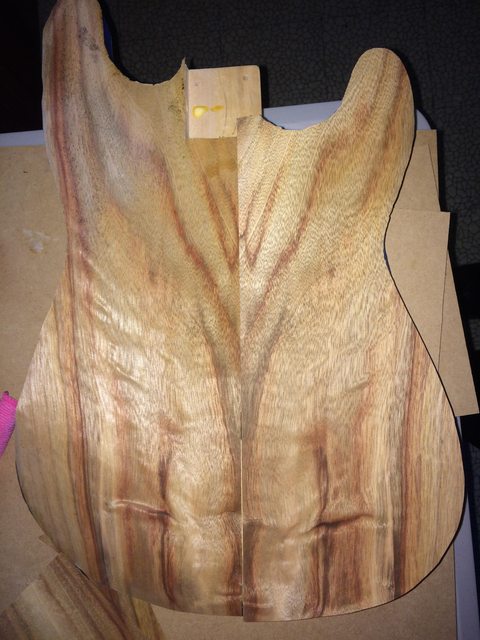

Template and cut the top section of the veneer. This was sprayed first with veneer softener.
Attachment 5123
Apply glue. Titebond I.
Attachment 5124

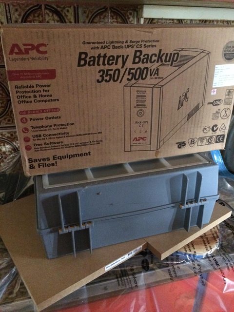

Vacuum press.
Attachment 5125
This is just a common vacuum storage bag and household vacuum cleaner. Wasn't going to lash out on a proper vacuum press and pump at this point.
and press...
Attachment 5126
(that heavy UPS I haven't been motivated enough to install finally has a use...)
Removed from the press hours later.
Attachment 5127
This is where I realised that at some point my template had gotten flipped over.
The straight grain was supposed to be at the end of the body with the curved grain under the pickguard.
It had a better look about it.
Tried to make the other section line up and look acceptable, but couldn't so it was time to select the undo function.
Steam to loosen the glue.
Attachment 5128
And peel...
Attachment 5129
Some time later... a ST body with veneereal disease.
Attachment 5130
Some more work with a cabinet scraper and then some sanding cleaned it up well enough to provide a smooth surface for another attempt.
Deciding between these two of the possible layouts of a couple of replacement veneer pieces.
Attachment 5131Attachment 5132
Probably the first one as it has the most detail.
Going to make triple sure I don't flip any templates this time.

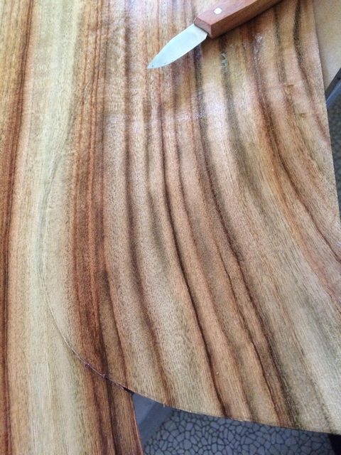

Just checking it and it's got ripples.
ripples in the veneer!
aargh!!!! hate it when that happens!
its not easy to get right Sam and may take a few goes. Headstock veneers are much easier as they are so much smaller than a guitar body and you can get clamps all over the surface of a headstock.
Do you have to buy more veneer ?
Will the ripples be hidden by the pickguard ?
I won't be buying more veneer. Veneer costs would get to be much as the kit was. I won't be peeling the guitar again either. That was a real chore the first time.
Turns out most of the ripples pressed out.
There's just one where end of the elbow cut is. Wouldn't notice it playing, and wouldn't notice it unless went looking for it with wandering fingers - can barely see it and even then it looks like part of the elbow cut.
