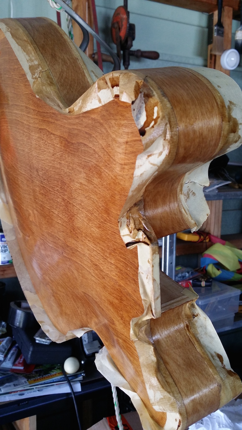

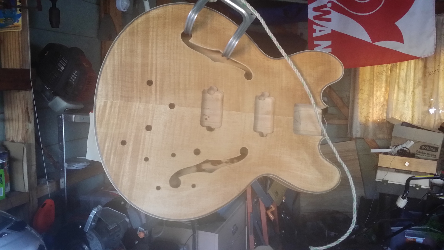

Attachment 4623
I'm using Feast Watson Stain and Finish in Aged Teak for the main colour. There's 4 coats on now and the body has stopped absorbing colour so it's time to switch over and do some clear coats. I'm using Feast Watson gloss varnish for that.

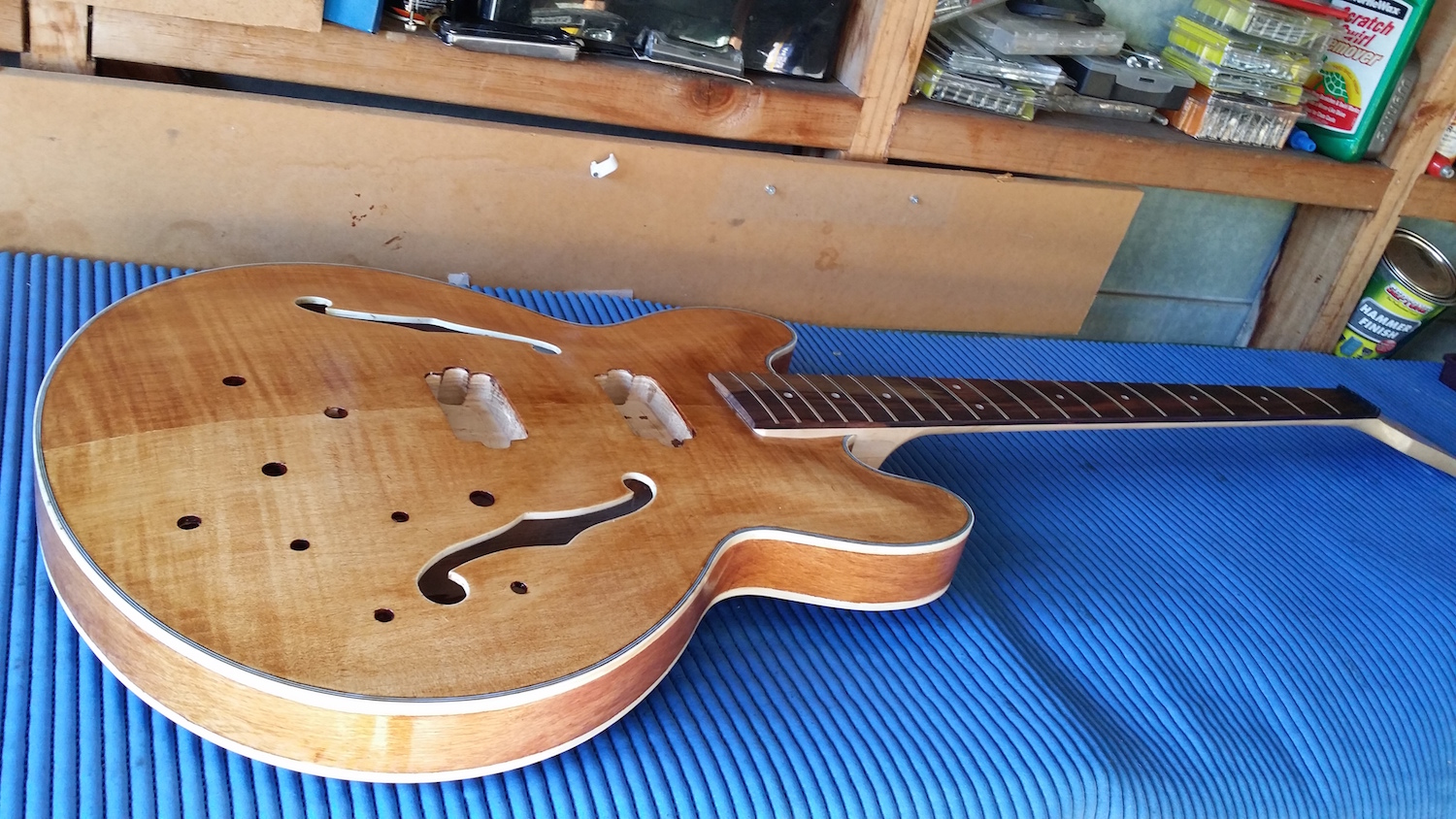

Here it is with the faces coloured. The edges have just this morning got their second coat of stain on, so the masking tape will be on for a couple more days at least.
Attachment 4624
For the neck, I'm just clear coating in the same varnish as the body, and I've oiled the fingerboard.

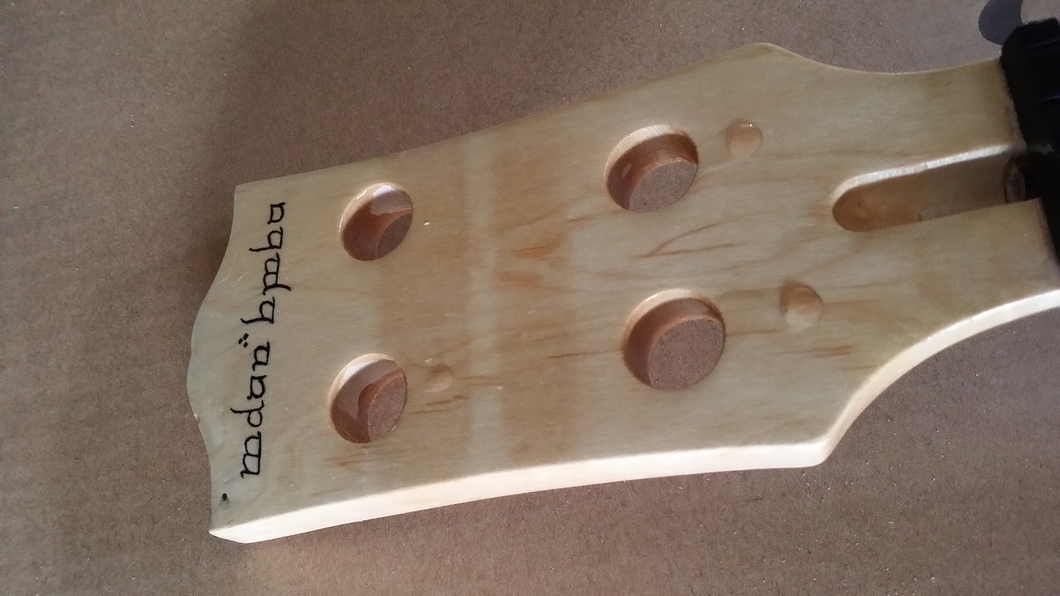

Well I've got the headstock nearly done. The pic is after 2 coats of varnish and I've added a logo.
It's my name in elvish - done by carbon tracing a printed version onto the wood then filling in with light-fast permanent marker. I bought a "proper" archival grade pen for the job.
I've since added another coat of clear varnish to seal it all in and that boosted the colour a bit too.
Attachment 4650

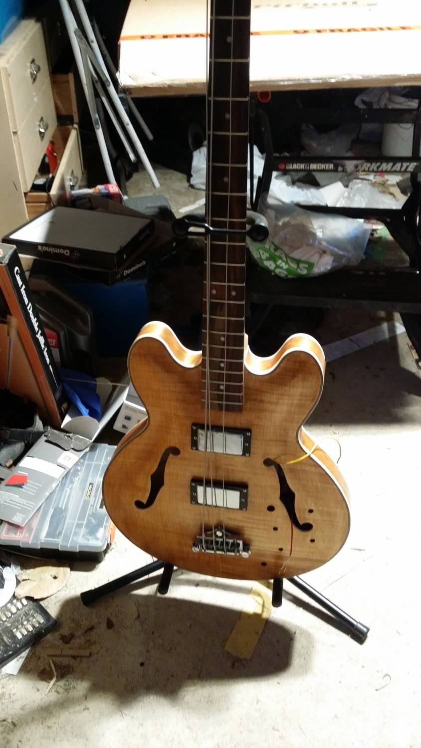

Ok, I didn't feel like I was rushing it - but the beast is built already. Here's some more photos.
Attachment 4691
I've got the bridge and head hardware on and the pickups mounted. The whole thing was then put aside in the guitar stand so I could clear the rack for doing the electronics.
That is, put aside after test fitting the controls etc to plan the installation of the electronics.
Attachment 4692
At this point I'd actually soldered one pair of components together - If you've got good eyes you'll see on of the caps sticking out. I put that pair in the other hole when it was all done.
Speaking of soldering, this was the one down side of the kit. The supplied wires were sections that looked to be ribbon cable. I really don't like ribbon cable as the core is too fragile for my liking. I didn't have anything else spare so I used it anyway, but next kit I'll buy the cable I like using first :)
After a couple goes installing the loom and removing and fixing broken wires and reinstalling, it was time to check that everything worked as expected.
I checked with the electronics outside the axe first, then after each component was loaded. This saved time with breakages and once I calmed my excitement it went a whole lot more smoothly (funny that).

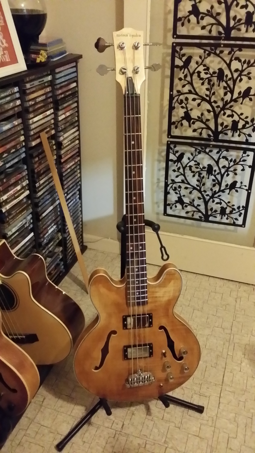

So here's the final beasty. Not the best photo, but you can see it all.
Attachment 4693
Now it was time for testing. Acoustically, it's not as loud as the acoustic bass in the background - that's to be expected. But it's got enough oomph for private unplugged practise. It's a nice balance that way. Intonation is dead on target.
So, I've plugged it into my 50w amp...
and it sounds as good as it looks. A very fat bass growl with no hum at all.
I'm a happy man, but still got one empty slot in my rack...
