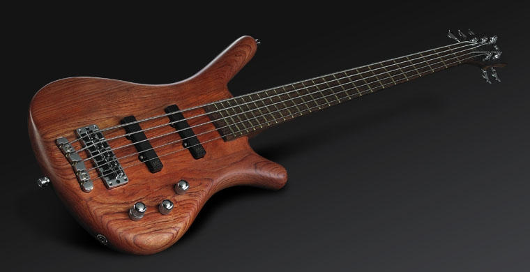

I have a Warwick Streamer and very second hand Corvette. I dont play good enough to own either of these, but I love them.
any chance of a pic of your 2 bass's ?
Bet you will end up taking the Corvette to work site and leaving the IB-5 home haha
3 Attachment(s)
Attachment 4444
Attachment 4445
Attachment 4446
The Streamer pic is mine (the colour is a bit off), the Corvette is the same as mine.
nice looking axes Asarge. So the Streamer is the top 2 pics or top pic ? Looks like a flame maple cap.
Presume the corvette is the bottom pic. Both look very nice
Thanks, yes and yes. The steamer is the top two pictures. Flame maple top with a swamp ash body. I find it very comfortable. The flame maple top is about 1 inch thick. The corvette has a bubinger body. Heavy! But such a nice sound.
sounds good Asarge, I can see why you don't want to take both those bass's to a FIFO job.
1 inch flame maple top they could have made 20-25 veneers out of that !
