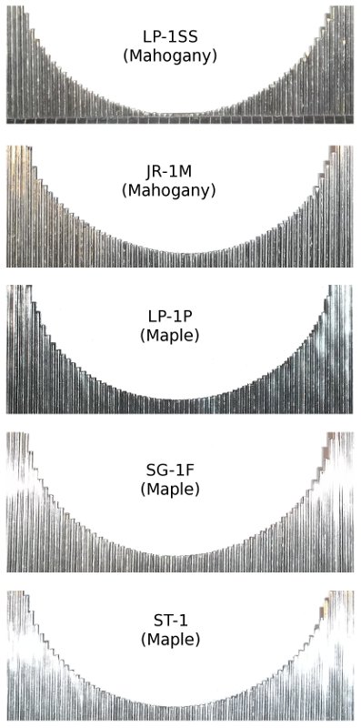

I've got a contour gauge so if you want I'll try to grab some impressions from a couple of untouched necks and post some pics for comparison, hopefully tomorrow. That should give you a reasonable idea of the shape/profile etc., maybe an LP, SG, JR and ST for comparison.

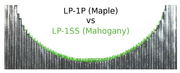

They're a bit rough but, as promised, here are the profile comparisons. All of the profiles were measured at the 5th fret (up to the edge/start of the fretboard). I tried to keep the scale of the images as close as possible, but they're not perfect.
I've found the Mahogany necks have a slightly thinner/shallower profile than the Maple versions, so I've included both, plus a direct comparison between two Mahogany/Maple LP variants.
