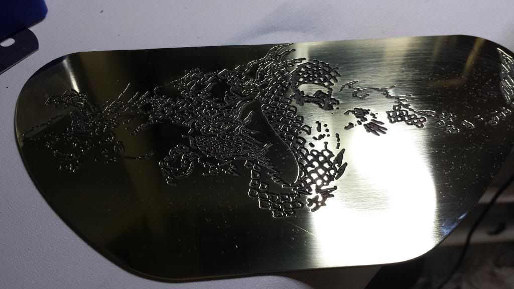

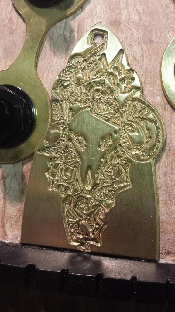

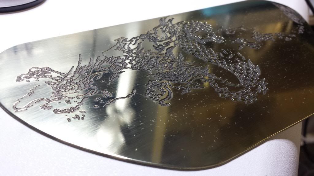

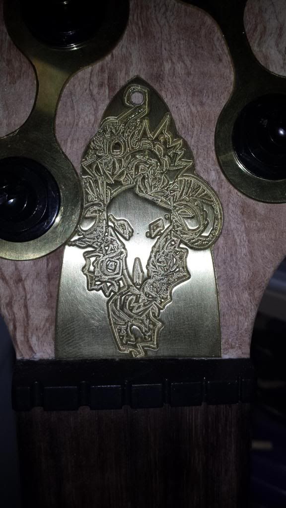

some carving engraving will commence shortly on this build nothing is decided yet and will create as we go along may set the neck as well will look into the problems created by doing that if any, Im going for a Celtic type design for the carvings and engravings as a distant token to my name connection
so here we go! lets see what happens now!

good to see another IB-6S, looks good Hadyn, what colours you got in mind ?
Welcome to the elite club Haydn. As Wokka asks, what are your plans for colours? It's great to see another one of these being built.

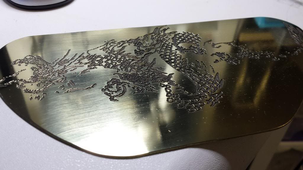

It will be mainly plain after the carving has happened may just highlight some edges to give it definition but also a few engraved metal plates will be on my mind too, I did have a plan in mind to do a really deep carving then fill it with clear resin so its a clear top with depth 3d look if ya will, thats one of the cats out the bag!
Looking great Haydn - those IB-6's are sweet!
Well, I'll be watching both the cat and the bag!

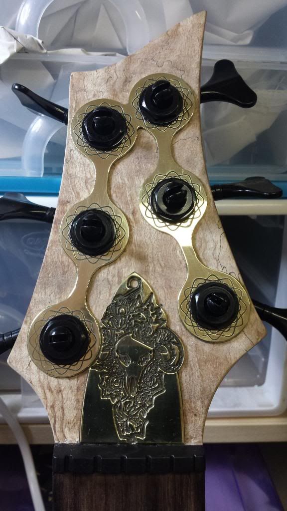

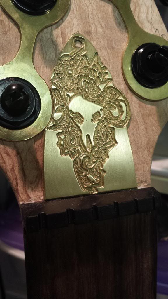

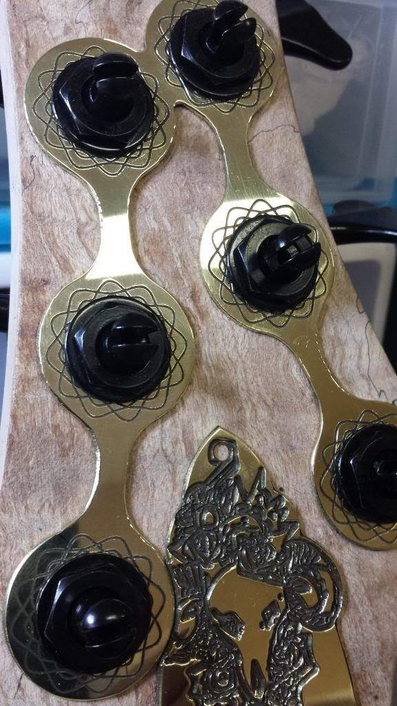

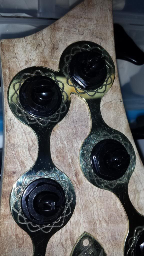

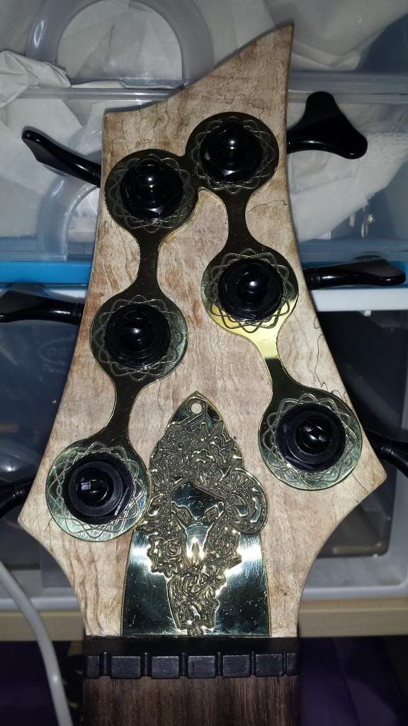

repositioning the tuner peg to the correct place WTF where the hole drillers thinking here.....oh they where'nt!
http://i893.photobucket.com/albums/a...124_144410.jpg
http://i893.photobucket.com/albums/a...124_145320.jpg
now to take an hour round trip to nearest bunnings for wooden dowl to fix this kak!
Where did you get the fancy tuner template from vanhaydn? It's cool.....and I don't have one, and I desire one!!!! :)
it's a beast! love the workaround for the tuner holes
Dang!!!!! There are some talented people on this board.
w o w ... that is brilliant work VH, nice
thanx !
its called turning a pigs ear into a silk purse gents! not easy but has to be done ! bit OTT really but better than gawking at a 14.5mm plug repair!
Now that is hugely creative and aesthetically awesome.
Wish I had your level of sophistication and the CNC gear to match.
I am truly blown away by your outside the square designs and the execution of same.
Busting to see the finished job . . .

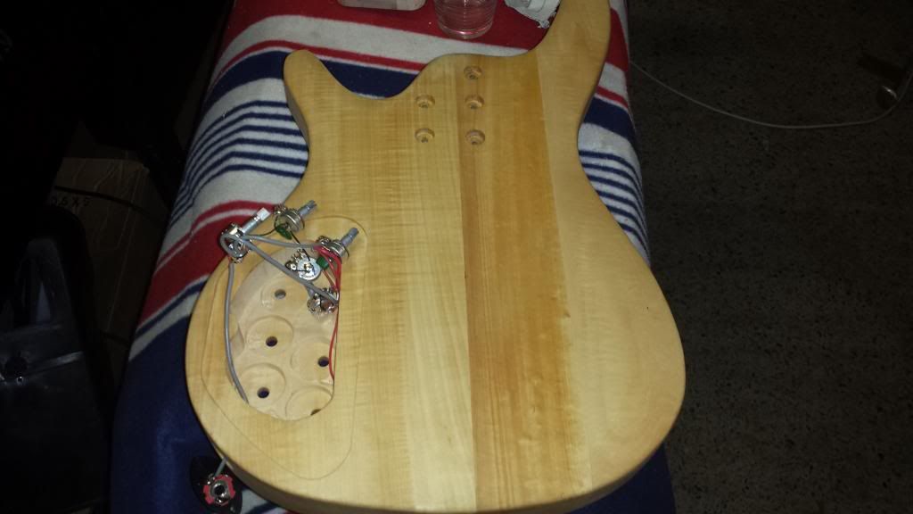

couldnt find a wire diagram for it so just made my own with a toggle switch while waiting for the active circuits to arrive from good old u s of a!
at least can see if after setting internation the bridge has to move

Looking mighty fine Haydn. Be really keen to know your bridge measurement when you're finished. It'll give me a good ball park for when I do mine. Also very keen to hear how she sounds.

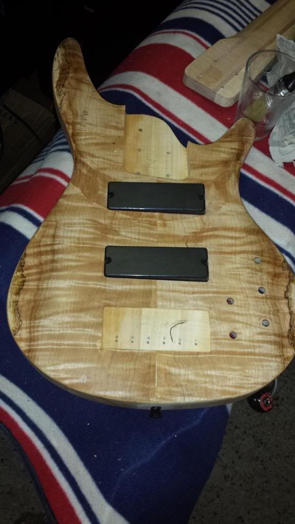

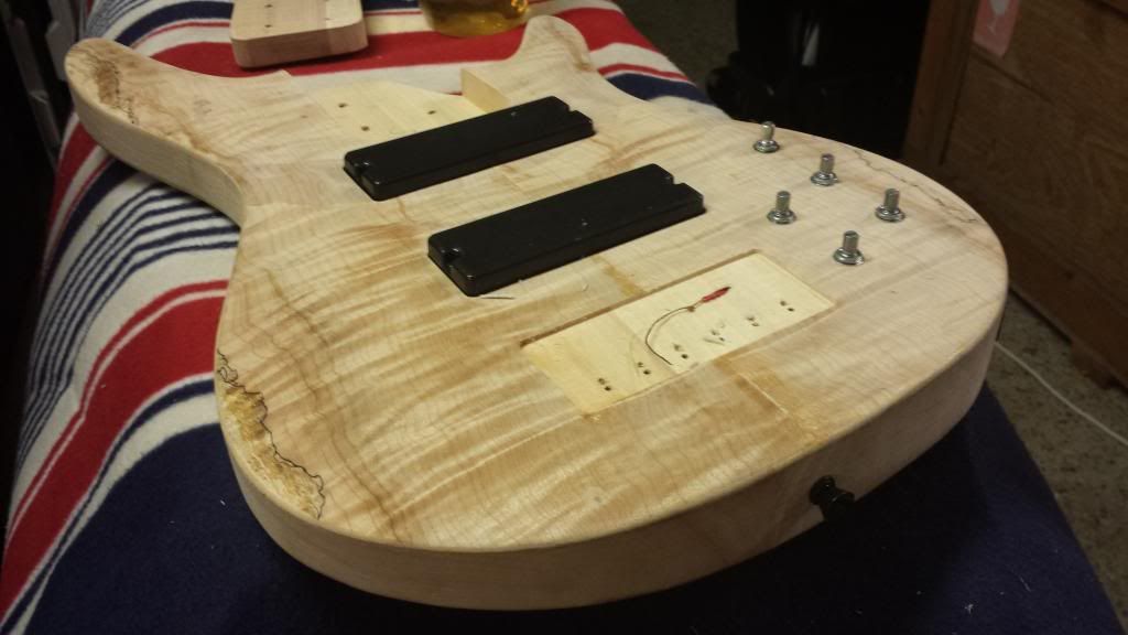

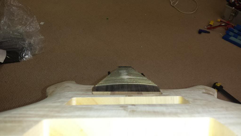

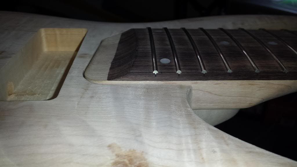

Finished the set-up and a few things need moving, 1-stly not going to shim the neck I like the 100% flat on flat in the footing. so dropped the action at the nut 3mm its still a bit high all round took more off and went to far so shimed up with some brass plate and now am in need of making a new one from brass stock that will be collected 1st thing the stores open!theplastic nut is shyte!..it was just stupidly high, now the action on the 1st string needs to be dropped further so will file deeper into the nut, but the bridge is still to high with the grubs completely removed. also once I Had done the internation found the bridge can move 4mm forwards from where i chose to put it, internation is completely different to my 5 string shapes in the bridge saddles. so now will move the bridge and machine a pocket for the bridge to be lowered into giving me full adjustability in all directions! The sound is pretty good for a passive setup with the stock everything out the box, will make a recording tonight
will be keeping it clear wood and just surfacing with a high gloss clear coat of some sorts once ive decided what brand to use thats available in Oz!

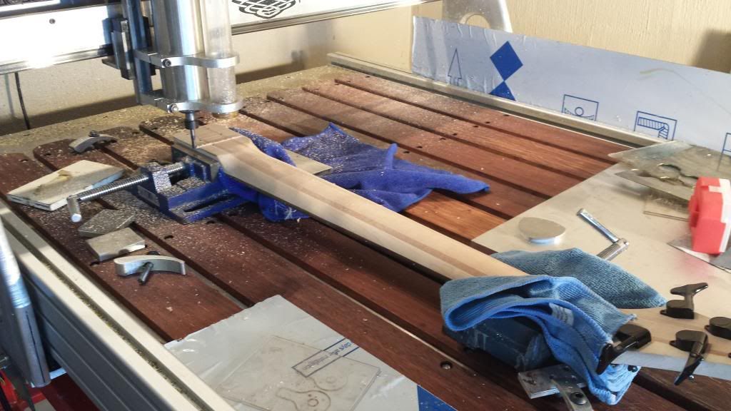

machined a couple of nuts so far so good...the 1st one turned out great...except it is for a left hand bass...funny last i checked i dont have a left hand bass...oh well reverse cad drawing and cut again! hehehe oh i love my little mind sometimes!keeps me entertained!

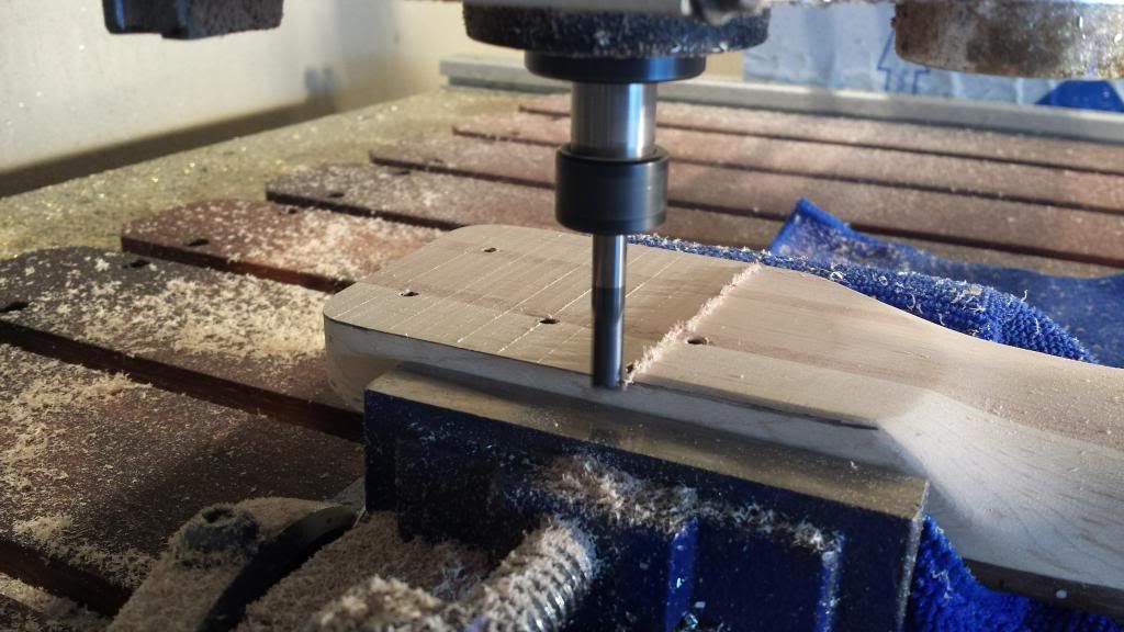

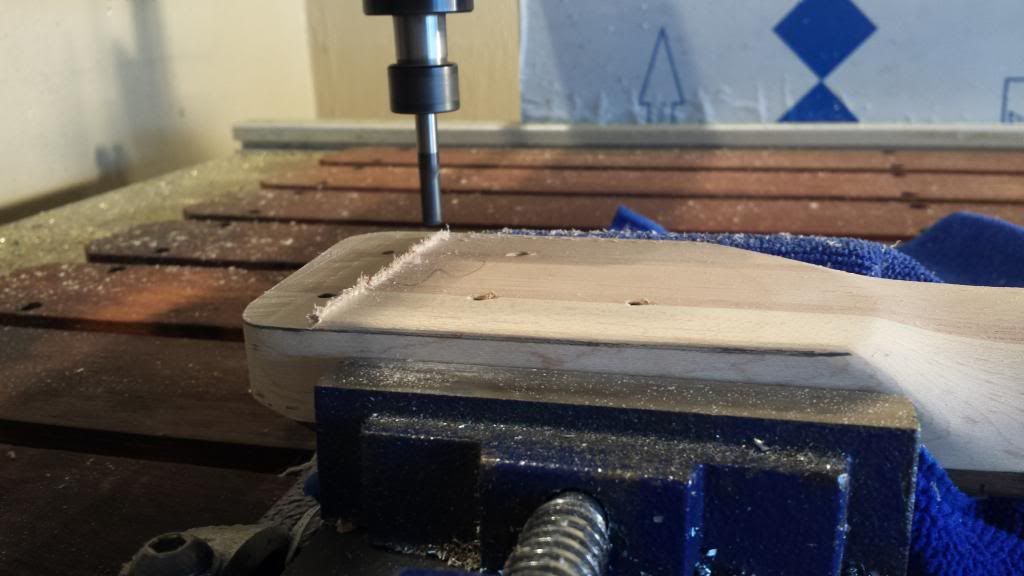

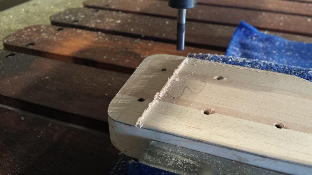

Now have full adjustability on the bridge can go up down and back and forth giving the perfect internation and action settings in all directions, woohoo! did the setup now and only have 1 position buzz on one string..how kaka is that!
oh well cant win em all

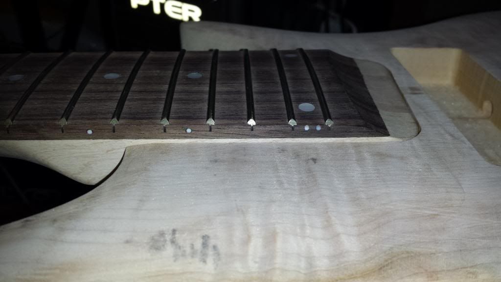

sunk the bridge 2mm giving a 100% flat surface " the bridge rocked before" so now neck pocket 100% bridge 100% contact with body no shims YEA BABY! very nice vibs through the neck and body now

looking sweet Haydn, you are so lucky to have access to the CNC machine you have so many options available. Love the truss road cover and tuner/headstock decorations too !
So was the action too high with the original bridge ontop of the cap setup ?

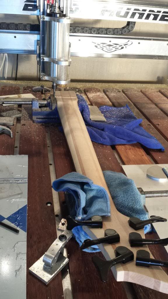

yes it was, didnt give me enough room to move down even with grubz removed, I like a fast low action on bass same as guitar really but hey ive seen some bases with a really high action and guys love it. not for me I like a slap bass low action so needs to be really accurate and setable...her is the vid of the pocket cut,
I built my own cnc machine to get 24/7 access only cost 5k in parts so really worth it in the long term ! just my imagination is the limit woohooo!
http://www.youtube.com/watch?v=Axbb6axUJEo

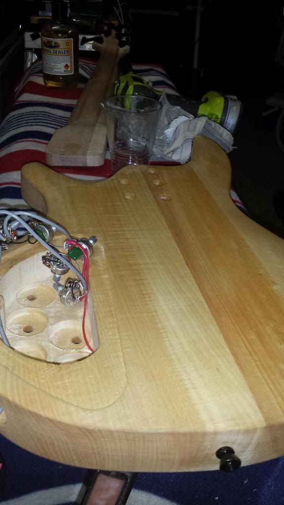

now to strip it all down give a very small fret dress and paint! or clear ! swopped out the one pot for fader/mixer pot, very nice like it! may just keep it as it is!
What this one lacks in spalting it makes up for in flaming. Nice.
yea man even the crappy basswood has some cool flaming action going on there around the top edge too, I can tell ya the shallac is strange to work with, Its a first for me very sticky stuff indeed!
Looking great dude. That cap is something else!
nice piece of wood, this will look great when finished
it looks sensational already!

on my build the distance from the 12 fret (Middle of the Fret) to beginning of bridge plate is 42.5 cm and I have internation tuning in all directions on all the saddles with space to move as well so great spot, got there after moving the bridge 4mm forward from my 1st prediction, the 3rd string saddle bound up against its spring and hadnt reached its tuning point yet
internationis 100% correct and action is about as good as its gonna get,will play it in and see how it settles

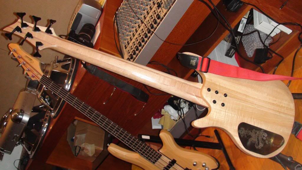

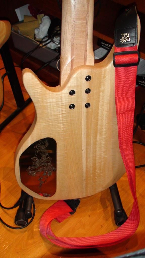

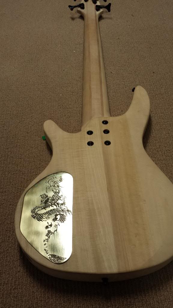

its finnished now well apart from a preamp install when it gets here,dont want to spend too much time on it have sooo many other things to do must crack on!
it plays it behaves lets see how it endures

nice little fire in the basswood there!
