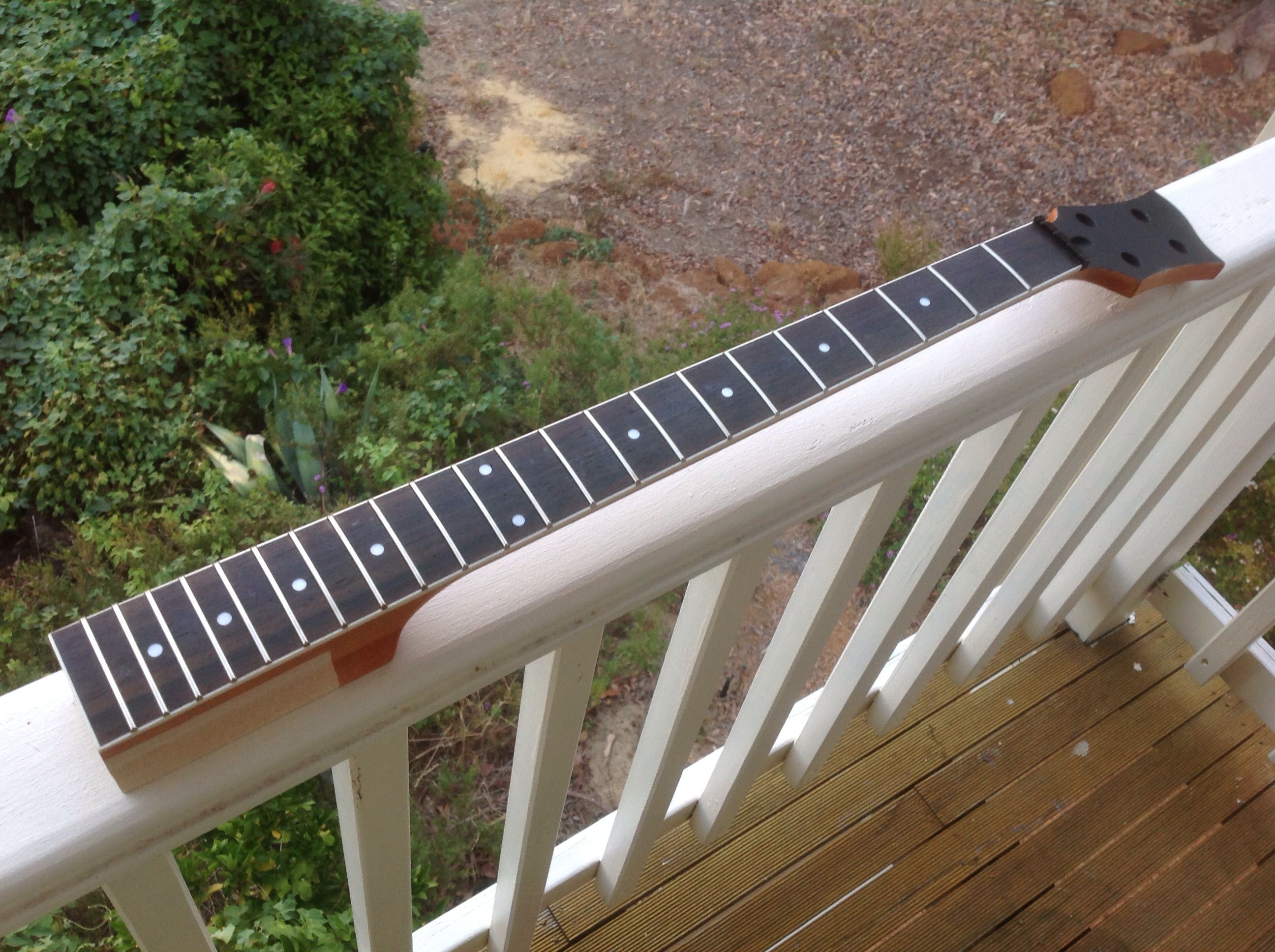

No, I have sprayed the headstock jet black, as per the old Höfner basses. I will get a decal made in Höfner style script that says Davis (being Gollum's real name) and inlay a MOP bass clef into it.
sounds like a good plan bassguy !
Neck is finished. All that's missing is the MOP bass clef inlay, and that can wait until after the move.
http://www.pitbullguitars.com/wp-con...m532-image.jpg
Great job on the frets bassguy! Interested to see what the inlay looks like.
