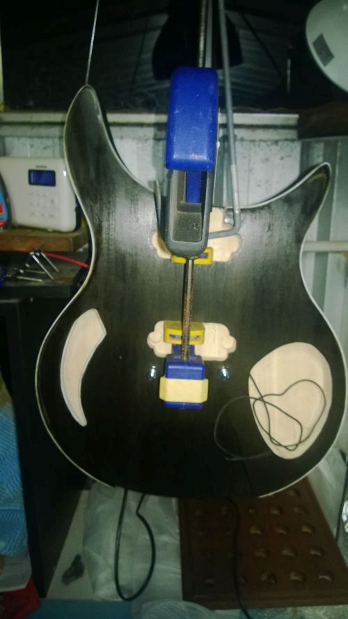

Best measurements I can get - saddles all the way forward but bridge posts not all the way in... No nut at the moment - haven't got that far...
By "all the way forward" i am assuming you mean they are wound to be as close to the pickup as possible?
Quote:
Neck all the way back
Low E - Nut to 12: 312mm, 12 - Saddle: 317.5mm
High E - Nut to 12: 313mm, 12 - Saddle: 313.5mm
Are your frets at 90 degrees to your fretboard!!!??? The nut to the 12th should be 313mm for all strings. You probably have 1.5mm to 2mm to play with here. IOW, you could move the neck 2 mm away from being butted up against the body.
Quote:
Neck in place with 'bucker
Low E - Nut to 12: 312mm, 12 - Saddle: 322mm
High E - Nut to 12: 313mm, 12 - Saddle: 318mm
Ok, this is horrible.....
Quote:
Looks like I'm out by 4.5mm
Probably 3 mm.....
Quote:
Dumb newbie question - to get the bridge posts in - unscrew the bridge posts, use a block of wood to protect then gently tap in with a hammer to get them in?
you must have been watching me......
