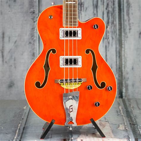

This gentlemanly G brand thinks orange is OK.
Attachment 45527
