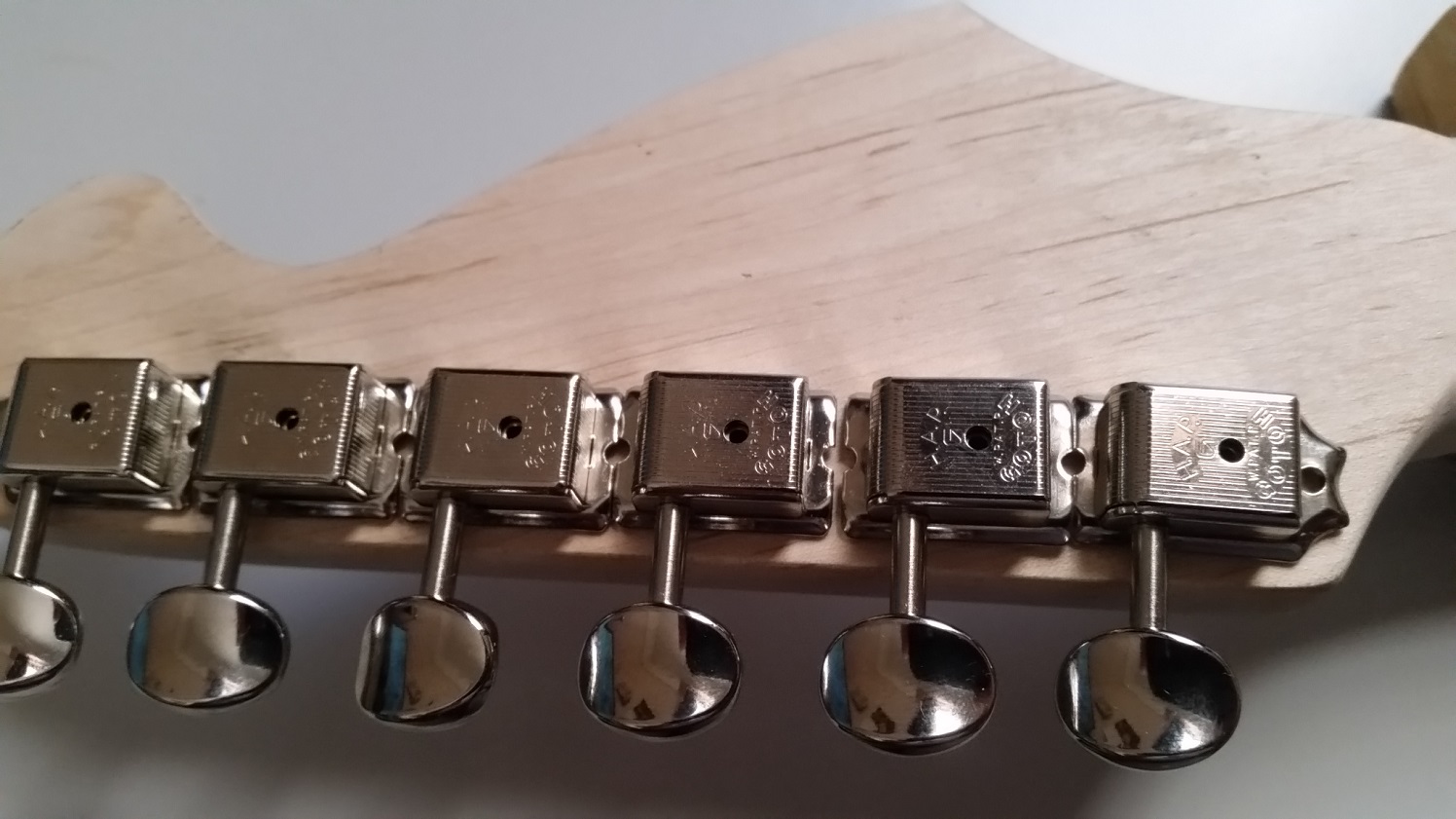

Meanwhile I am wondering what to do with this particular guitar? Since the body is likely to be light, I was wondering what the lightest tuners might be? What I read is that their used to be some very light tuners from Hipshot and Gotoh, but they have been discontinued. The lightest sealed tuners are likely to be the vintage style Kluson or Kluson clones. Does anyone have a favorite? I have a set of Gotoh SD 91's on a guitar, and I really like them. Easy to turn and stays in tune well. I see that Wilkinson makes them WD-55s? Not sure about the model numbers but, Kluson and Grover seem to make them as well. If I don't get advice to the contrary I'll probably go with the Gotohs or Wilkinsons since they seem to be decent quality and cost less. Any preferences?
