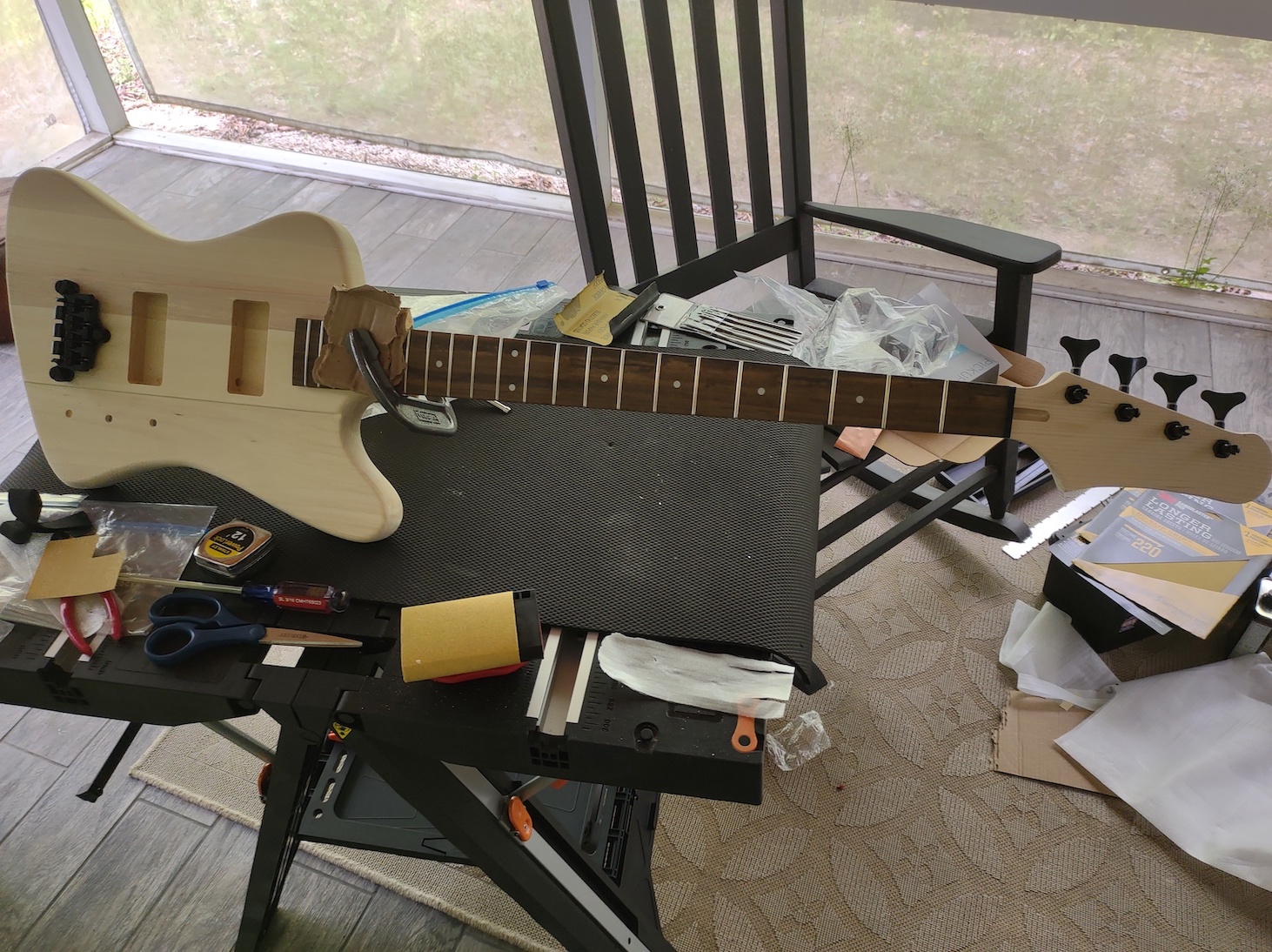

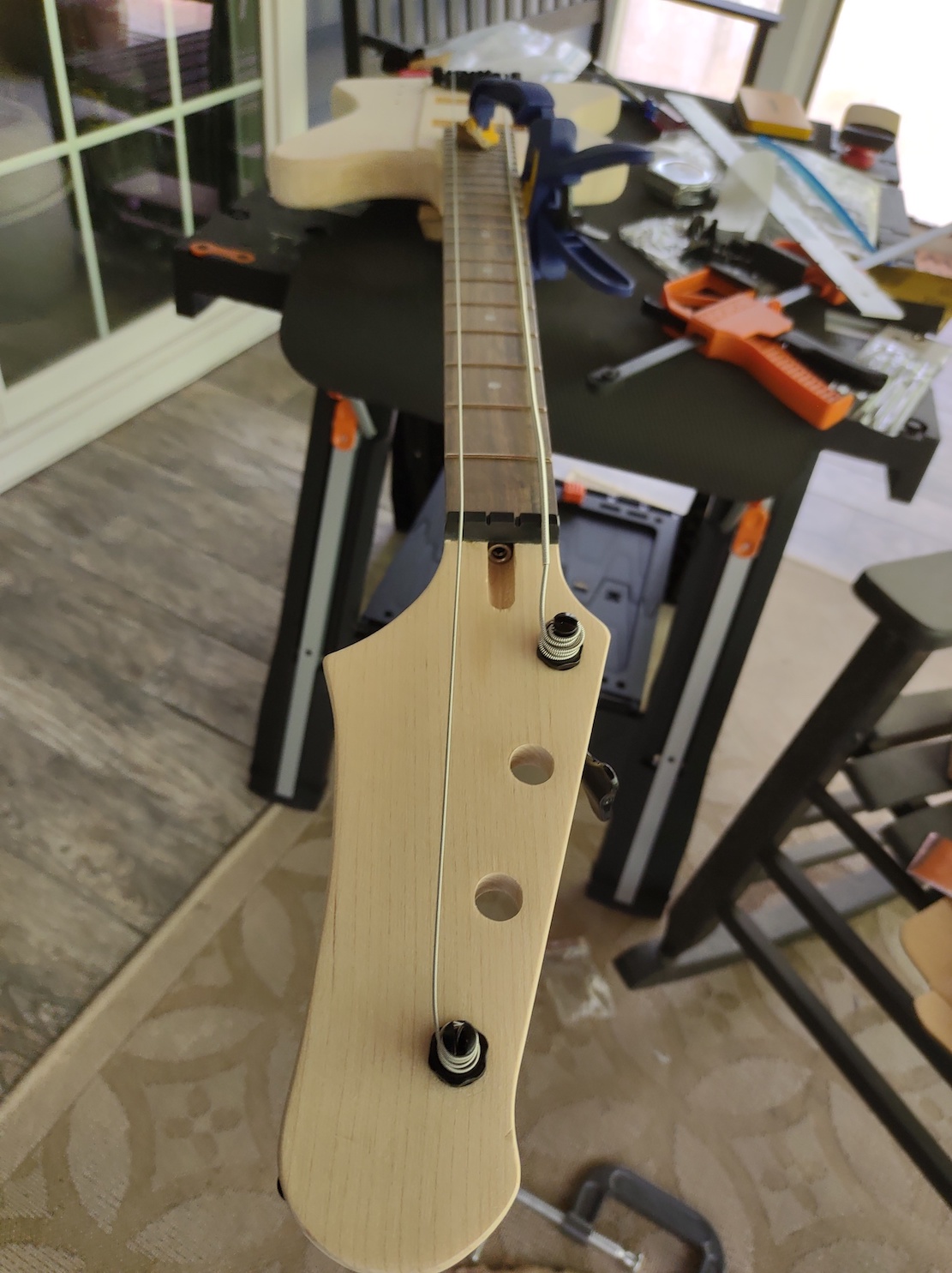

mock build
Attachment 44495
checking the alignment
It seemed like the action was going to be really high, and I've read complaints about the TB-4 bridges, so I got a replacement bridge from Hipshot. It barely makes a difference even with the saddles all the way down, so I may need a neck shim. No regrets though, it's a better bridge in other ways.

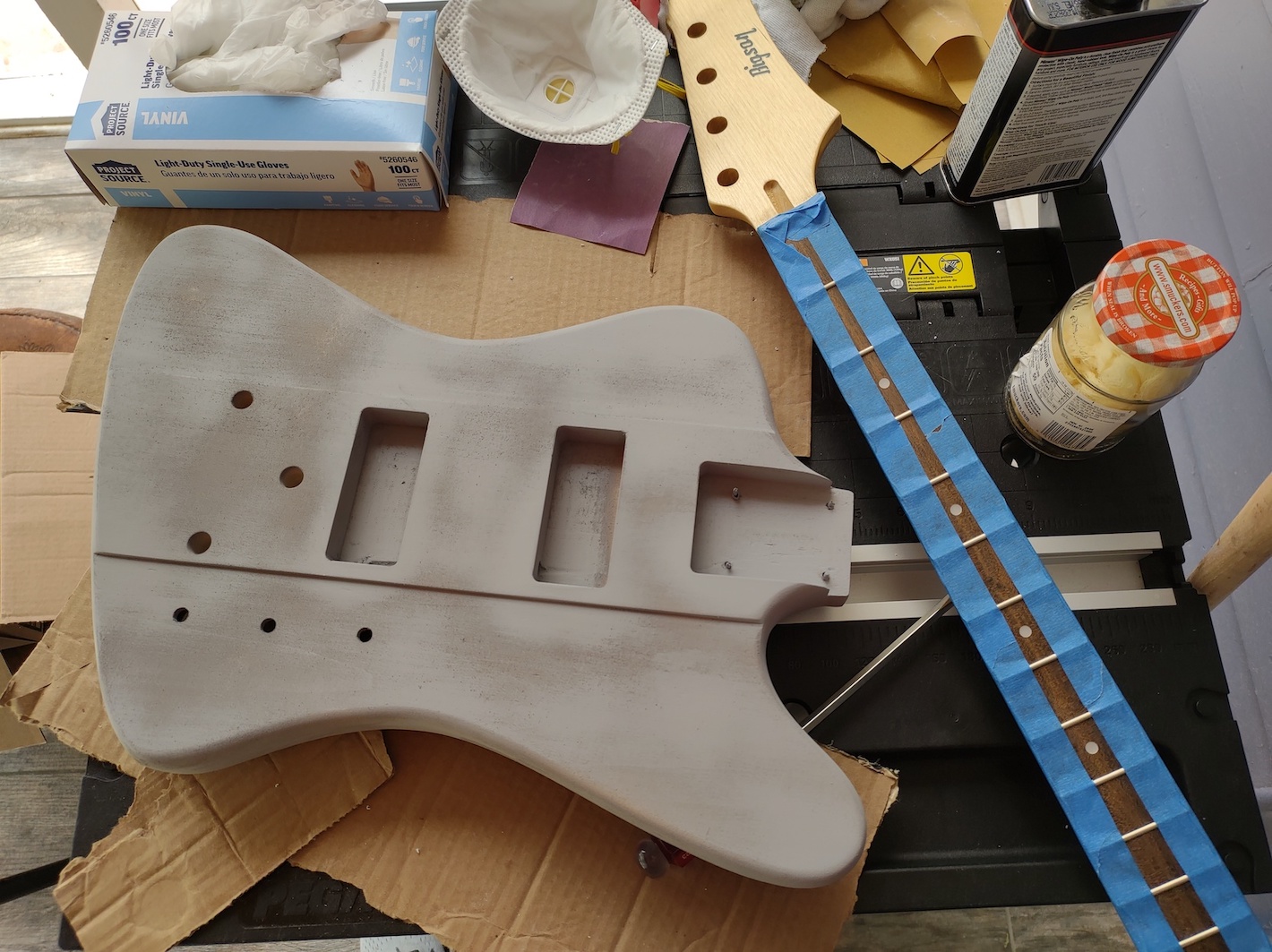

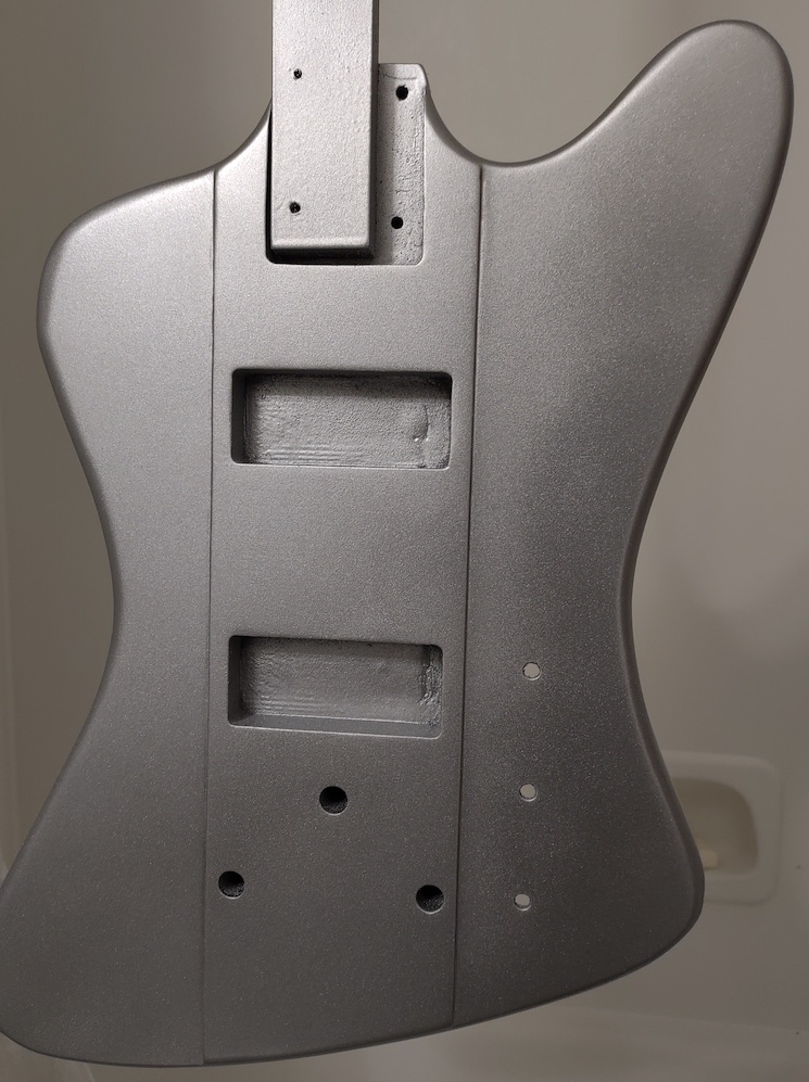

OK, now on to painting... To keep things simple I'm doing a solid color and using rattle cans. Primer, top coat, and clear coat are all Rustoleum enamel.
The body (it's basswood, so very soft) has a couple of very small dings that I wish I filled before I started painting. I thought they might be filled by the paint and primer, but that hasn't happened. They're not bad, most people may not even notice, but I see them. Lesson learned.
Attachment 44496
priming the body

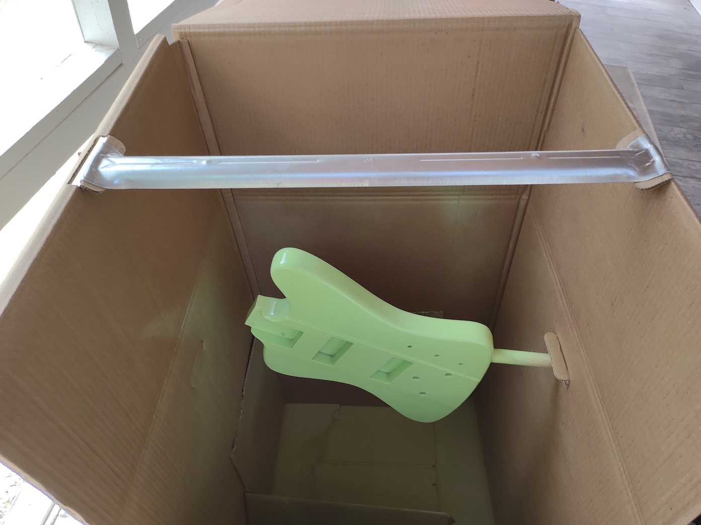

I came up with a solution a few days ago: I have a wardrobe moving box that I can use as a spray booth. It has a metal bar across the top meant for coat hangers. A body or neck can be hung from it. Also, there are handle holes in the sides which I can pass a dowel through, then mount the body on the dowel. The other end of the dowel is clamped to my work table. I can rotate it as needed.
Attachment 44497
wardrobe box spray booth
