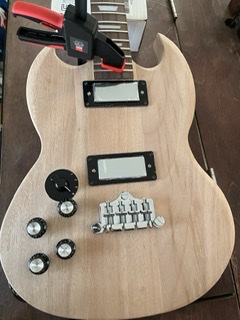

The scale length checks out but the neck was not an exact fit. The picture below is how it looks when clamped into place, do I need to sand the neck or the pocket in this case?
Attachment 42207
