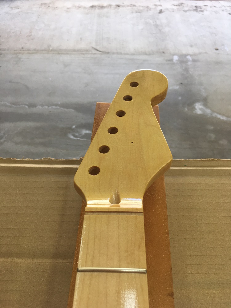

HEADSTOCK SHAPE: I'd love to cut a CBS-style headstock, but, judging from the images on the website, I just don't think there's enough wood in the paddle to pull it off. I might try to draw something inspired by it or just go with a regular Tele-style headstock, but, either way, there are no templates for seven-string Fendery headstocks on the web, I think...
