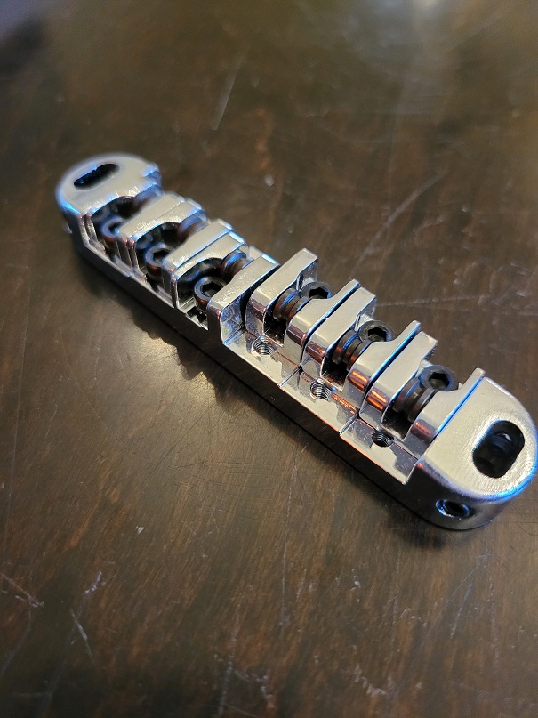

1 Attachment(s)
Also thought of a couple of quick questions, how does everyone feel about the stock pickups and tuners? And I have this 'roller' bridge kicking around that I was thinking about using on this guitar. My understanding is that this type of bridge works well with guitars with detuners, but maybe it could negatively affect sustain? Any thoughts are welcome. Attachment 40821

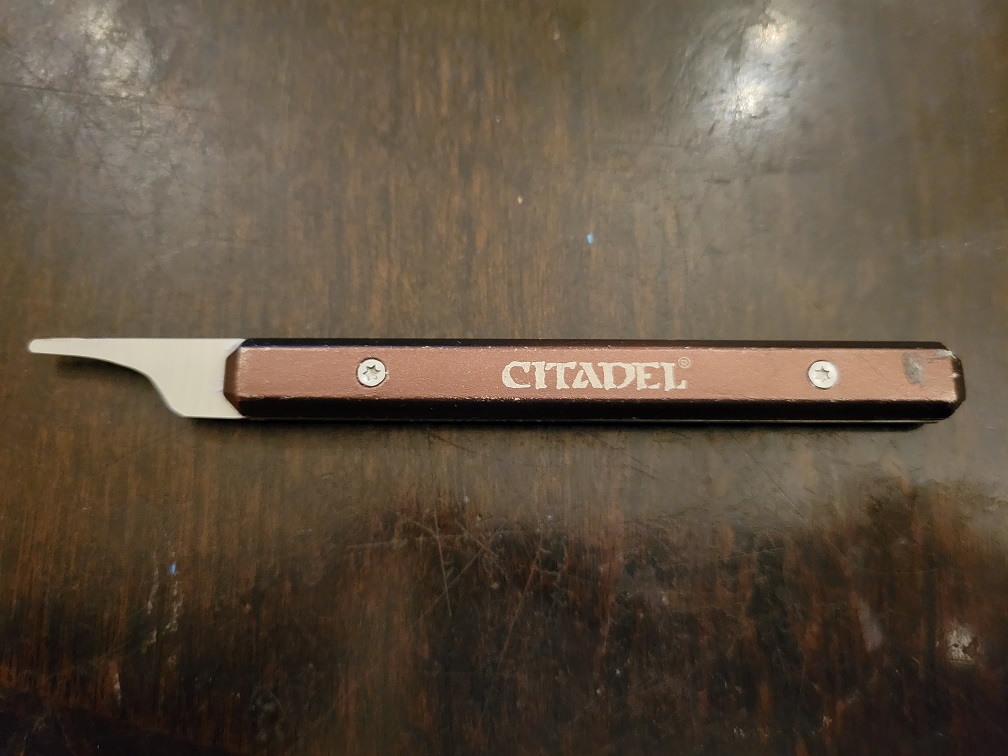

1 Attachment(s)
Attachment 40838 Not sure if anyone has any better suggestions, but I found that this sprue cleaner from a totally different hobby works amazingly well at cleaning wayward stain off of guitar binding.

For a guitar with a rear-mounting trem, I'd always suggest a roller bridge. You may possibly loose a little sustain, but not much. And as long as the rollers are lubricated from time to time and you make sure they don't seize up (which can happen), they can really help with tuning stability. I have a Gibson Flying V with a Maestro-style trem fitted and a roller bridge, and that stays in tune very well indeed. The Bigsby-style trem will reduce sustain to a far greater extent than a good roller bridge.
That sprue cleaner looks a good ready-made tool for binding scraping. I've made my own from a craft-knife blade and some broom handle, but I'll certainly try one of those next time.
Hi Simon, thanks for the input, looking at those Tonerider pickups right now. And also thanks for your thoughts on the roller bridge and tuners, I will push forward using both the stock tuners and upgraded roller bridge.
