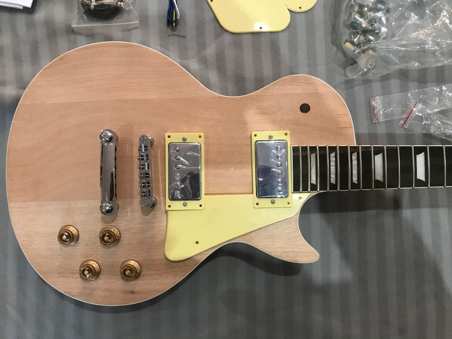

My latest build has arrived, and it's an SSCM-1E - mahogany body, ebony board. Everything looks OK going by a quick mock build.

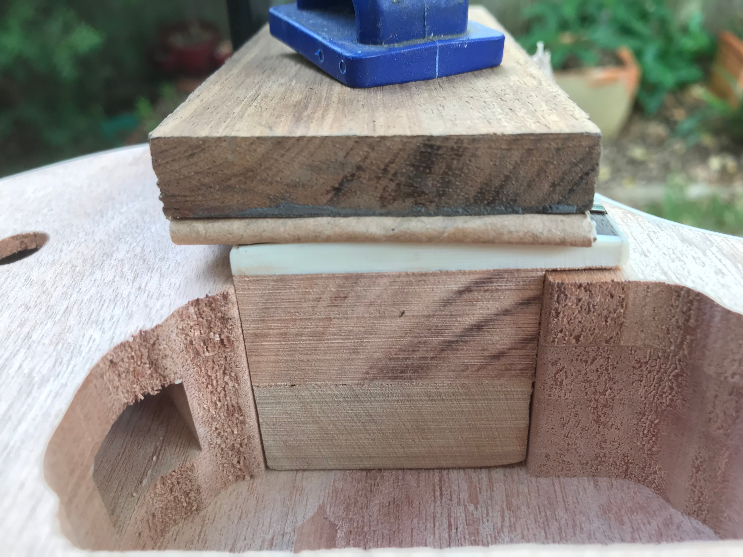

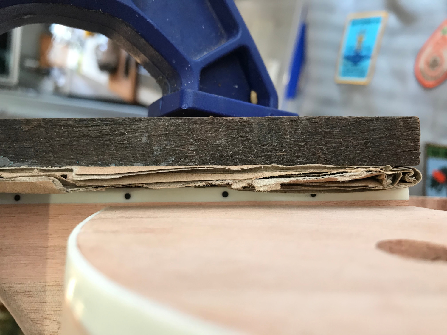

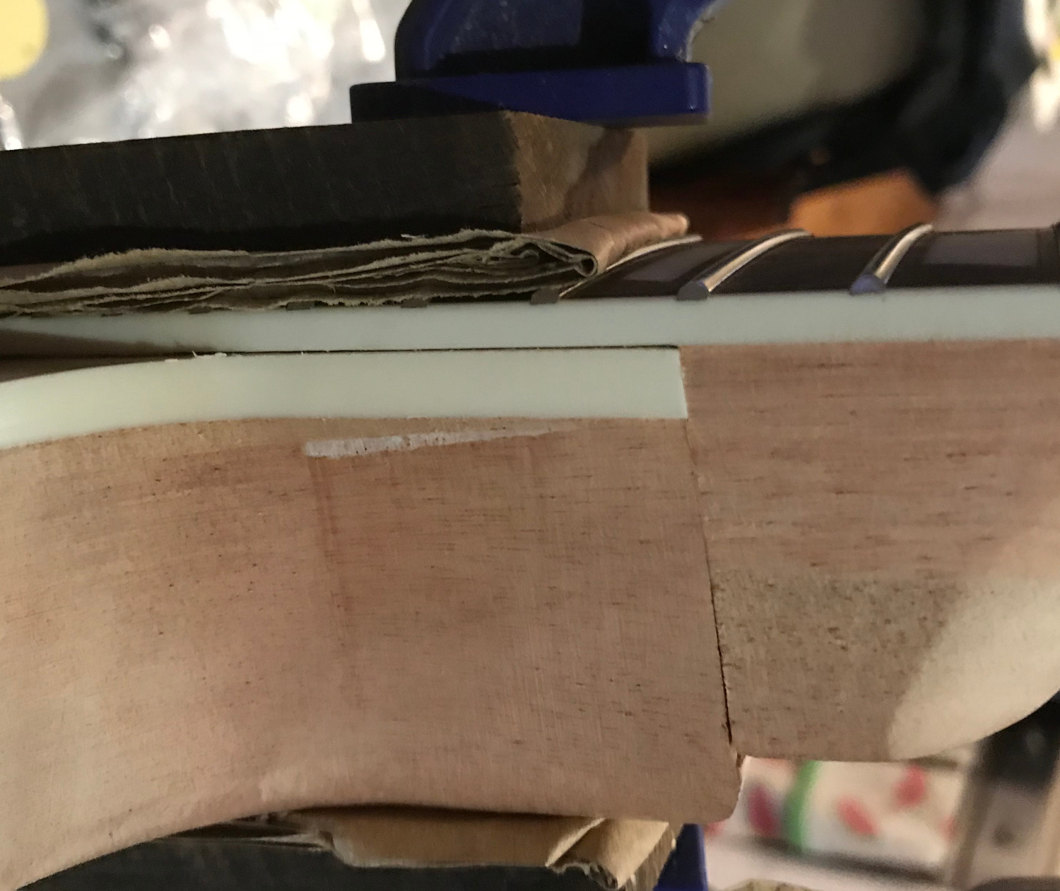

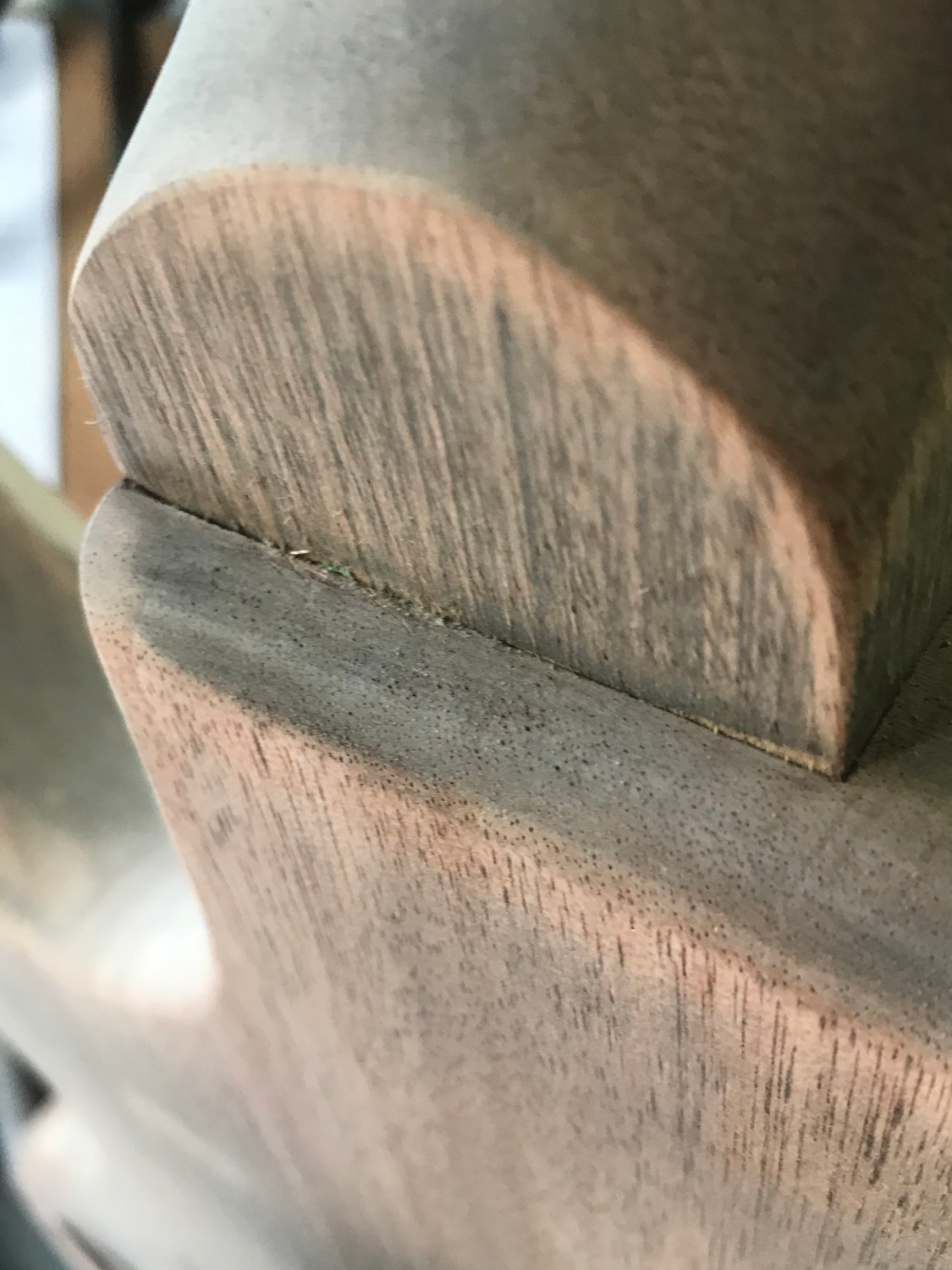

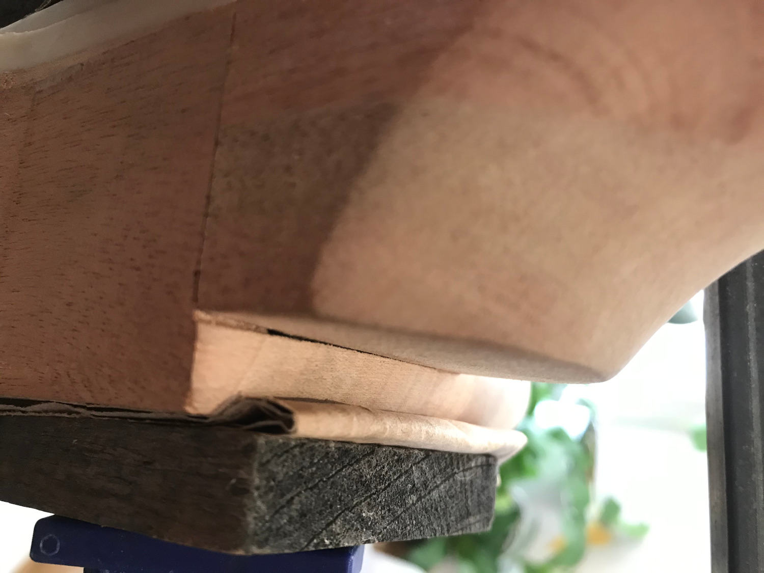

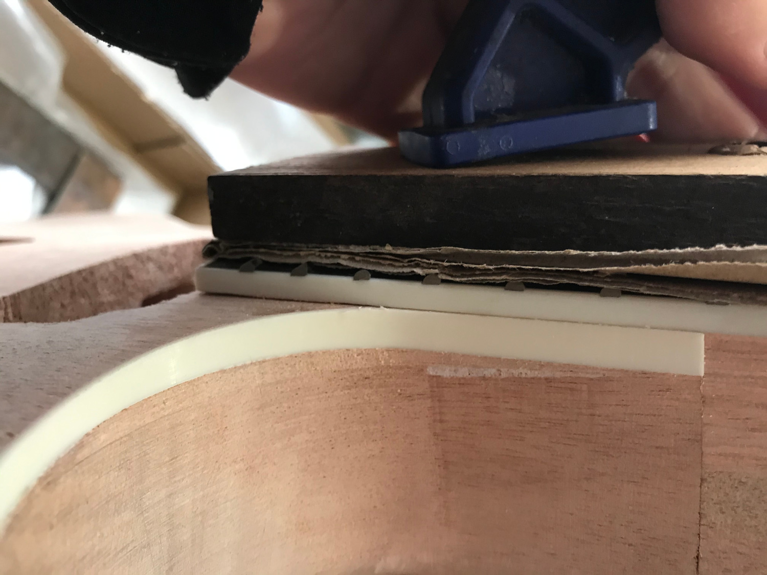

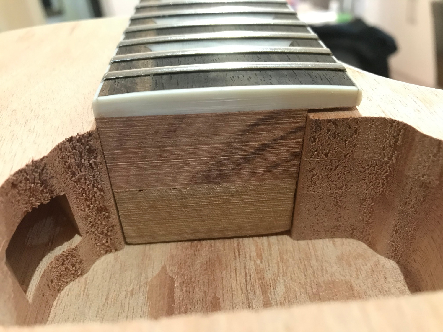

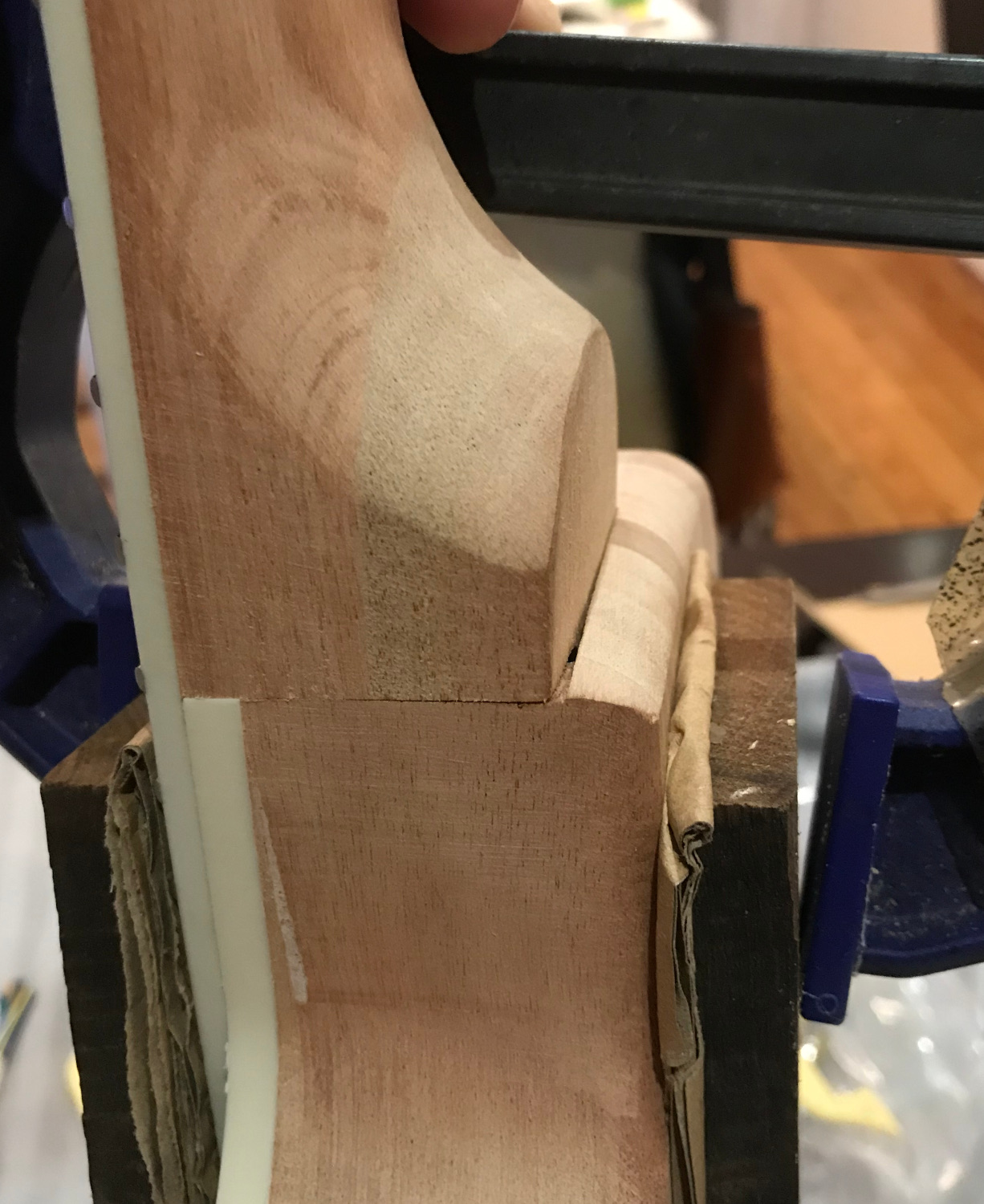

I would appreciate some advice on the neck. It's a snug fit, but I'm not sure that it's seating into the pocket properly, i.e. I'm not sure there's a lot of contact between the heel and the floor of the pocket. Here are a few photos. Even when clamped quite firmly, there's a gap between the neck and the pocket, and a slight gap between the board and the top of the body. How would you tackle it?
Attachment 40320 Attachment 40321 Attachment 40322
