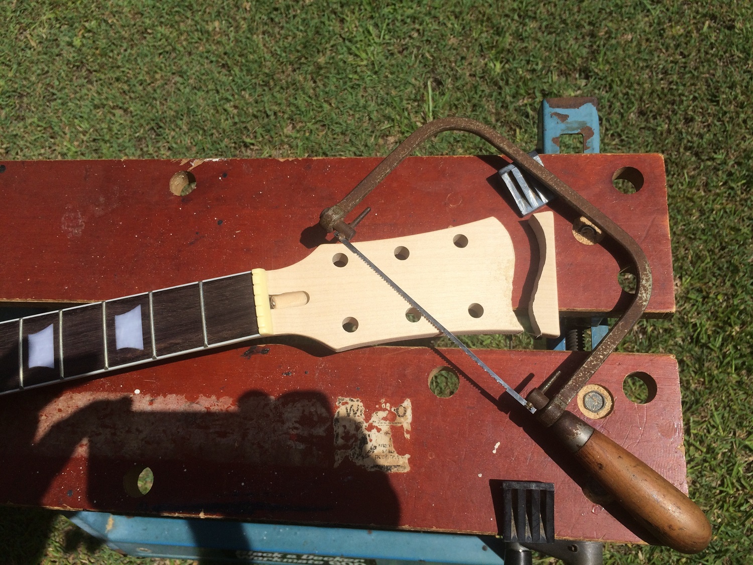

First job shape the headstock. I avoid using propriety shaped headstocks so have decided on something simple. So out with the trusty/rusty fret saw.
Attachment 39091

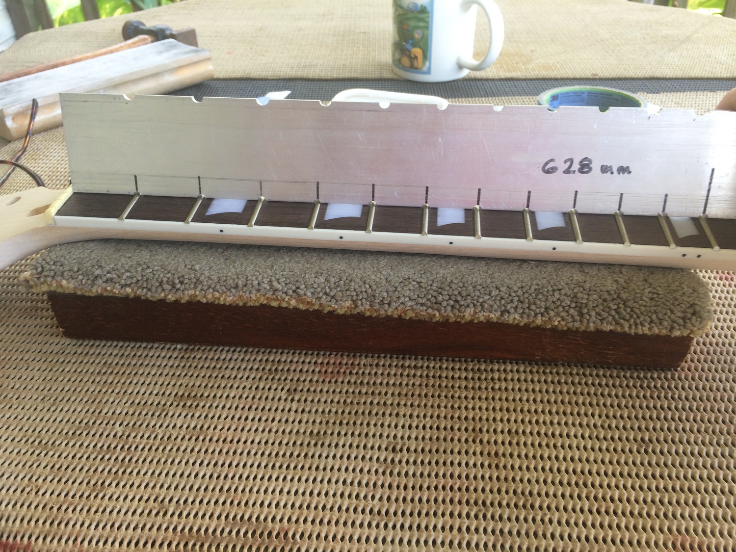

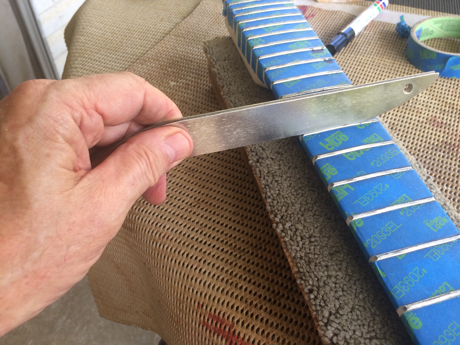

Then I used my DIY notched straight edge and adjusted the truss rod.
Attachment 39092

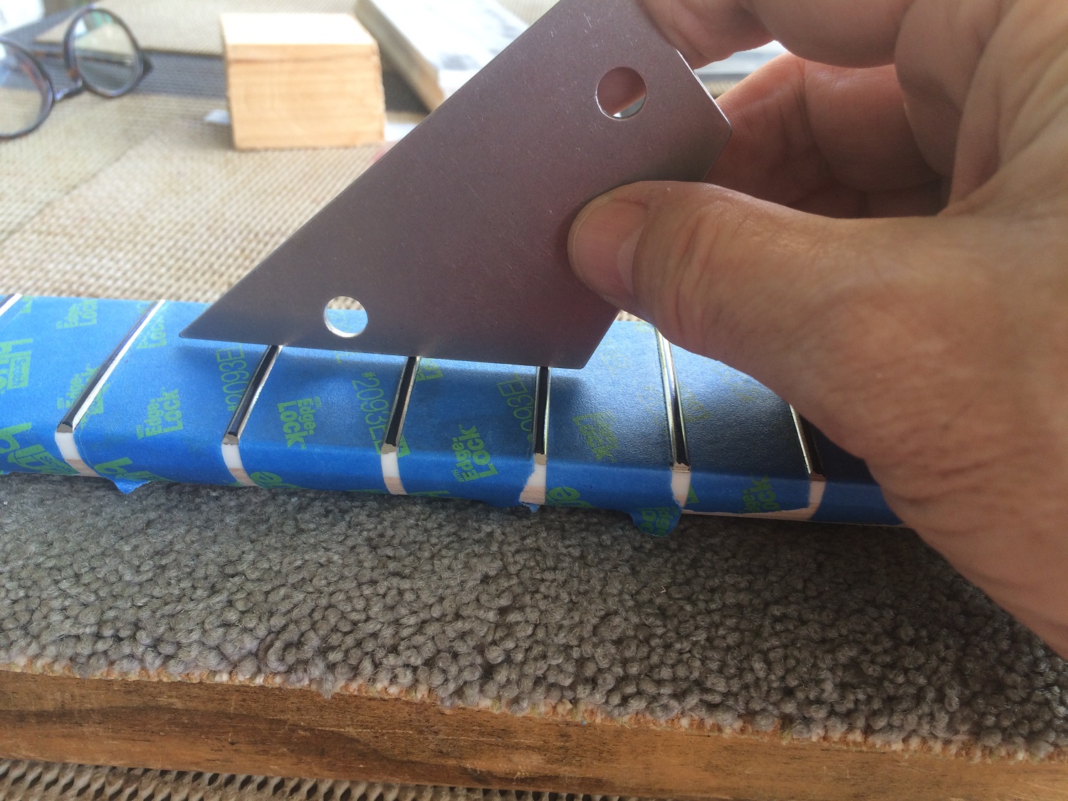

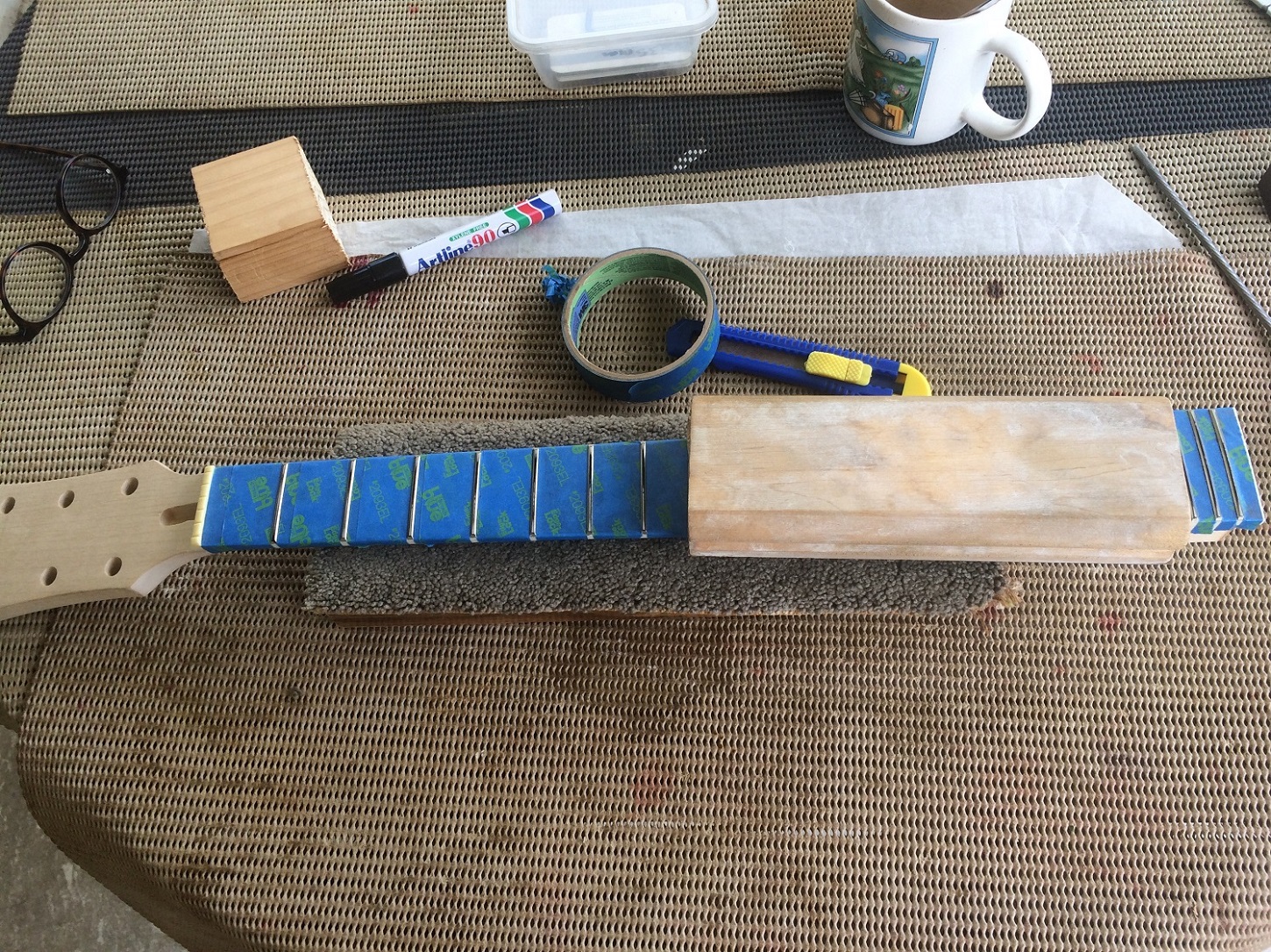

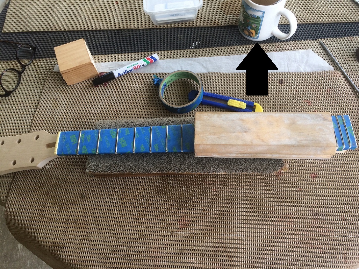

I make sure the all frets are seated properly, tape off the neck, and level the frets using a 12” radius block.
Attachment 39093
