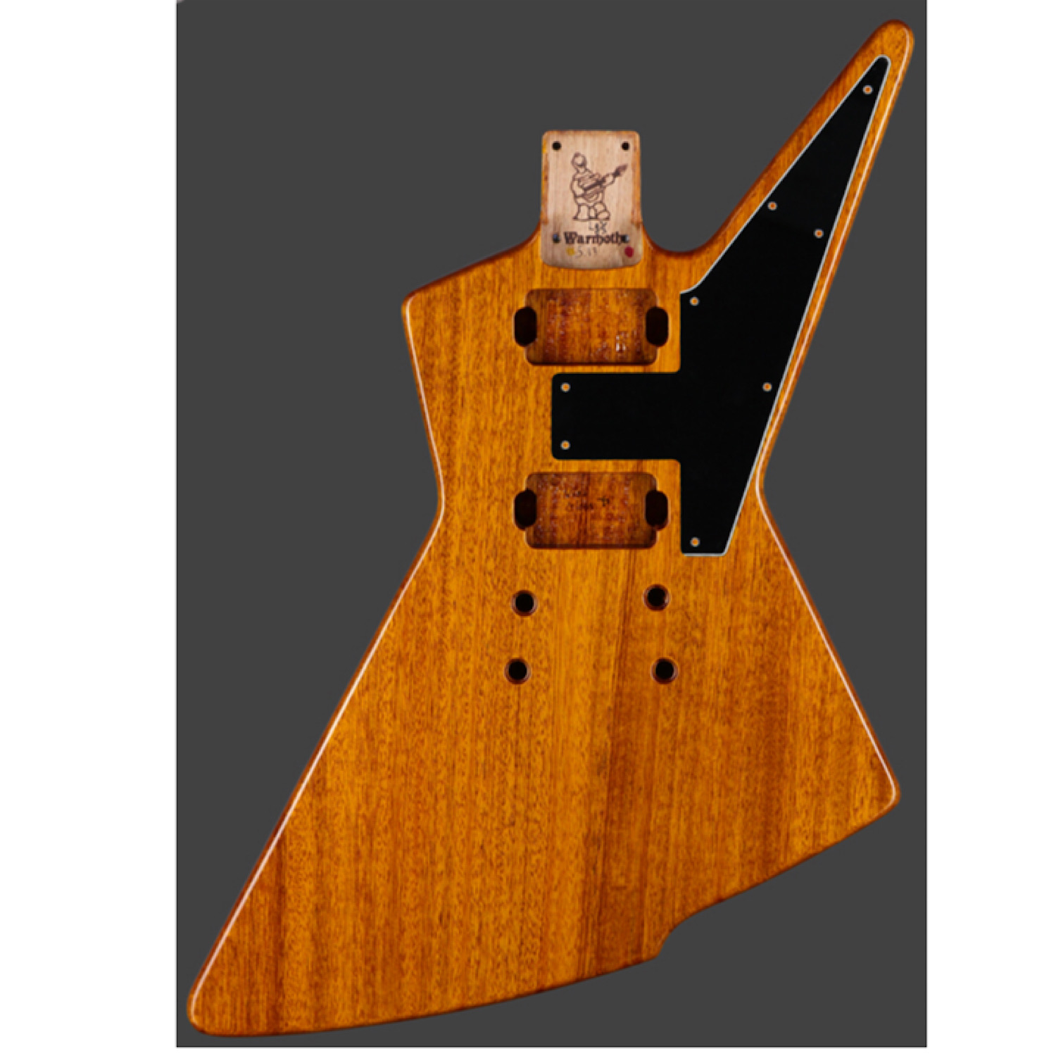

No second thoughts. For full 24 fret access, you could even take more off. You’re building the guitar I almost ordered about a year ago. I’ve been wrestling with how to cut the body for access as well.
It looks like the Warmoth Nomad body cut the horn for upper fret access and then cut an equal amount from the bottom to make it look balanced. I was going to do something like that.
Attachment 36557

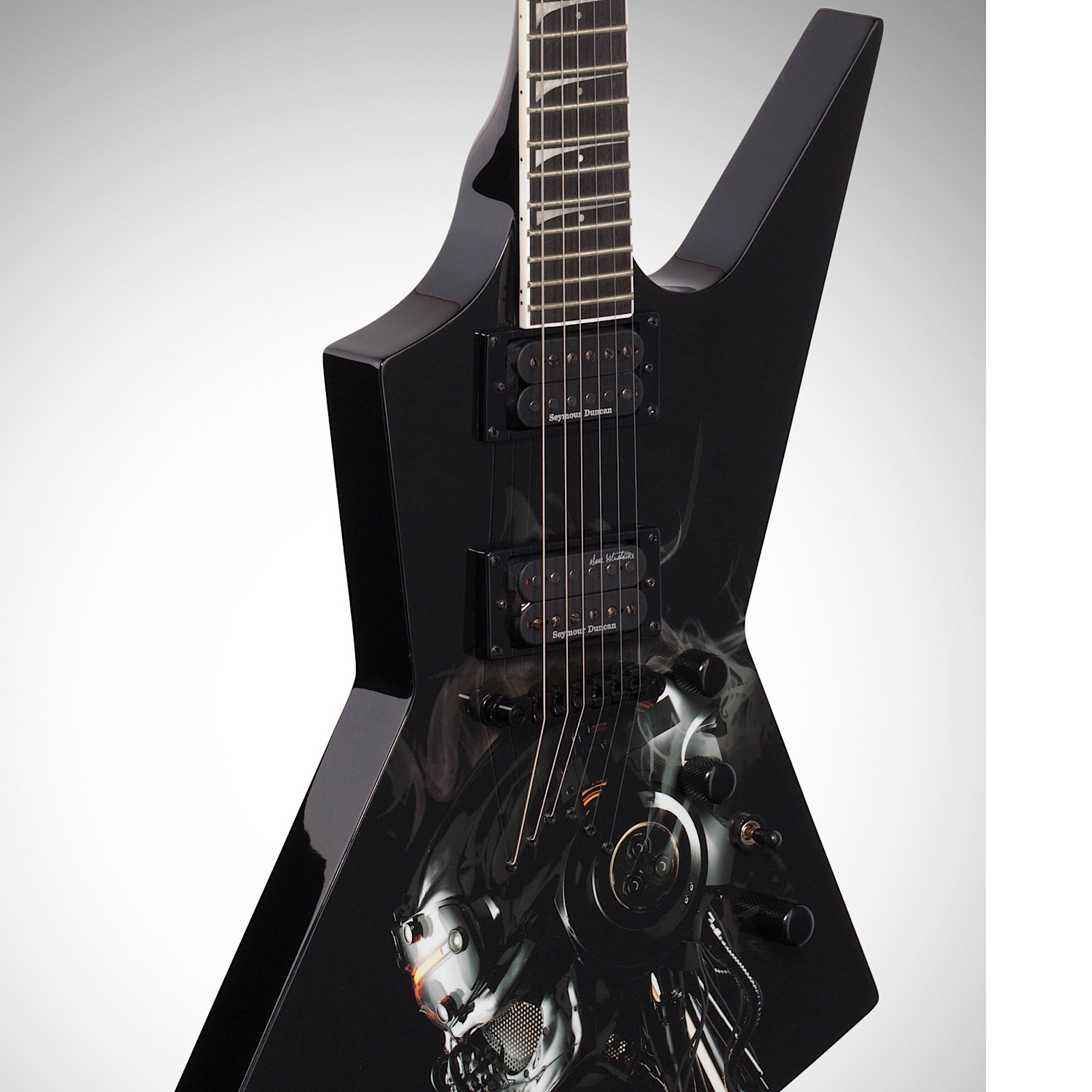

Another idea was the 24 fret explorer type Dean Dave Mustaine Vic Rattlehead Guitar. That one looks like it’s got 24 fret access and is shaped well.
Attachment 36558

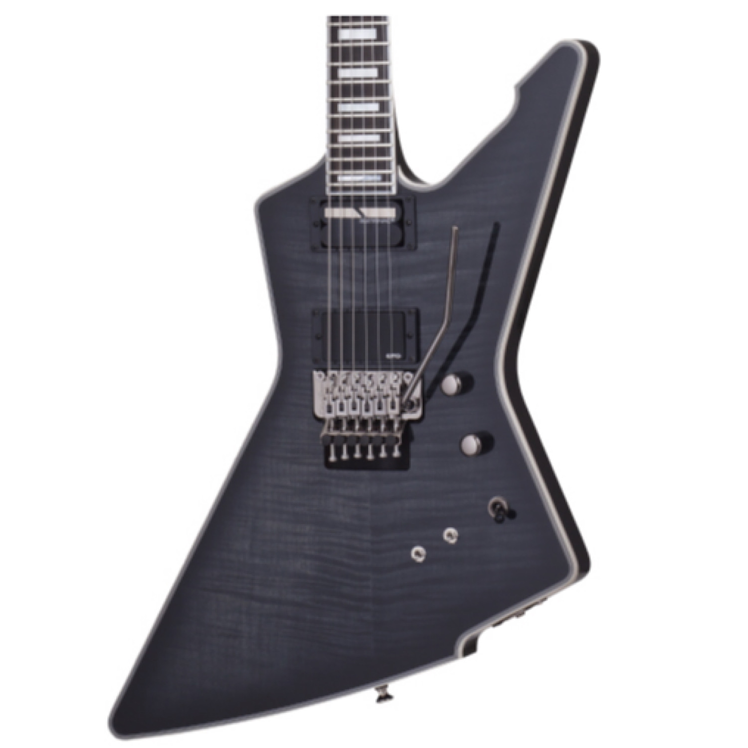

Also, you could cut out even more like Schecter did. They also cut an equal amount from the bottom for aesthetics.
https://guitar-compare.com/wp-conten...rets_Guide.png
Attachment 36566
