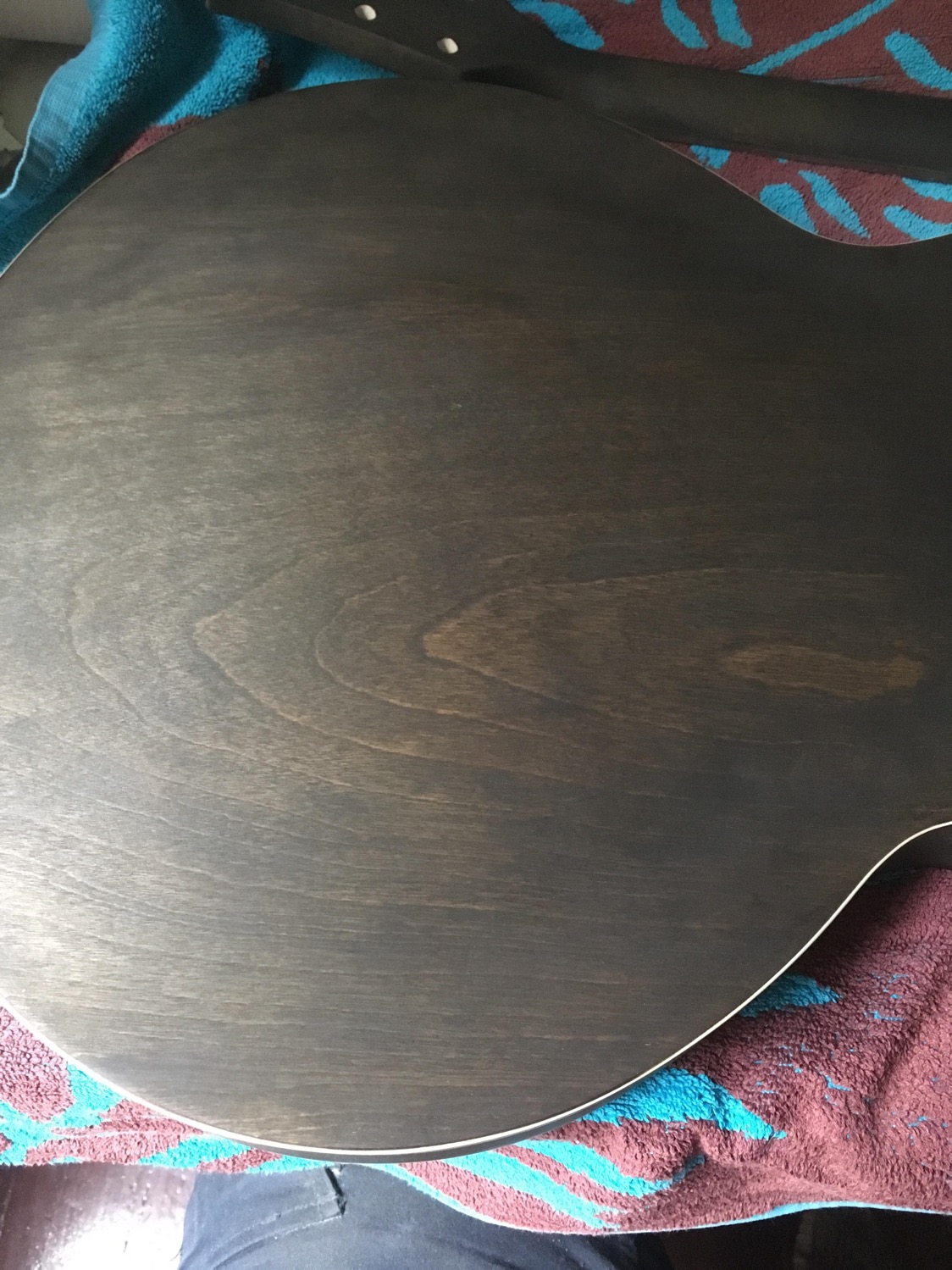

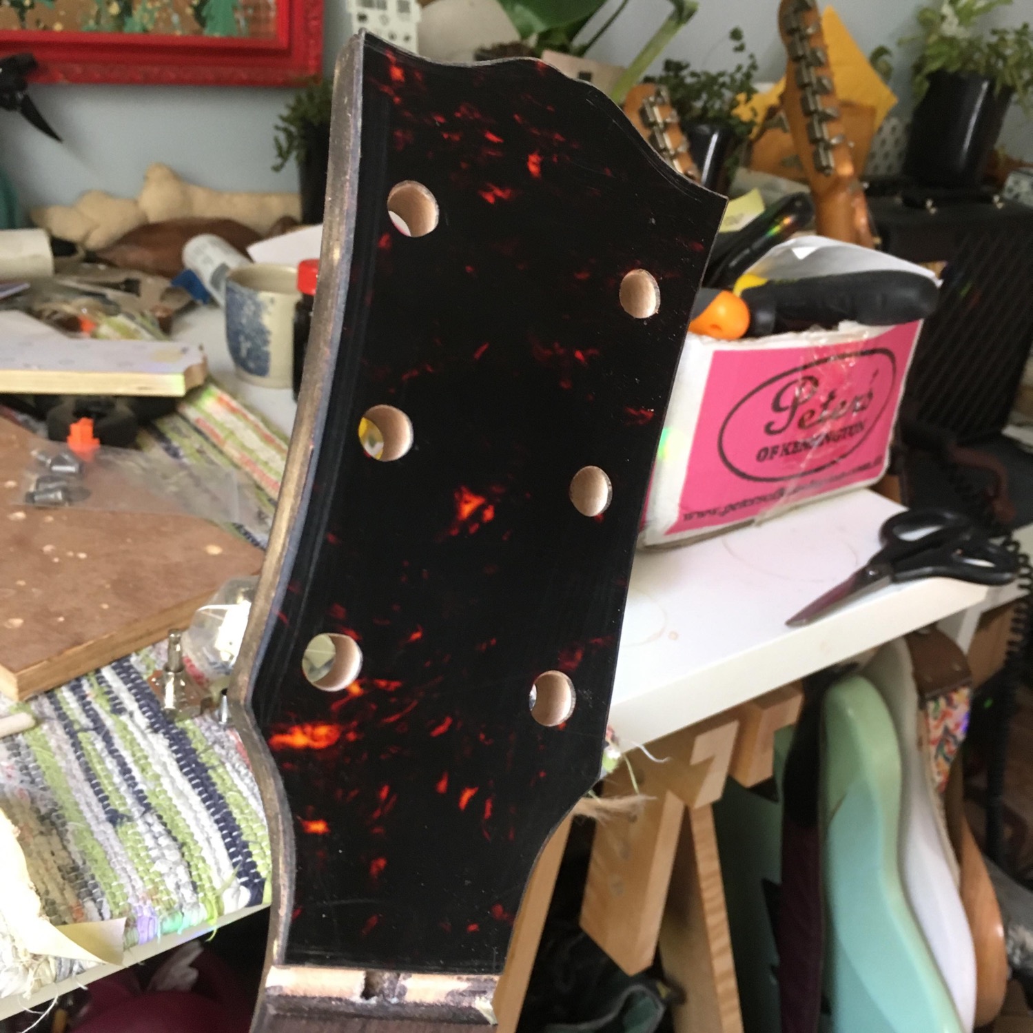

Was thinking classic red, but on reflection, I think it’s going to be stained black japan with golden teak underneath for some warmth. Tru Oil finish again.

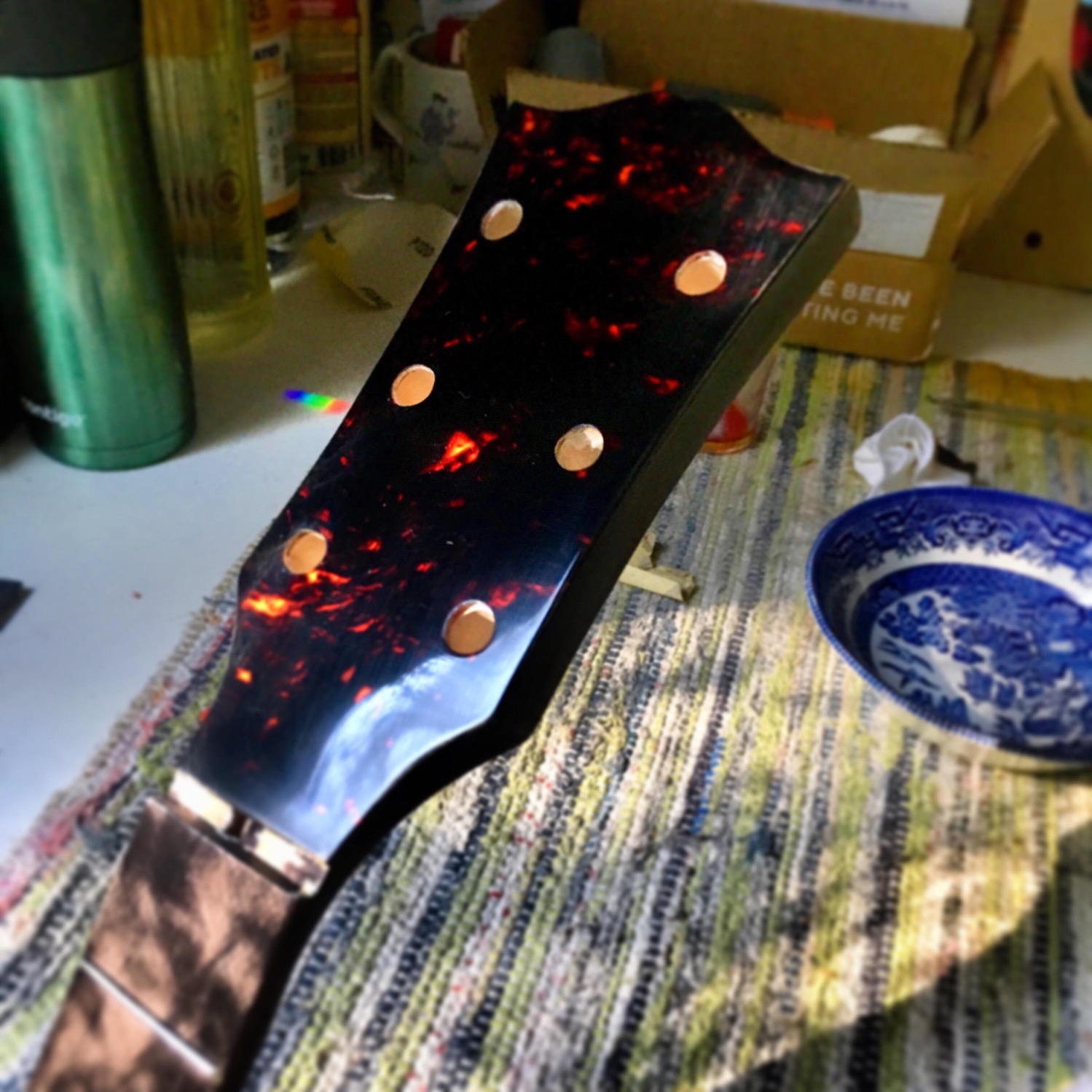

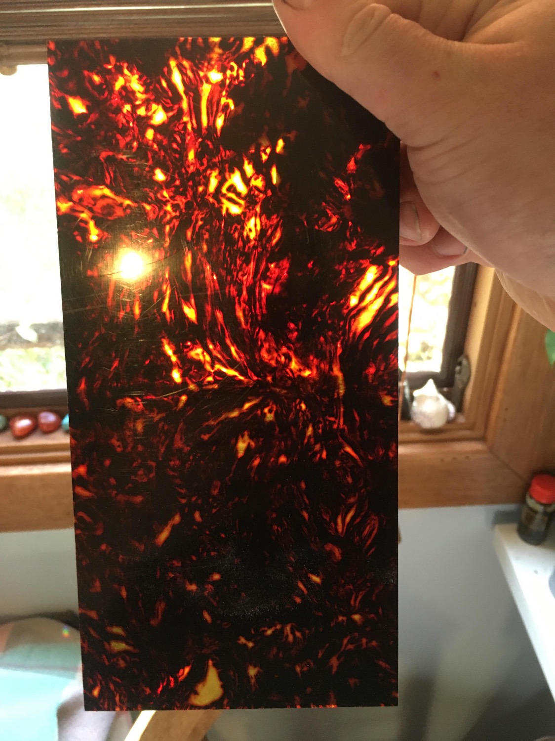

Going to make a headstock veneer out of some brown tortoieshell celluloid, maybe a pickguard too.

1. Finishing.
Can’t bolt it up on a stick like a bolt on...don’t see anywhere I can really suspend it since I’m just working on my desk....feasible to stain and oil in a rotation?

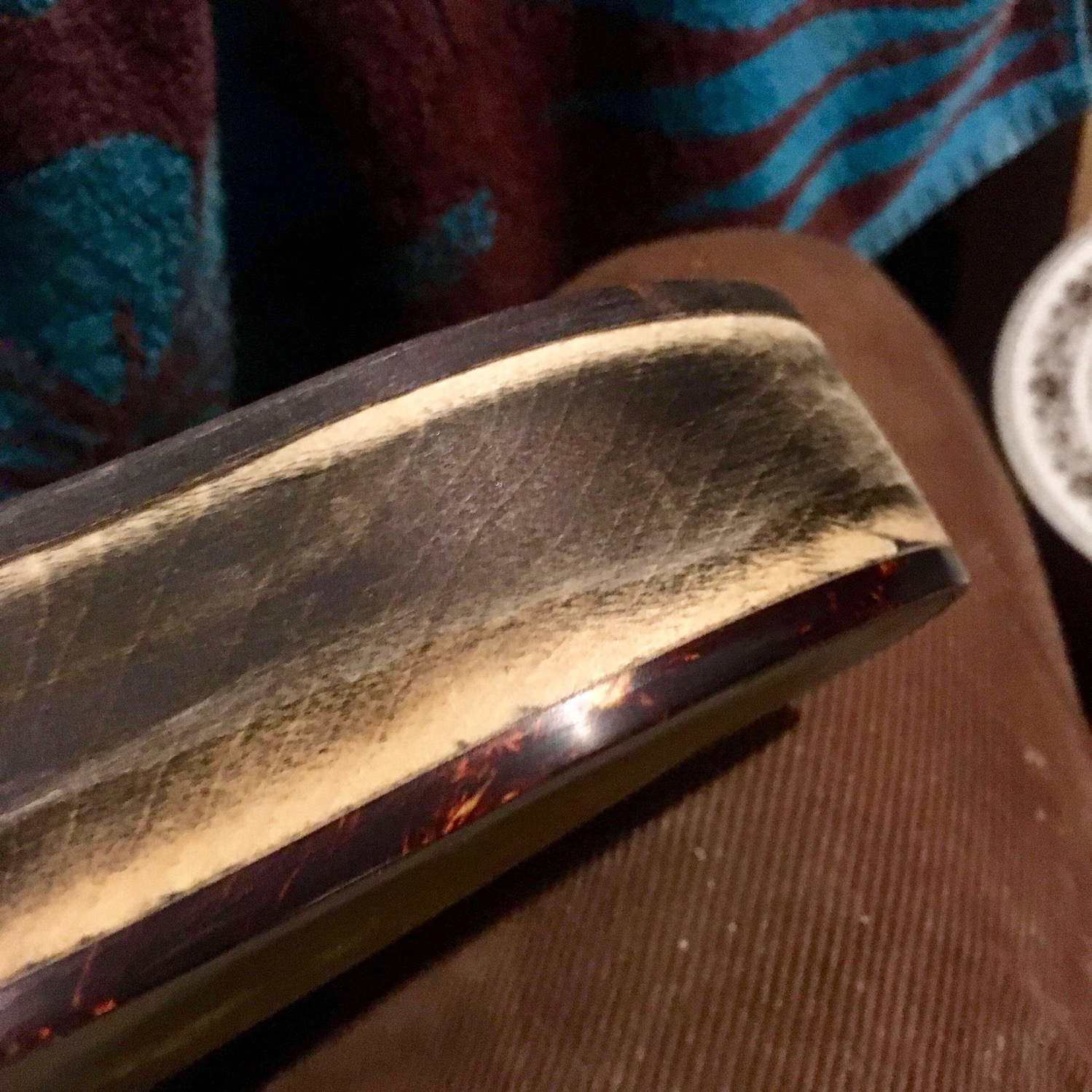

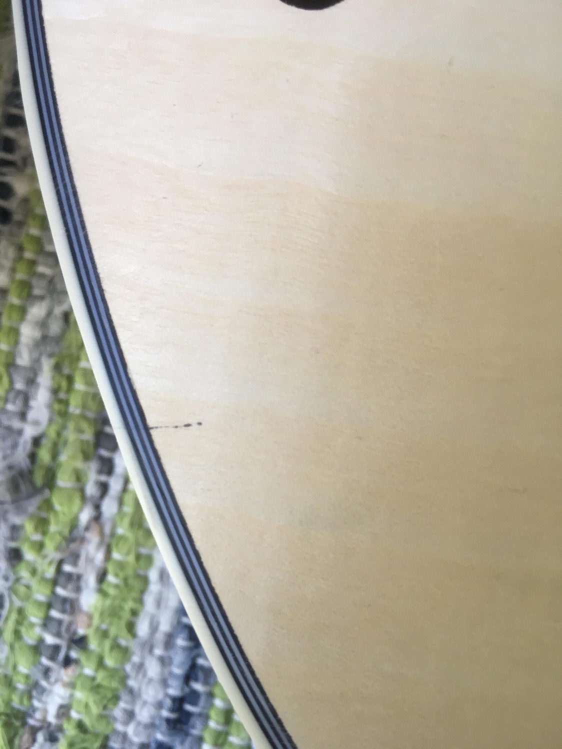

1.b glue and scratches on the veneer
The veneer looks a little beat up really, I think there are a few glue spots around too, not really sure. But even if I go through the veneer, the dark finish allows me some leeway so not too worried.

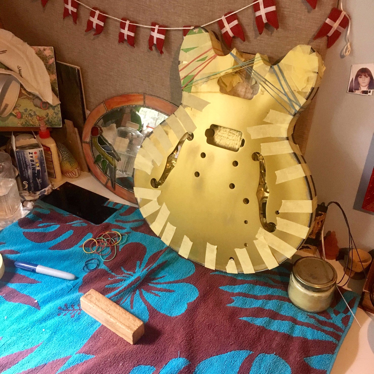

2. Setting the neck
Terrifying. Never done anything like it.

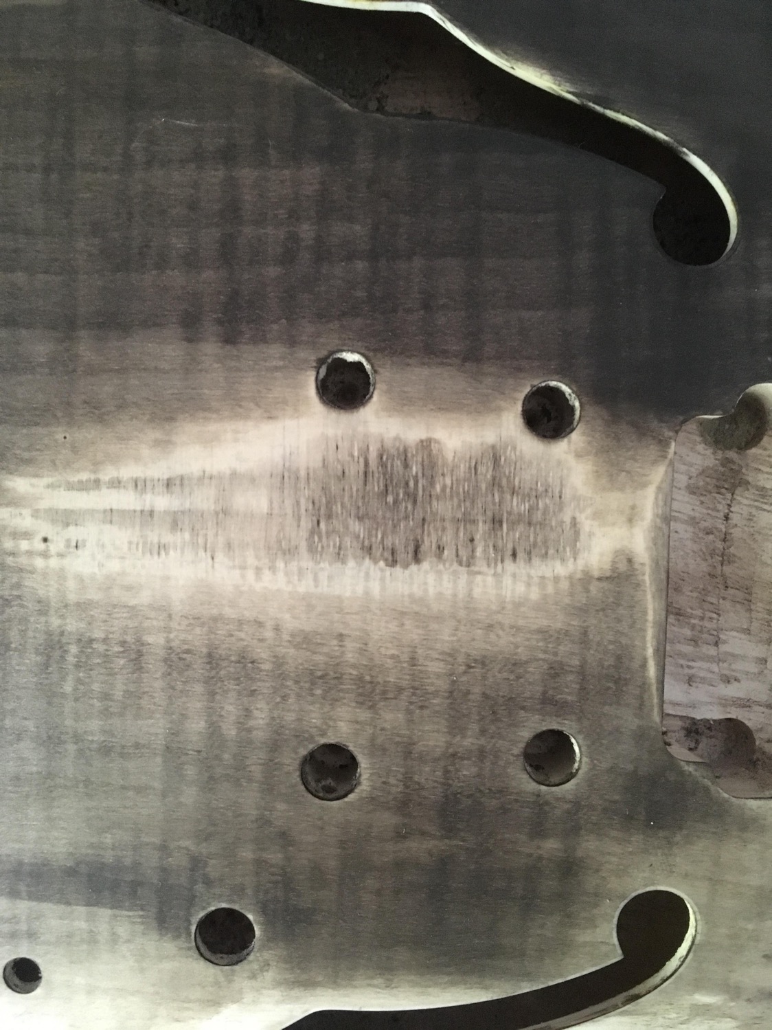

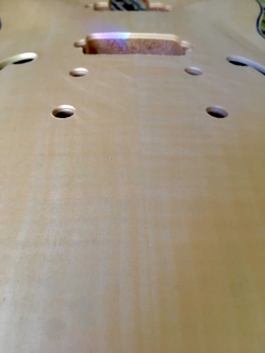

The kit is very handsome and after wiping with some turps the flame looks lovely, but its certainly rougher than the DCjr.
Attachment 35384
Attachment 35385
Attachment 35386

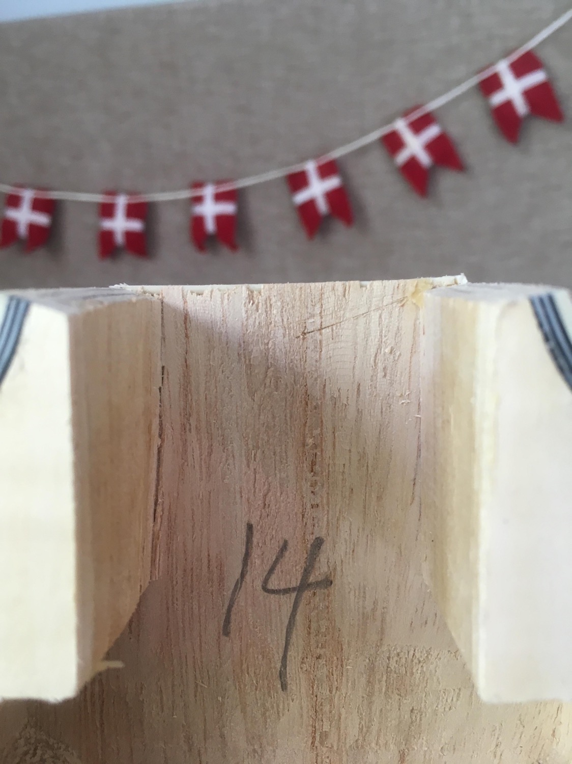

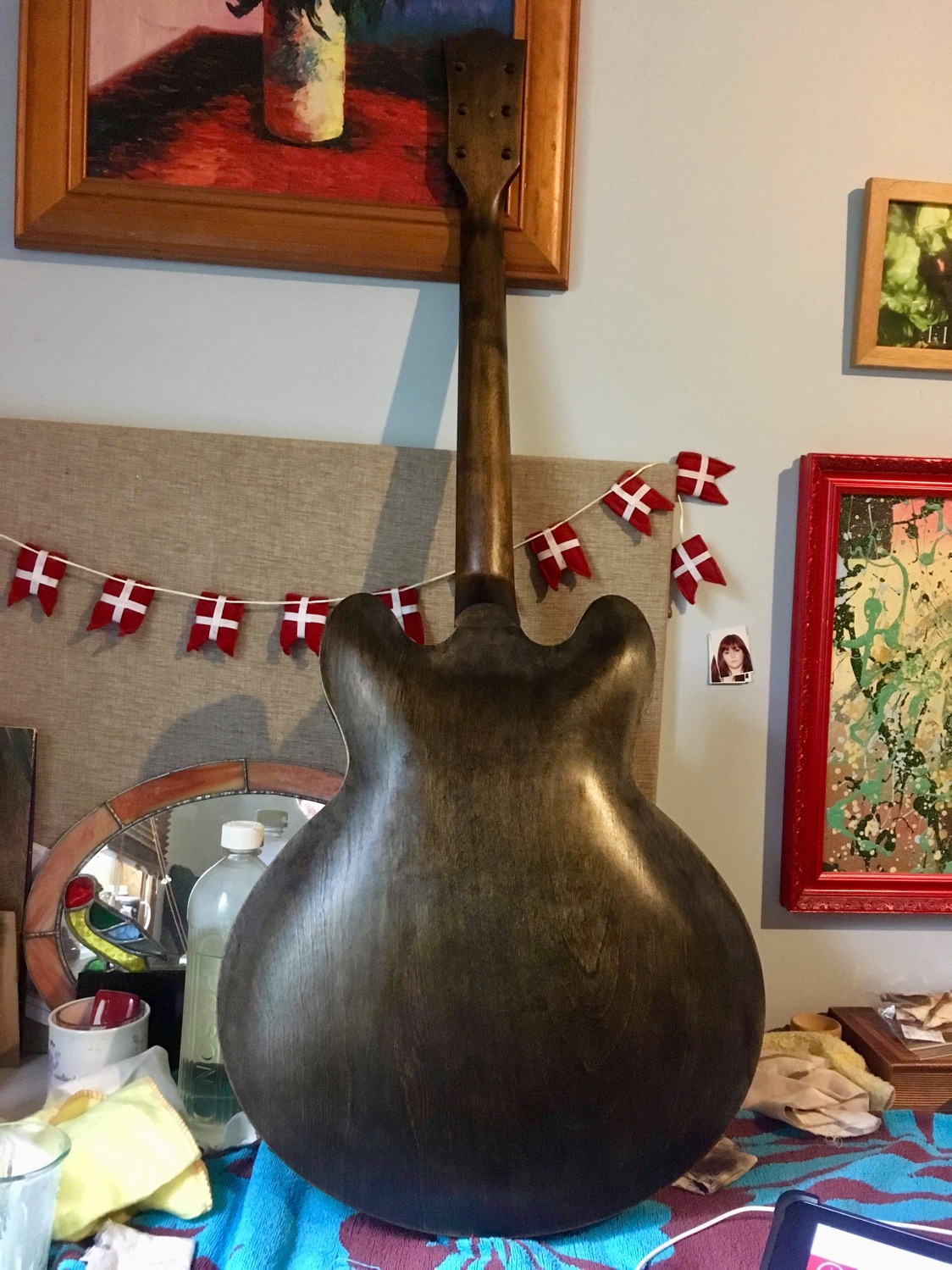

The neck seems to slot in pretty tight, looks pretty right to go...but before I start sanding...anyone see something I don’t? Is that neck pocket unevenness okay?
