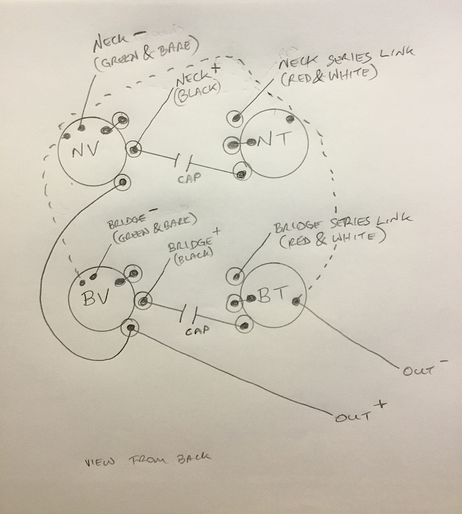

Pots in the control cavity issue.
Back at work again. Just before I left I put the updated wiring harness....thanks weirdy for the drawing...into the body.
I plugged it in and man the noise out of it was amazing.
I am not certain whether it is the barrel shapped jack socket.....or that the pots are really tiny and they may be bottoming out onto my carefully applied copper tape.
I had put one nylon washer on each pot...and the thread made it through the guitar top and the nut and washer locked the pots in place.
Maybe I will pull the wiring out and try it on the bench and see if it is much quieter.
I also noted that the pickups really don't go down that far into the pickup routing holes. Maybe I will have to get the green shed version of the a dremel out and ream out a track down the side of both pickup routing holes and see if I can encourage the wiring to stay in there.
I did try to fit the supplied capacitors into the new wiring diagram but I had trimmed them to suit the basic wiring diagram and the leads were too small. So I have broken the mould.....I have used two orange drop caps across the volume to tone pots.
Maybe I may have to grind out the control cavity to ensure that none of the connection lugs on the pots are anywhere near the copper tape......really just the two sections between each volume and tone pot recess.
