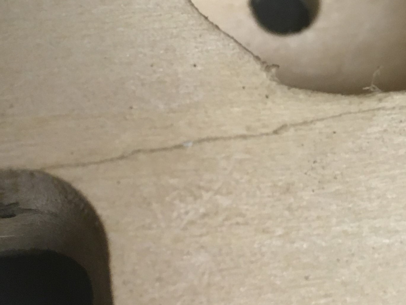

The top had a few marks in it, and Adam guided me to a very helpful you tube clip on how to steam small dings back to shape. I think it was pretty successful so far. Ill try to put a before and after pic in. There's also a bit of a 'crease' for want of a better term that i'm a little concerned about
So the original plan was to do the sides and back in an automotive candy style red, with a translucent red over the maple top, though some doubts are creeping in about the marks in the top. Can i fill them with timber mate and super carefully sand them smooth, then carry on? I know the veneer is incredibly thin, so any thoughts on how to make the grain pop? is it so thin that the traditional dark stain then sand back is no longer an option? ive heard of ebony timber mate being used, though im unfamiliar with the technique required. Ok thats probably way too many questions to start with. Over to the more knowledgable ones.....

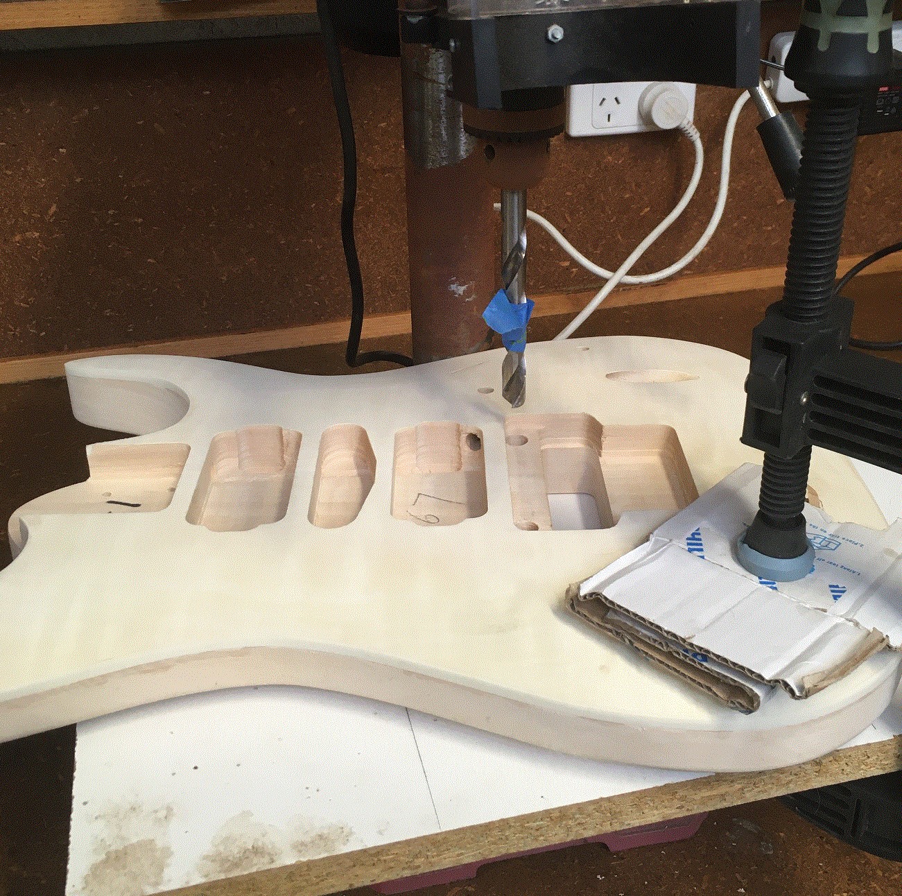

So I’ve been slowly piecing together the parts I want, to upgrade this build to level I think it deserves. Pickups on the way, upgraded switches and pots and a push pull for coil splitting.
I’ve been in two minds about the pretend Floyd Rose that came with the kit. I mean, they don’t even spell Rose right!https://uploads.tapatalk-cdn.com/202...9598ec350a.jpg
So I bought myself a Gotoh GE1996t locking trem. When it arrived I realised the posts are quite a bit larger than the kit ones, so to fit them it’ll require enlarging the holes in the body.
https://uploads.tapatalk-cdn.com/202...d704a1408a.jpg
https://uploads.tapatalk-cdn.com/202...2c68413fe9.jpg
My worry is that it going to leave the body a bit thin around the front of the hole. The new hole will only need to be enlarged around a mm. Has anyone tried this before? If it’s too risky I’ll use the kit bridge , but my new one is soooo pretty, I really want to use it. Maybe it’s destined for another project. Decisions decisions https://uploads.tapatalk-cdn.com/202...768b13a248.jpg

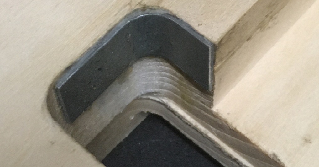

Mark I think the trem will hide it from the top and there’s a rear cover plate that should hide any sins so I’m hoping it’ll be ok. To be honest, If that’s the last mishap with this kit I’ll be pretty stoked. Still very much the beginner.
