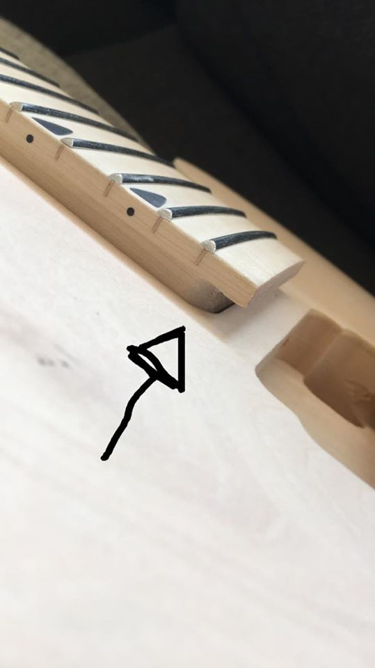

should i sand the corner bit of the body or the side of the heel of the neck?
The neck doesn’t come quite flush against the back of the neck hole. I’ve sanded the corners of the heel quite a bit cause it didn’t fit at all when I got it. The space is only a mm wide will this be alright?
Attachment 33076
No, round the corners more so the neck fits tight against the body. But just round the corners don't sand the rear mating edge or the bottom of the heel.
