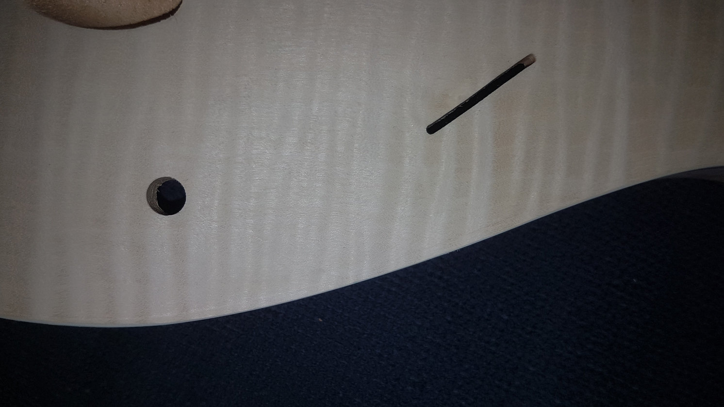

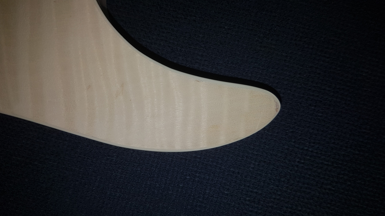

One of the main "Problems" i have is the inconsistency of the binding thickness. for around 75% of the guitar, the binding is perfect in thickness, but at the bottom part (the part you rest the guitar on your leg) the binding is only 0,1 - 0,2 mm thick. This makes it impossible to scrape the binding after staining.
What would you guys think would be a possible solution for this problem? i was thinking about routing out the binding and replacing it with a new one, only problem is that the body is carved both front and back, which makes it very hard to get a continuous depth with a routing tool. You guys have any idea to overcome this hurdle?
