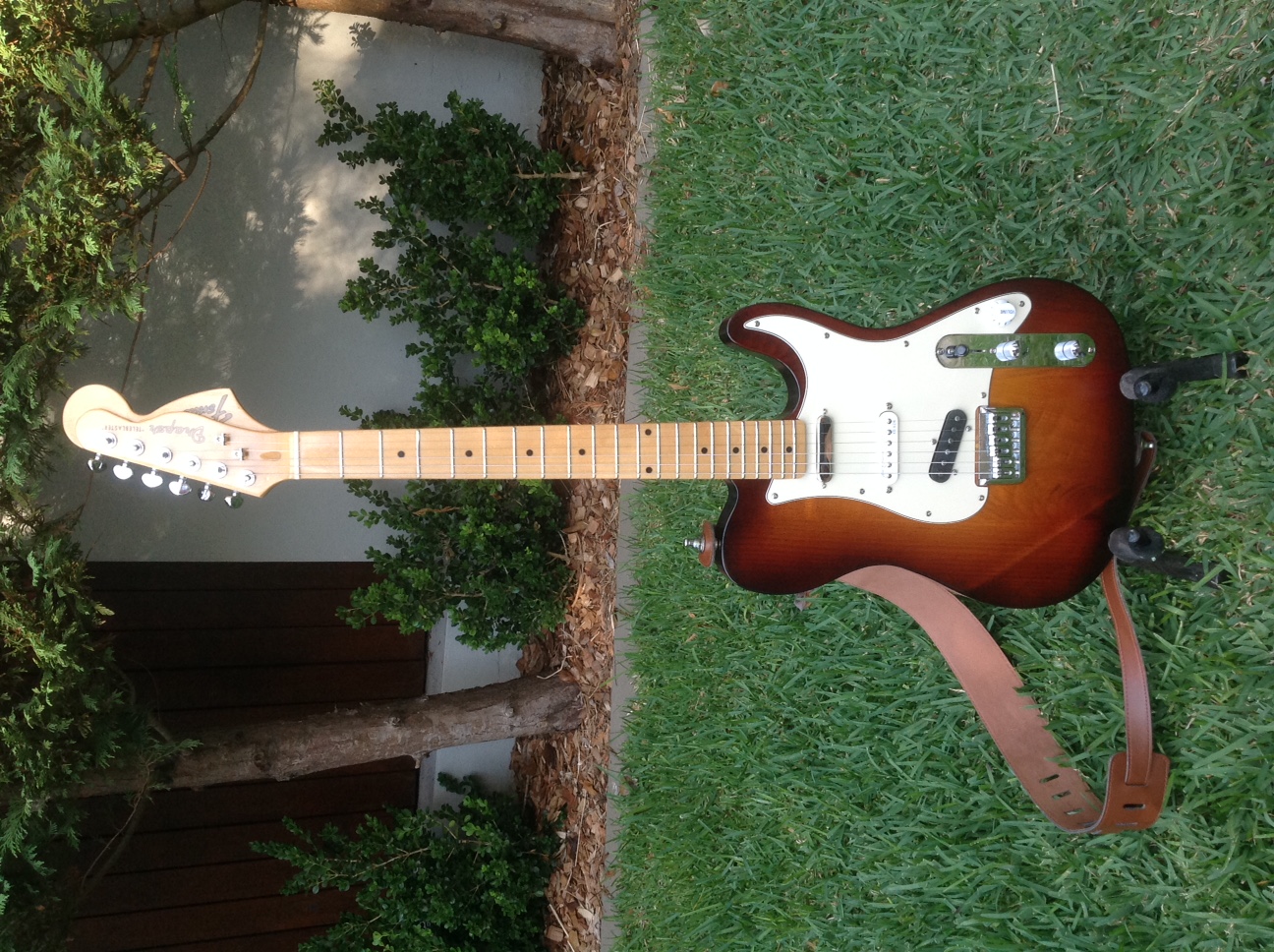

AndyXLH's TLA-1
Congratulations, this is perfectly equal parts Strat and Tele; it takes a minute to fully appreciate all the subtle nuances. The custom headstock is incredibly original and well executed. The string ferules are near perfect considering they were done by hand. The finish colour was an excellent choice and compliments the maple neck nicely.
Too clever by half! Well conceived and executed from top to bottom. I'd love to own this guitar.
A guitar having an identity crisis. The effort put in to this is remarkable. The headstock by itself is outstanding. Tons of planning and time are evident. Just amazing.
Very interesting take on 2 iconic shapes from the same maker all blended into one. Visually appealing from every angle and impressed with the attention to detail shown on the headstock. Cool demo video too.
I like the hybrid, but a few minor things that don’t do it for me – love the classic brown and off white pickguard, but would have loved to see the chrome and off white carried through the pickups and knobs.

And to the second top score:
Congratulations AndyXLH! Your hybrid is tres chiq and wonderfully executed.

Great job AndyXLH, such a clean machine.
