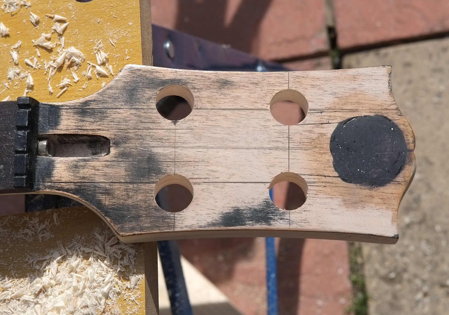

Not yet. I've now bought the materials to make up the basic jig to hold the body in and provide a flat surface for the router to sit on, but haven't put it together yet. I was working on the headstock yesterday as I needed to drill my own tuner holes. As the factory holes were normally a bit wonky, I asked for an undrilled headstock, which also let me choose the tuners I wanted without worrying about whether the standard holes were too big or small. The Hipshot tuners I ended up with require a 17mm hole, which is quite large.
However, after drilling small pilot holes I simply couldn't find the set of forstner bits I'd bought a couple of weeks ago (I was being forced to tidy up by the wife, mutter mutter). So I've had to order another set which should turn up later today. So at least I'm making some progress on it.
The new set of Forster bits turned up, so it was 'drill the headstock time'.
Attachment 26539
Attachment 26540

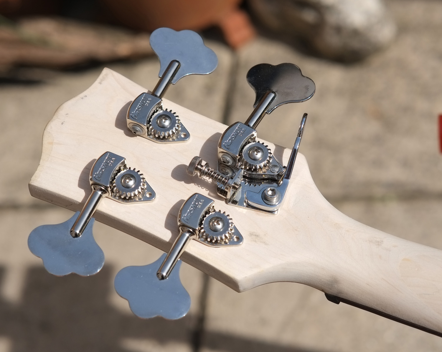

Then time for a test fitting of the machine heads.
Attachment 26541
Attachment 26542

What's the weird contraption on the E tuner? Is it a tuning dropper?
That's exactly what it is. I think Hipshot has its name from a detuner they made for Telecasters that was activated by the player's hip. They don't sell it any more, but one of their next big ideas was a thumb activated drop-D detuner for basses. They've been making them ever since ;-)

Yes, its a Hipshot Xtender. Flip the lever and it allows the tuner to rotate a set amount (adjustable) to drop down to an D (or whatever drop you want within reason). You can even get an extra lever for them to allow you to drop to one of two pre-set tunings. Of course the more you drop, the looser the string becomes, so you need to use fairly heavy strings so the E string doesn't get too floppy.
I'm making the bass for a friend, and I've been fitting these to all his basses. He first saw one when I got my used Lakland Bob Glaub (P-style) bass, and that had one fitted and was very taken by it.
