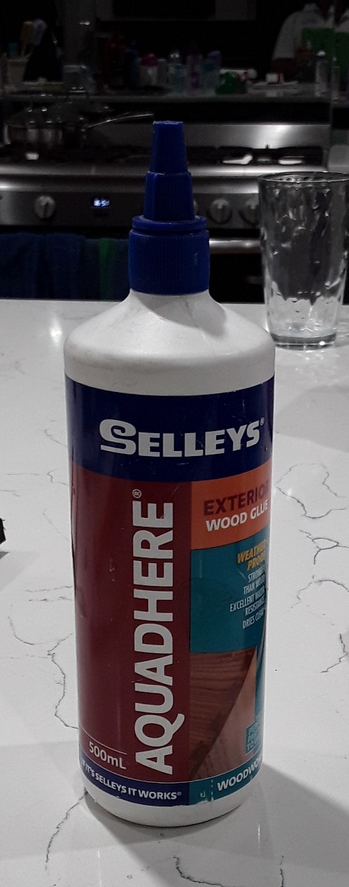

Attachment 25635 ive used this its a bit more resistant to water and susposed to stronger than pva i would think i havent cleaned the timber properly or not enough glue the other 3 guitars have held fine

Well, it won't respond to steaming then. That Aquadhere Exterior is heat resistant to 110°C, and waterproof, so steaming simply won't touch it. A red hot spatula is likely to be the only way, but you'll have to have it hot enough that it's going to scorch the wood and the finish around the joint.
So I'd probbaly try and get a syringe with a needle, fill it with glue and try and and get as much glue in the gap as possible, then really clamp it. Make a notched wooden block so you clamp down on the fretboard, not the frets, a plain block underneath the neck, and use a G-clamp, which can apply a lot more pressure than one of those ratchet bar clamps. If it works you're fine, if not, you are in the same situation as before and can then try the very hot spatula method.
It really is not a good idea to use anything 'stronger than Titebond red label, standard PVA or hide glue for sticking necks on, just because those glues are strong enough, you don't plan to play guitar underwater so it doesn't need to be waterproof, and if you do need to remove the neck, then you can.
