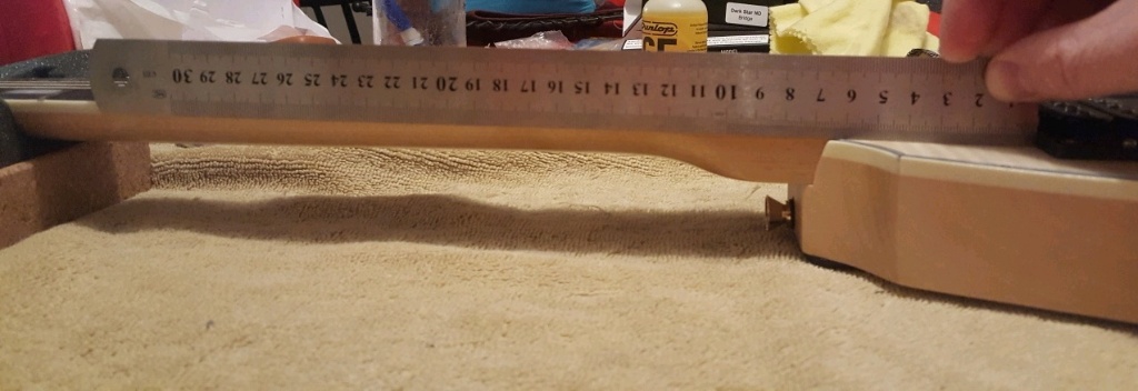

Hey Guys, i just had a look at my Flying V, the neck actually sits high above the body about 5mm where the neck ends and is 4mm where the body meets the neck. is that normal for these kits? i looked at my prs and there is no gap at all it is flush to the body. has anyone had this before?
Attachment 20499
do i shave it down? or is this normal for a bolt on neck?
Hi Brokin, that looks perfectly normal, unless it's causing you issues with playing or action height i wouldn't touch it. Your PRS will be a slightly different set up, so probably not a good comparison.
im not sure if this is important but i do have to have the action pretty high not like my other guitars. also i checked it against a ruler that sat flat against the body and it definately isn't flat against the body as you can see with the photos. is it ok? i do get a buzzing of the strings around the 12th fret not through the amp, just if you play the guitar by itself.
Attachment 20506
Attachment 20507

thanks Waz, the neck was bowed as you said. i did the adjustments which worked out well, thank you heaps.for your help. unfortunately it still buzzes on the 12th fret. i honestly think its the neck its angleing downward at the head of the neck. i have played with the action and i still have to have it high to stop the buzzing. i might have to look at the neck fitment to see if i could flatten it out somehow.
i checked the height from where the neck ends in the body to where the bridge is. i used a strait edge and i found its 5mm higher at the bridge then where the neck ends.
i dont know if that's normal but i think that's a bit much as i thought the neck would have to be pretty flush to the body. but i could be wrong
ok i was able to level out the neck a bit more to the body. which is awesome and now i was able to lower the action and how much the pickups stood out (they were pretty much maxed out to there highest level). im really happy with the result and it looks alot better now.
