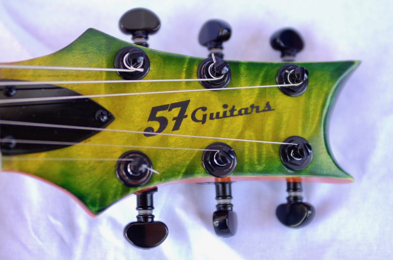

How is the clearance on the A & B tuners as well? They look like they will be very close to the edge as well.

Hardware mounted, string it up and plug it in. Very happy with the end result for my very first build.
In Summary:
- PBG PRS-1Q
- PRS shape headstock with quilted maple veneer
- U-Beaut dye, Aussie Oil and Traditional Wax
- Pleeenty of elbow grease
- Upgraded Tuners - Grover Rotomtics
- Tonerider Rocksong P/ups
- Tusq nut
- Upgraded to CTS Pots & orange drop cap

wow that's stunning Axemurderer, how does it sound and play ? If it plays half as good as it looks you are laughing !
Some nice upgrades you did.
DEFINITELY enter it into Feb GOTM !
Oh dear I think I may have just had a gentlemen's moment :)
Bewdiful
Thanks Wok and Dave.
I've not done the setup yet. I figure I need to let the neck settle under tension before mucking about with relief and action etc. Still it does sound good so far. I had to correct the bridge earthwire connection which has fixed the hum I was getting.
