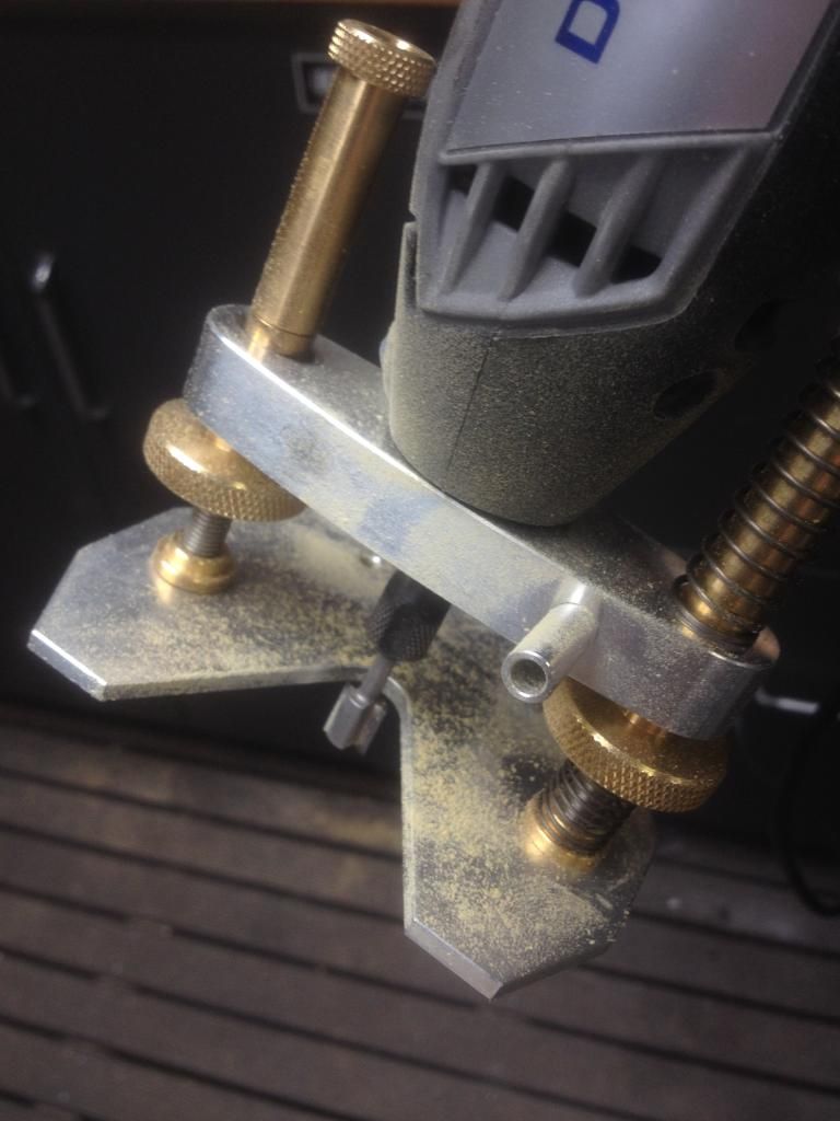

After an attack of bravery (or stupidity) I decided to get that truss rod neck pocket routed.
Use this with the Stewmac Baseplate addition:
http://i271.photobucket.com/albums/j...ject/009_1.jpg
Had this measured and drawn up for a while. Was waiting until I worked out a clever jig. Couldnt think of one, so went freehand!

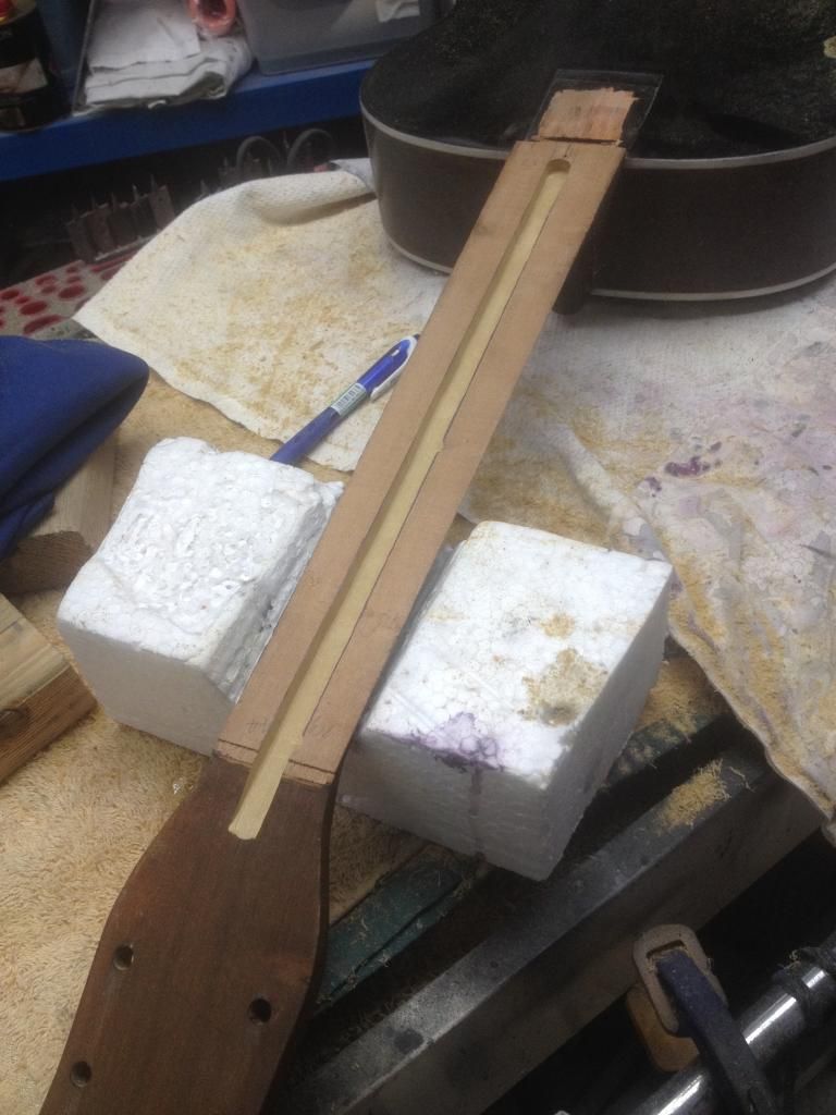

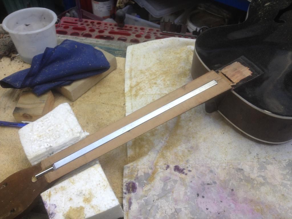

Turned out like this:
http://i271.photobucket.com/albums/j...ject/010_1.jpg
http://i271.photobucket.com/albums/j...roject/015.jpg
http://i271.photobucket.com/albums/j...roject/014.jpg
http://i271.photobucket.com/albums/j...ject/020_1.jpg

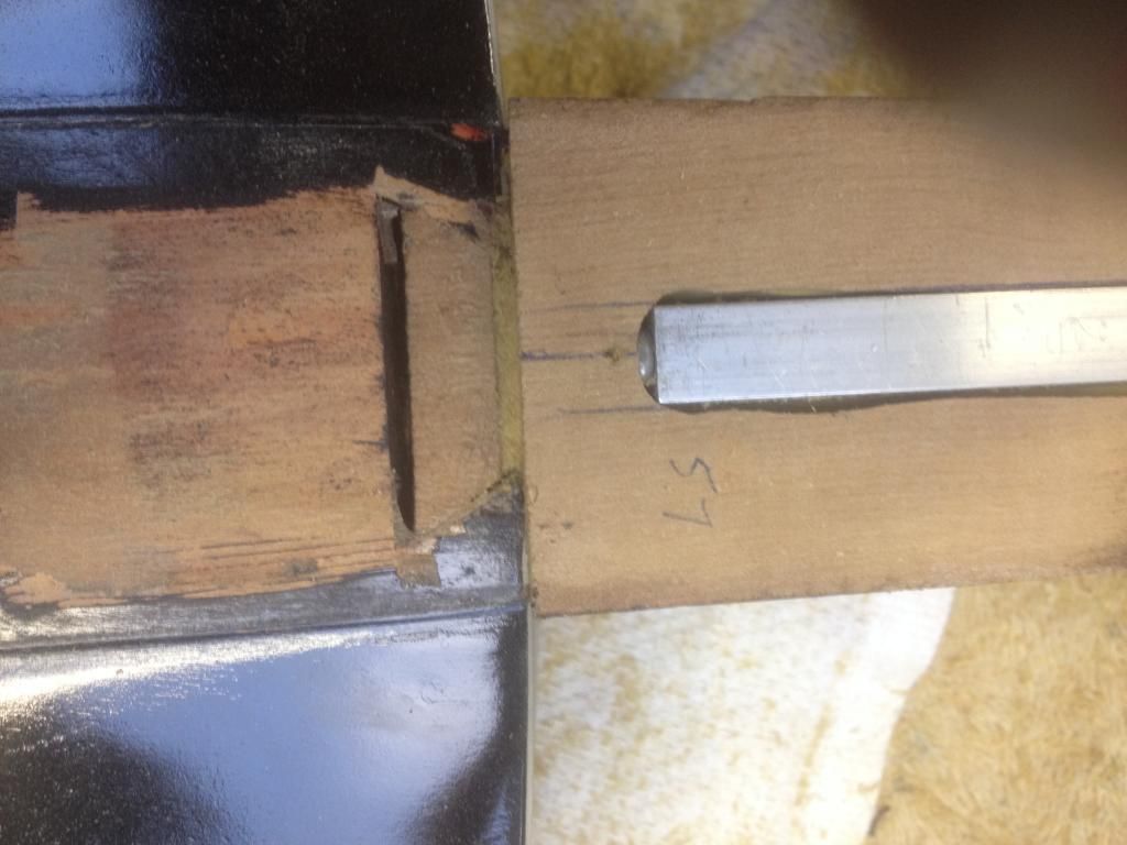

Filled that gap with a bit of Titebond and shavings, just to be sure, not taking this apart again:
http://i271.photobucket.com/albums/j...ject/021_1.jpg

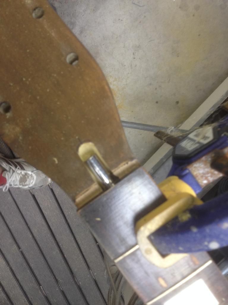

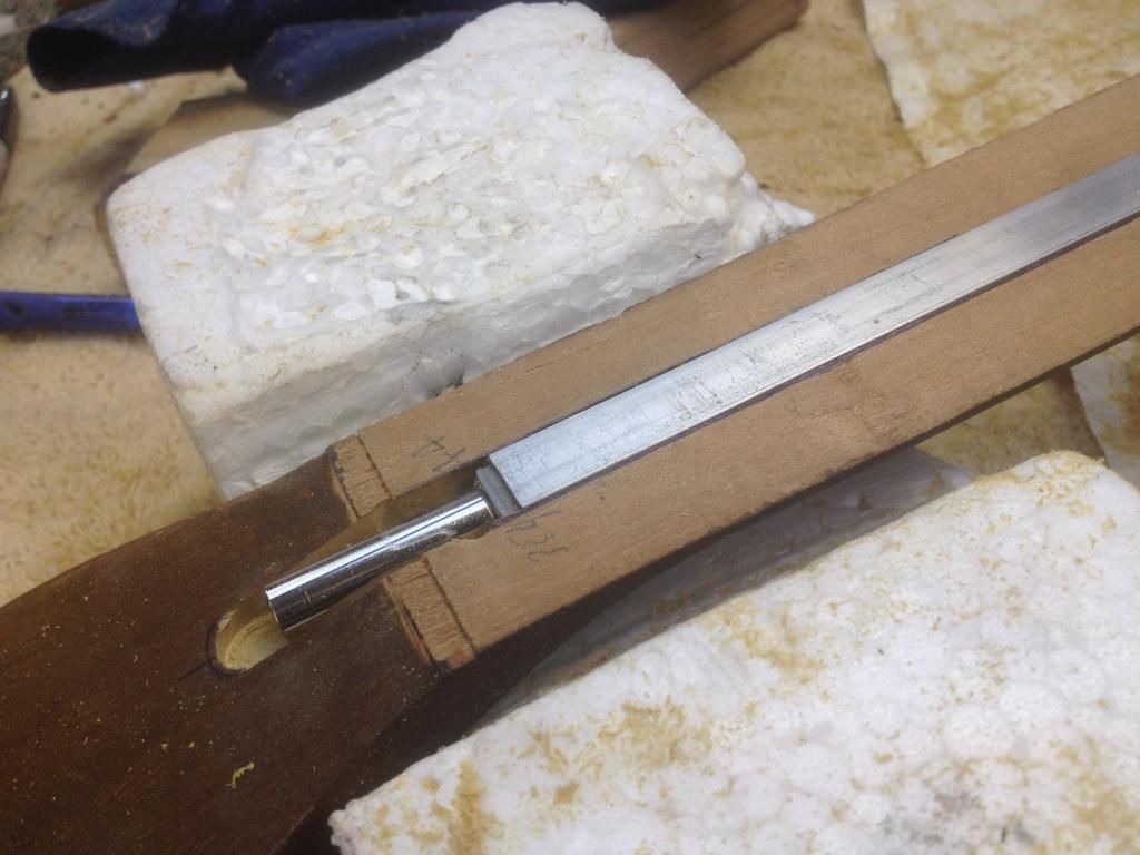

clamped on the old fingerboard to see if it all seems well. I will be making a new blackwood one...
http://i271.photobucket.com/albums/j...ject/017_1.jpg
http://i271.photobucket.com/albums/j...ject/018_1.jpg
It seats well, but might have to make the route further towards the neck join to get the adjustment bit below the level of the top of the headstock, by sliding it back further.
Or put a plate on the headstock, or both
Well done Stan. Fabulous job putting that truss rod in. Neck building is what you've done, I am sure it is on most of our list of 'to do' but very few have.
