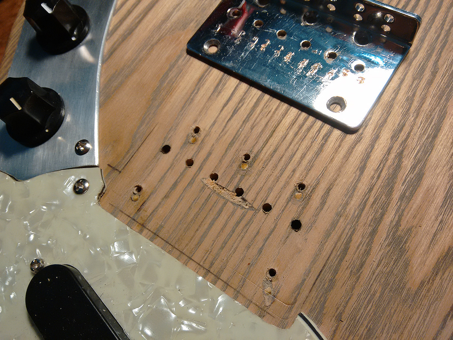

It was getting late when I was planning on a visit tomorrow for a longer drill bit to drill another earth hole but then a 'eureka' moment.
Attachment 36028
I can put the drill away for now.
