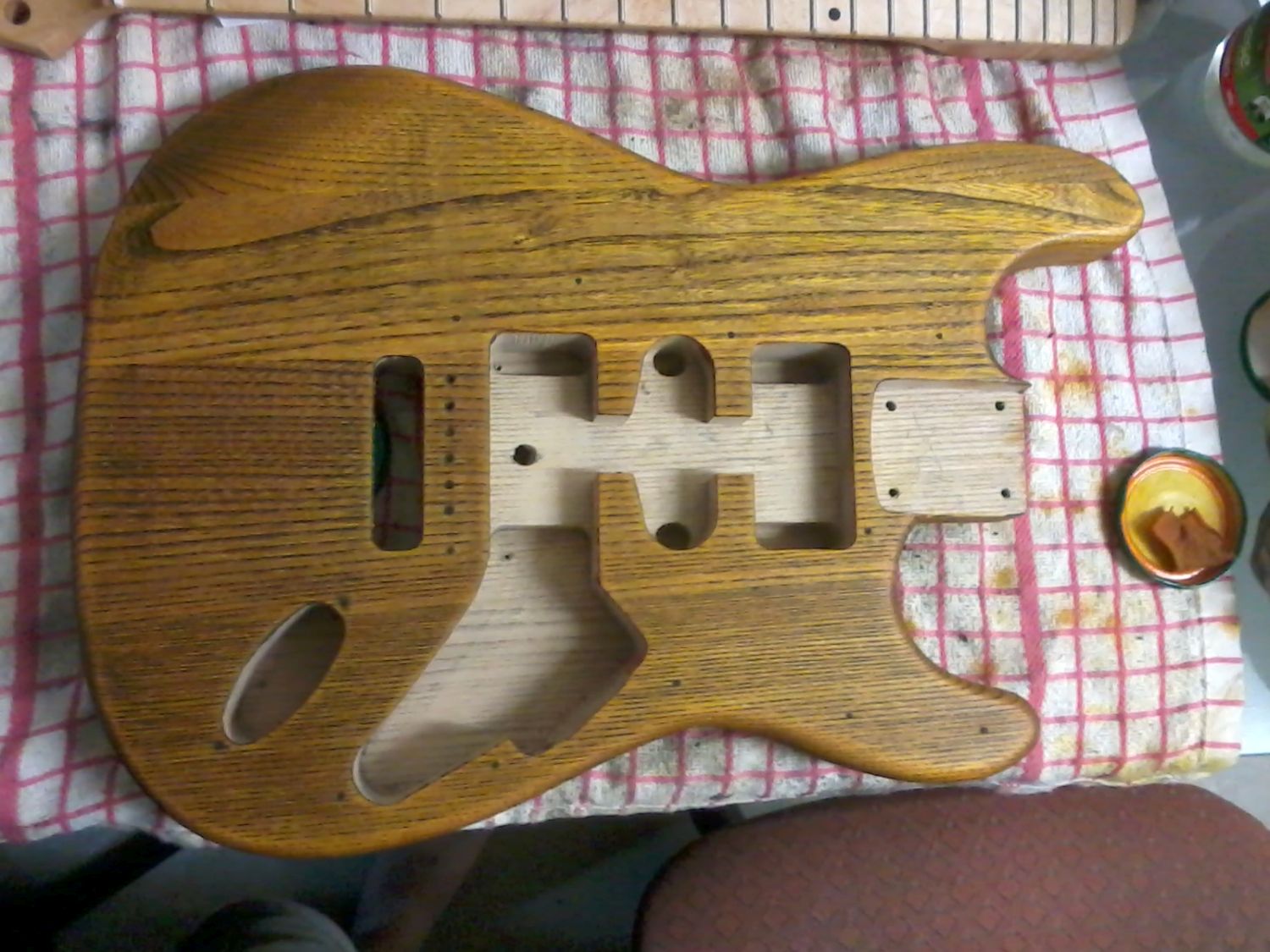

Update:
Well, temptation got the better of me so I decided to apply the DT Coolangatta Gold stain, to say that it's already looking awesome is an understatement, well I think so anyway, I had an OMG!! moment just after I started applying it, here's what the guitar body looks like now:
Attachment 9441
I agree Doc, this is looking mighty fine. The timbermate has worked a treat. How good is it when the grain pops in front of your eyes! Keep up the good work

That is looking superb Doc! I really love the grain figuring along the upper bout, how it sweeps forward across the top of the guitar. I'm curios to see how it comes up with curing and re-application of stain.
Cheers mate, the fragrance can be best described as a pleasant Citrusy kind of smell, well that's what my nose is telling me anyway, and yeah we've been getting alot of rain lately since Darwin is in the Tropics, I'll take note of what you're saying about thin coats and drying times.
I'm liking the grain too, at first it didn't look anything special before the application of the TM, but now it has a quality that's grown on me and it's made me realize that you don't necessarily have to have a spectacular grain pattern for this technique to work.

I've actually gone and applied the DT CG all over the body as well as the sides, I'll see if I can post a pic of the back.
Here we go, this is what the back of the guitar body looks like now:
Attachment 9446

back of the body looks sweet too Doc, wait till you get more CG coats on and clear coats should look wicked
I think I did at least a couple of coats of the CG on the body last night, so if that's any indication to go by then the body should look even more awesome-er when it's finished, I'm going to be applying a second coat of the final clear coat to the neck later on tonight and then I'll call it done, so then all that will be needed to do is finish working on the body.
