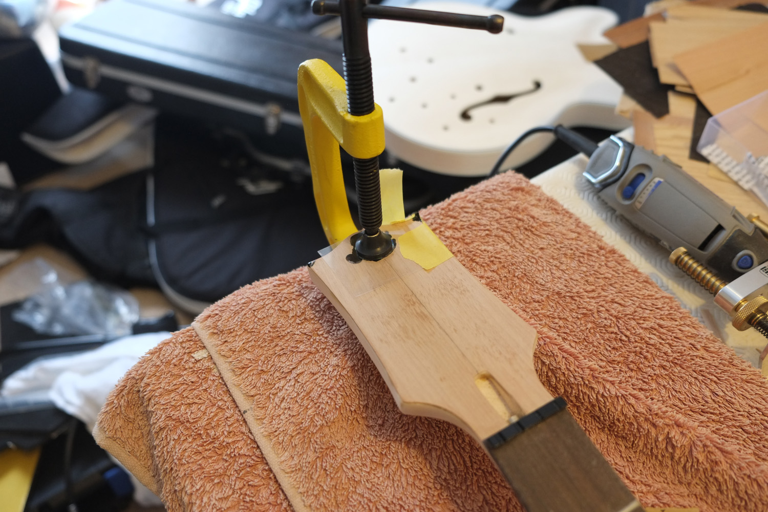

Well, haven't done much on this recently as I've been concentrating on the ES-1/330 build, but I have now done the same with the headstock as I've done to my ES-1 neck. Namely stuck on some veneer, trimmed that back to the headstock shape, routed out a circle in that and stuck in an inlay logo with black superglue (it's round and almost the same size as the disk on the clamp). There is a sheet of clear plastic between the clamp and the glue, which i know superglue hardly sticks to.

I've since removed the clamp and filled in the remaining gaps in the inlay with more superglue. Now waiting for that to dry.
Just in case you've forgotten, the kit came with an un-drilled headstock. I'm still awaiting my Hipshot mini-tuners as they didn't have enough of them in stock, so have to wait until the next shipment comes from the states. Then I can lay them out and see where I want to put them for the straightest string pull. I many need to reshape the headstock as a result at the end so I can move the A and D tuners in a bit.
Well the inlay work was close, but no cigar. This is the result on the bass's headstock, which I quickly brush painted black with some acrylic just to get an idea of what it looked like with the proper background.
Attachment 25203
It's almost worked, but I really picked an inlay material with too many dark, almost black, sections. It looks better in the photo than in real life and this is the best viewing angle for it.
The lighter bits look fine, but for the size of the design, the abalone sheet I used has just too many dark areas which break up the logo. I'd also routed out too deep a circle, so the inlay didn't stand slightly proud of the veneer as was my intent, so that I could spray on a some layers of black then sand the whole thing back flat. The abalone would probably work fine with a much bigger design, but not on this scale.
The ES-1 build headstock is the same. :(
So this will get replaced by a similar design, but using some much whiter MOP materiel, which I've just ordered. I may also try cutting out the letters and circle separately. So, hours of more amusement ahead!
