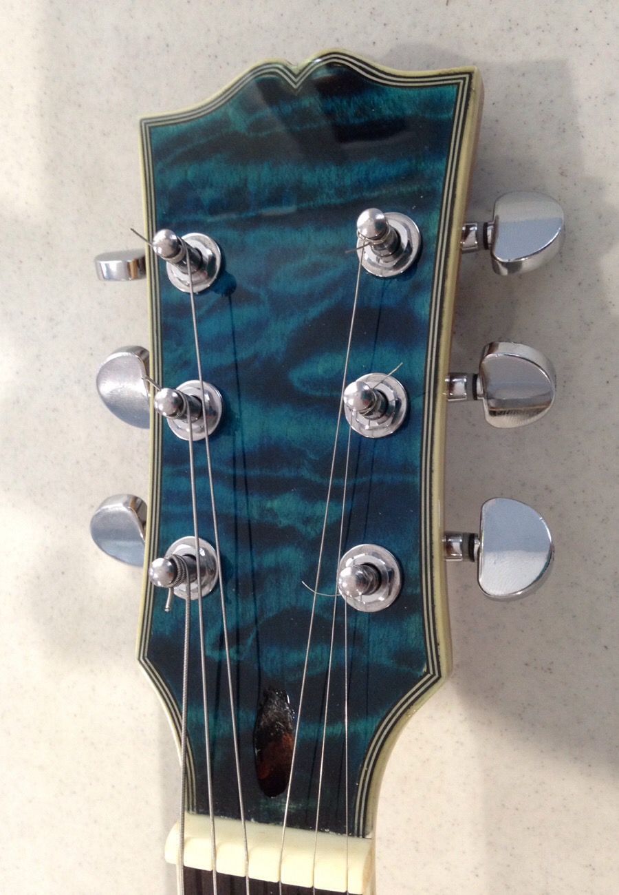

The Tung oil in the can is,certainly a yellow to honey colour and has given the binding a yellow tinge, before wet sanding and polishing some of the body had a slight green tinge where the layers might have been thicker.
The kit did come with a traditional looking truss rod cover. But I would like to add a personal touch to the kit and cover up one of the areas that did not finish as well as other areas.
Attachment 25051
