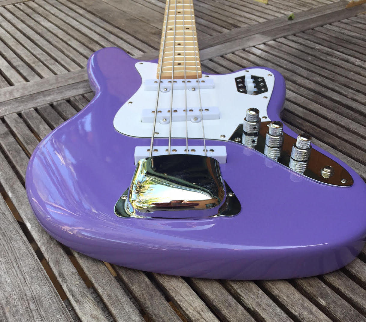

So that would tend to suggest Ash Tray might be the way to go?
Yes, the ash tray option works for me. Might you need to add a thumb rest at some point, or is the middle pickup in the right place for you to use the edge of that?
I like the chrome cover version best... great looking guitar too!

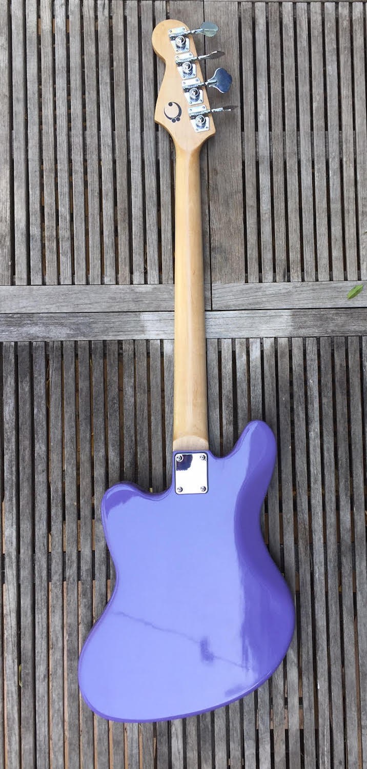

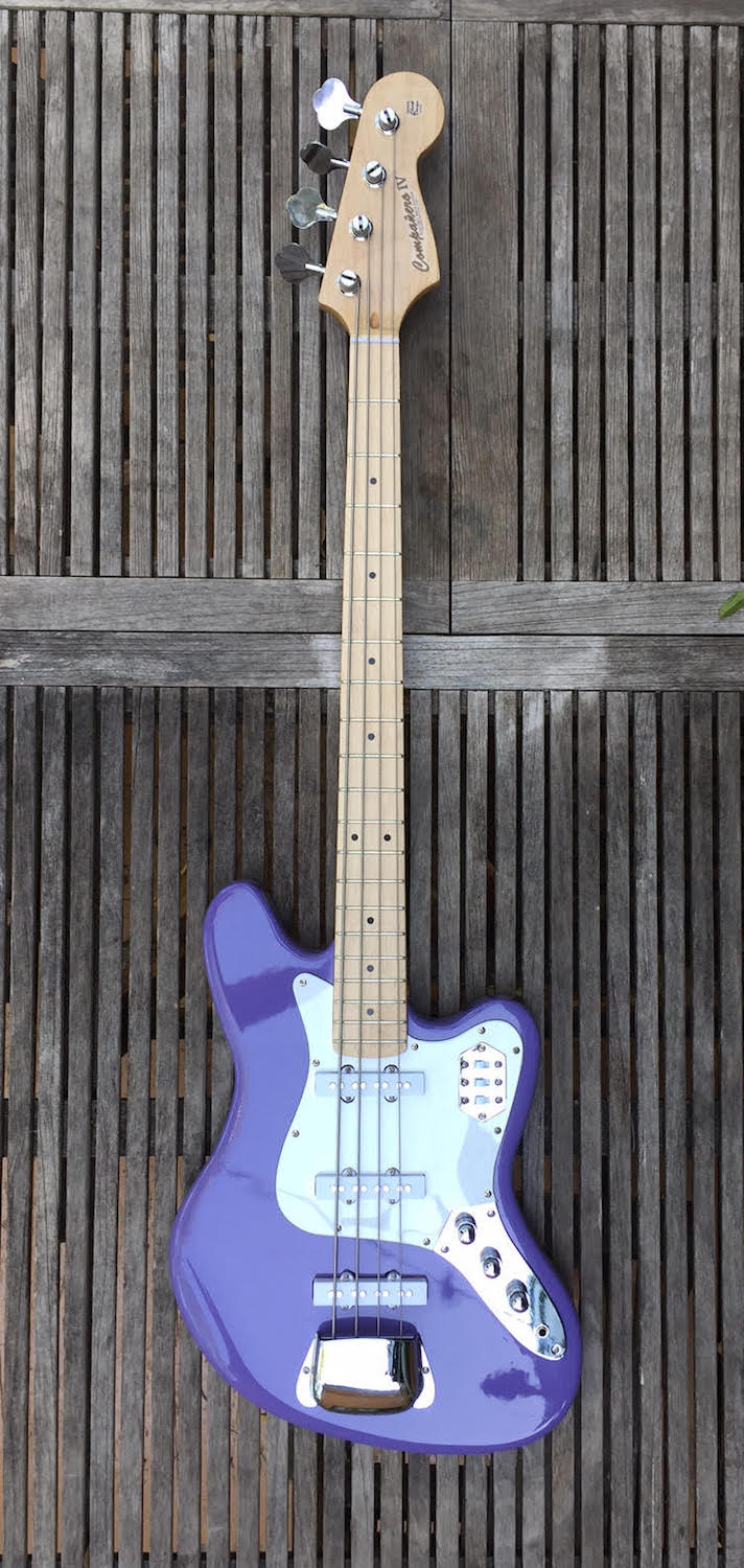

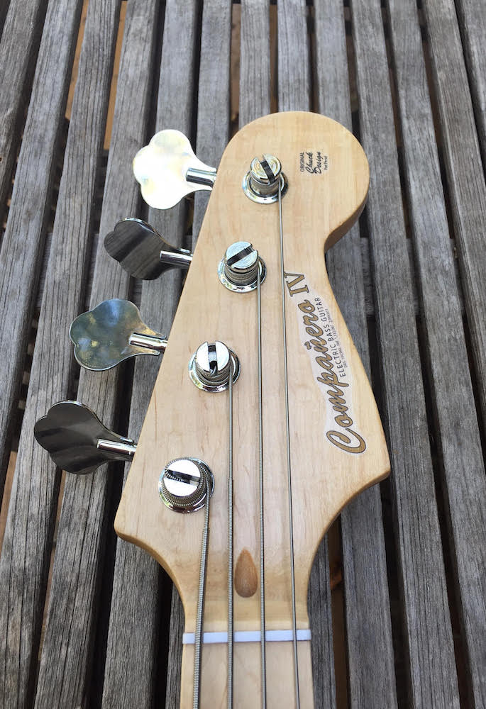

Well it’s done! Finally got a chance to have another crack at the wiring and thankfully there was life in her after all. A quick polish and set-up and I have to say I’ve very excited about this one. I feel I’ve met my original goal of replicating the three pickup/selector switch setup of a Bass VI, and the fact each of the pickups has its own dedicated vol/tone concentric pot setup makes for some pretty interesting tonal variations. Once I’ve had a bit more of a pay with it I’ll certainly post some sound bites. The other thing I love so far is how easy it is to play – those three pickups make for nice thumb rests – and the neck may be my favourite among all my basses!
So here it is: a standard JB-4M kit, with a modified body, new DIY pickguard, additional JB pickup, “Jaguar” switch plate, concentric pots and a bridge “ashtray”.
