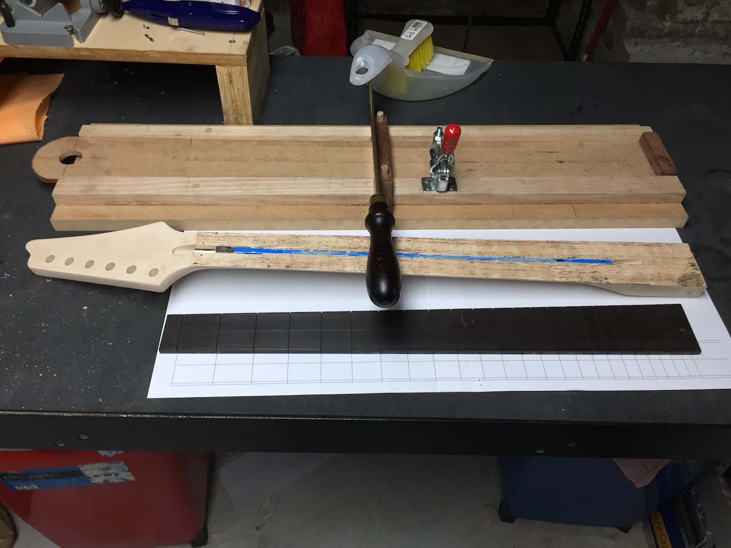

Thanks to the dud fretboard test with the rosewood stuffed blank, I was a little gushy about doing a second attempt on a serviceable fretboard for fear of stuffing it up.
Thankfully I found some premade pdf slotting templates that i was able to print out and apply like a cutting mask. So we ended up here:
Attachment 16355
My homemade Fretting jig was pressed into service again, I have, since first test, managed to add one of the two toggle clamps that are supposed to be on it. At some point (Probably the next fret board) I shall get around to adding the second one.
I measured up and marked each fret prior to the cutting through the mask with a marking knife. Each fret was cut in turn from 1 down to 24, then I stripped the mask and went back down the board to even up cut depths. I actually cut the nut indication line last as I wanted to verify the Nut to 1 distance. I had allowed for the wider locking nut in the over all scheme so this has worked out well.
I'm fairly happy with the results. Though it's hard to see in the picture all the lines on the template match the Slotted board. When I overlaid the old board the came off it, the two sets of slots corresponded exactly, so I am reasonably pleased with that outcome.
