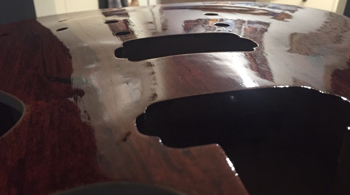

I think i know what you mean the flame is rippled but there is a spot in the spalt where there seems to be a dent i'll take a picture when i have daylight.

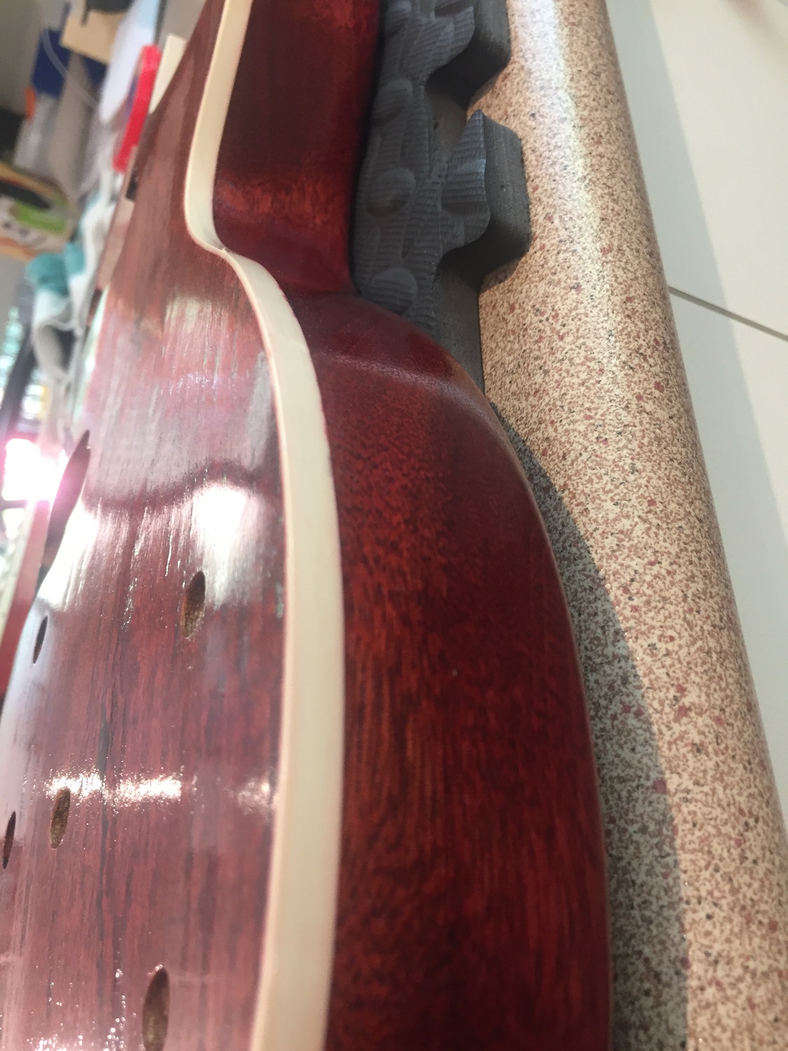

So i went a'd checked out gavin's post if i understand correctly i need to polish the binding with only fine sandpaper and tjen steel wool and then rub off any spilled stain with steel wool between each coat. In the end do i rub tru oil over the binding?
