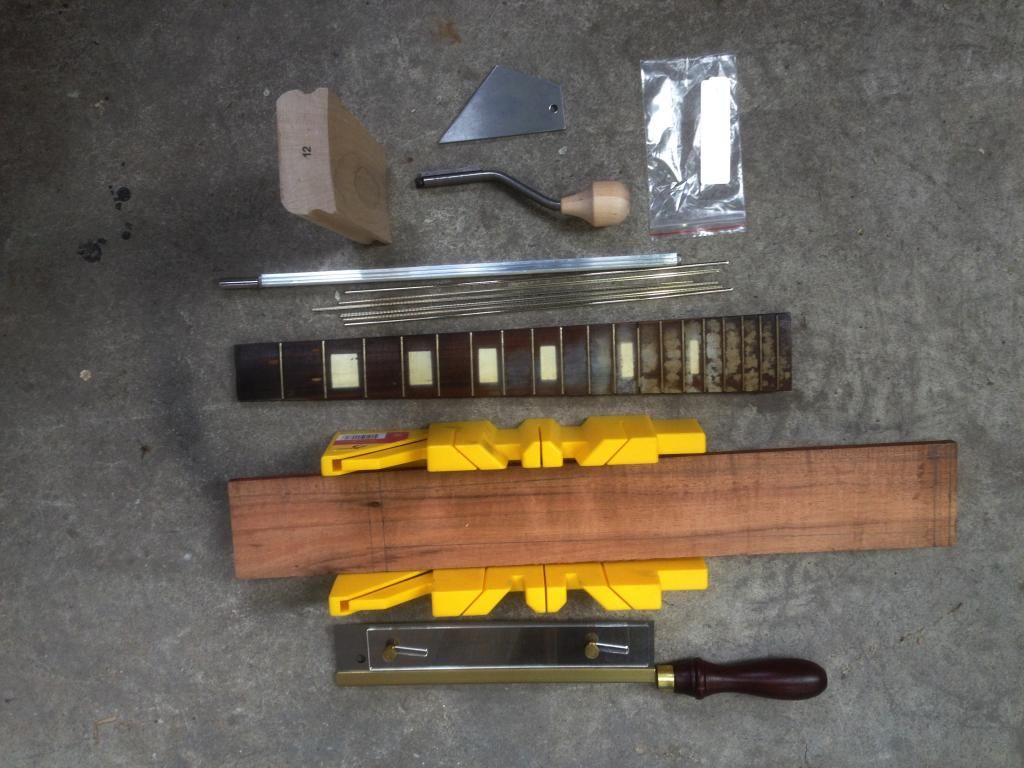

OK: I have a truss rod, a router and a fingerboard blank made of blackwood. Some fretwire, and a radiussed sanding block: 12"

		toys and supplies for the new fingerboard (old one also in shot):
http://i271.photobucket.com/albums/j...ject/016-1.jpg
