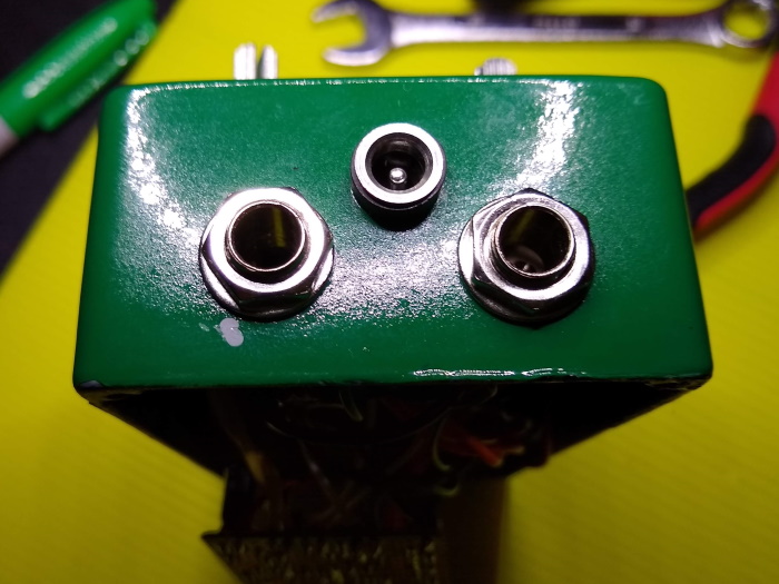

Thanks. I prefer larger knobs, but on this one I really wanted to use the ones with the green indicator. Plus larger diameter would obscure the text. They are a very tight fit though, so I hope they don't have to come off any time soon! Now that I have discovered how good Tayda prices on pots and knobs are, I will mostly use round pot shafts and knobs with set screws. Much easier to work with.
There is that. I do find that the tension of the wires helps keep the board in place. But on the next build I am going to try using short runs of tinned solid core wire where I can (maybe with heatshrink tubing) to see if I can get things tidier.
Also, I am definitely going to explore screen printing. I am growing frustrated with acrylic lacquer. Even though I am using etch primer which should give good adhesion, I still find the finish annoyingly fragile. On this one my pliers slipped while tightening the lock nut on the jack, and chipped the paint. I put some green sharpie on to make it less obvious, but very annoying. I think that screen printing over powdercoated enclosures should be more resilient (and more professional looking).
Attachment 36154
What do you see wrong with this statement???Quote:
On this one my pliers slipped while tightening the lock nut on the jack...
