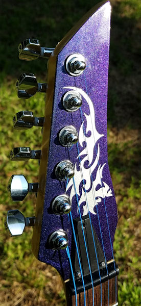

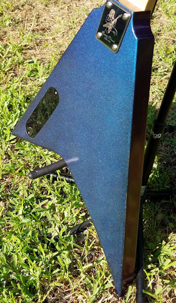

That looks pretty sweet to me - love the way the colour changes so much.
Thanks. Depending on the lighting, it follows the spectrum from a deep navy blue sparkle to a deep purple. With inside lighting, the shades are darker and not so wild, but when you get it in the sunlight, well, you see. :) Really happy with how it turned out despite using quite a few swear words while working on the finish.
It's come up great in the end.

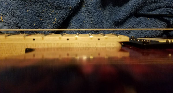

I should get the second build finished up over the weekend. Found my black bushing for the tuners and got a replacement string block for the Floyd. It's wired, strung and working. I have to sort out out a "wee bit" of an action issue. I think I only need to lower it about a foot and a half. :) Relief is set up correctly, bridge screws are down as far as they'll go. I've got a little play in the trem claw to work with, but I'm probably going to have to end up shimming the neck as well.

After that, it's just the little things -- cavity covers, etc. I'll definitely be adding a string retainer bar at some point. Most of my Floyd guitars have them, and after stringing this one, I see why. I found it pretty difficult to get a tight wrap as the string kept wanting to slide upward. I'm also 100 percent sure a Floyd upgrade is coming if I decide this one's a regular player. String blocks popped out of this one every time I moved it while stringing it up. I spent a lot of time on the floor trying to find where they bounced. Other than those little issues and the high action, though, it seems pretty solid at this point.
Thanks. I got the action down last night, but I'm still not quite happy with how it's playing. Tweaks continue. I also seem to have hit the live wire on my bridge pickup with the soldering iron at some point and got it a little melty so it's giving me some static trouble now. I'll need to go in and redo that over the weekend, too. Hopefully pics of the finished project on Monday, though.
