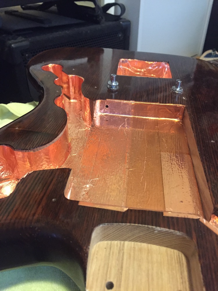

I really do hate shielding - just when you think you've nailed it you start finding multiple places you've missed. What's more, I've just realised I put the bridge posts in without the ground wire (see that sad little empty ground hole). I'll now have to drill a new hole into the trem cavity and ground from there *sigh*
Attachment 21470
Hey Chuck, there are methods to remove the bridge bush to get your earth wire in. I used a drill press if you have access to one. There are worse parts of a build than shielding - wiring and sanding for me haha
You may be able to grip the bush screwed into the body insert vertically with a pair of pliers and pull hard
with a bolt of the right size and a few bits of scrap steel you could make up a puller, but by then you could have just drilled a hole in to the trem cavity :P
Thinking about it I made one of these a while back
