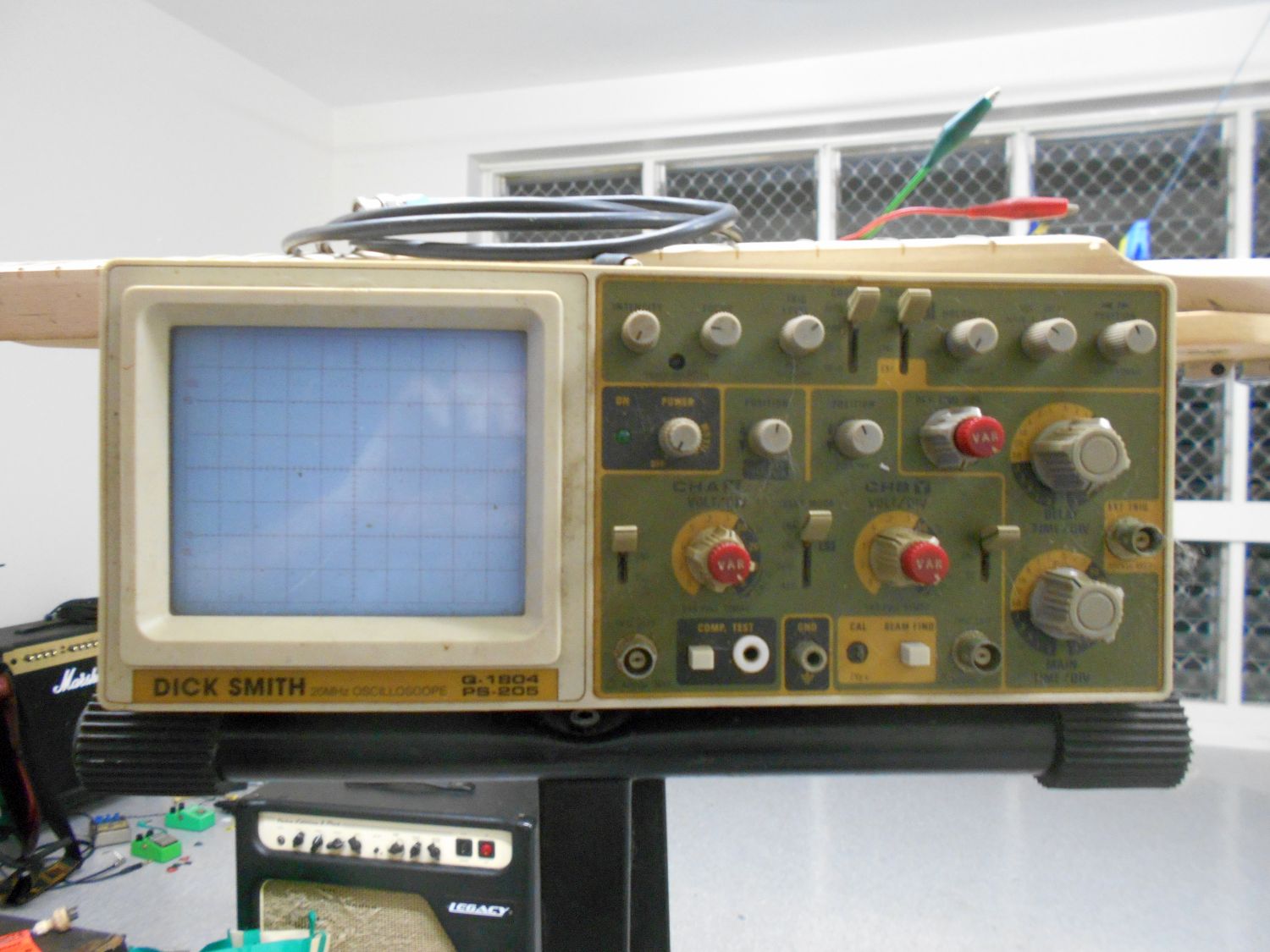

Note 2: I almost forgot to mention that I used my 20Mhz Analog Dual Trace Oscilloscope to monitor the output level at the output jack on the side of the pedal, definitely a handy piece of test-equipment to have on hand.
My Dick Smith Electronics Q-1804 20Mhz Dual Trace Oscilloscope:
Attachment 24937
With the help of my dad, I ordered it from Dick Smith Electronics in 1998, making it about 20 years old by now, still seems to be going strong.
You've got the newer version.. Mine is a '86 vintage 20MHz Kenwood from the same retail chain. It works but the gain and timebase controls are in dire need of replacement due to use and so are very touchy... Much more a 'just turn it on and then set and forget' device nowadays...

My DSE Q-1804 cost around Au$700.00 when my dad and I bought it brand new, one thing I'll have to do one day is replace the trimpot (I'm guessing that's what it is) for the trace rotation cause it's getting increasingly hard to adjust.
Been seriously thinking of getting myself a good Digital Scope for a long time, I found that Jaycar Electronics stock a couple of good ones, a 20Mhz one and a 100Mhz one, the 100Mhz one is the more expensive of the two.
That trimpot may just need a squirt of contact cleaner, rather than replacement. Worth trying that first.
It's not so much that, it's one of those miniature blue plastic PCB -mounted trimpots that has a white plastic centre where the adjustment screwdriver goes, basically over the years I've had the Scope the white plastic screwdriver adjustment centre for the trimpot got a bit worn so that the trimpot has gotten hard to adjust, but yes I could try giving it a spray with contact cleaner.
Ah, I see. Well, if you can get to it - replace it!
