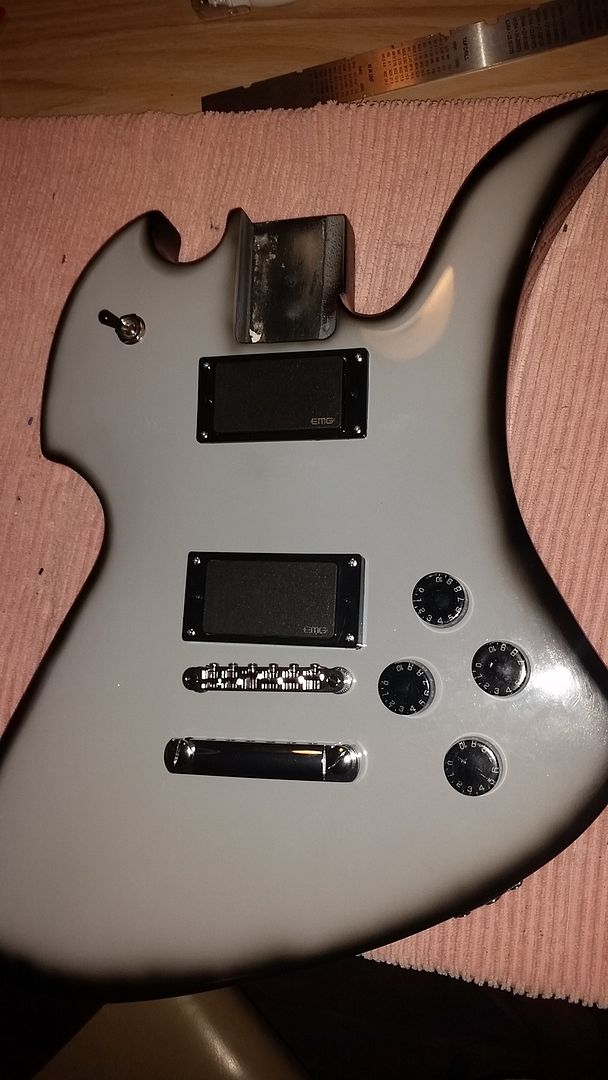

Funny thing, Andy, Alex stayed home, and watching the Cowboys flog the Rabbitohs became my priority!

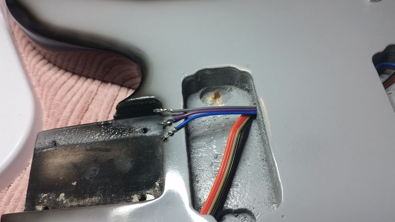

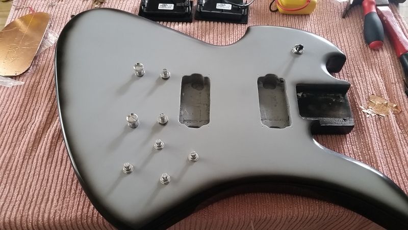

Anyway, this morning we installed a few bits of hardware, remembering the bridge ground wire, of course!
http://i231.photobucket.com/albums/e...pskab8jpdq.jpg

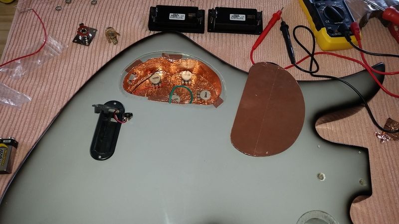

I decided we'd shield the cavity, even though it will have active pickups... just in case things change in the future.
http://i231.photobucket.com/albums/e...ps8gqxmxbo.jpg

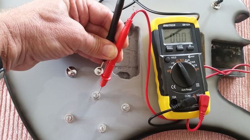

Checked the bridge ground continuity, and it's all good - from the bridge post, to the shielding to the pot shafts. I haven't done any soldering yet!
http://i231.photobucket.com/albums/e...psftc7ip73.jpg

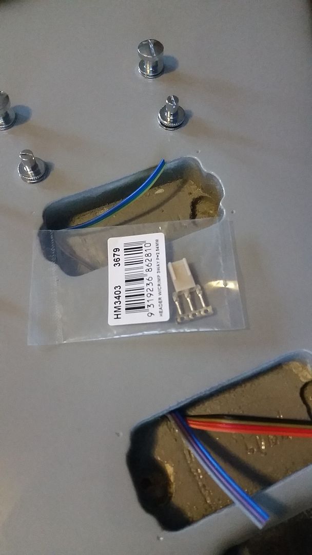

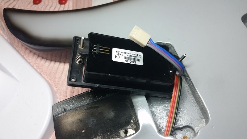

Next up was wiring the pickups. Since the EMG pickups have a three pin plug on the rear, I bought some three pin sockets to fit from Jaycar. EMG do sell a harness to suit their pickups, but Alex didn't have the spare funds.
Cable ready for soldering with the new socket...
http://i231.photobucket.com/albums/e...psptoemekj.jpg
Pins soldered to the wire...
http://i231.photobucket.com/albums/e...psppeou6bk.jpg
And the neck pickup ready to be plugged in and screwed down...
http://i231.photobucket.com/albums/e...pshl5aylam.jpg

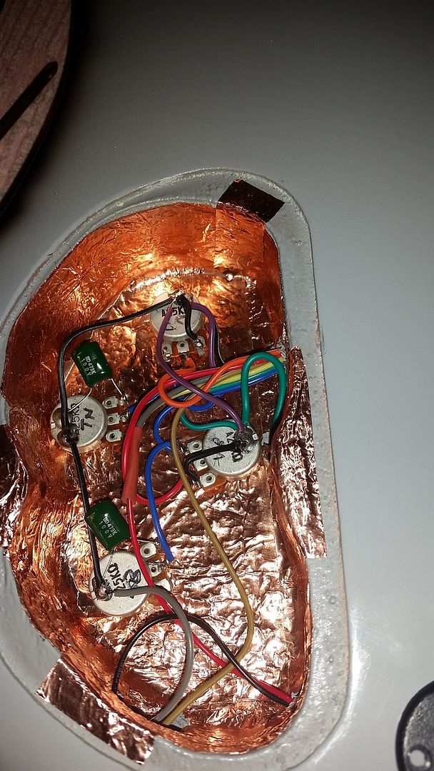

Okay, dinner done, wiring for dessert!
All the wiring done, and working. Hooked up a 9V battery, and the pickups passed the screwdriver-tap test.
http://i231.photobucket.com/albums/e...ps8q3zaryd.jpg
