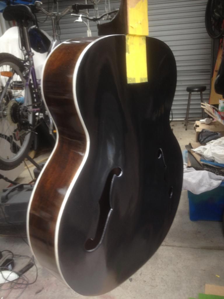

Exterior coats on the body are done:
http://i271.photobucket.com/albums/j...roject/052.jpg

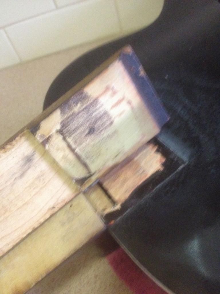

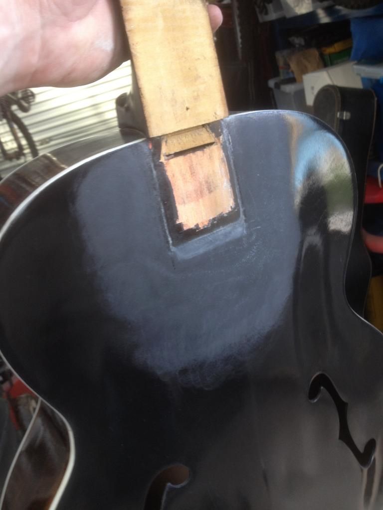

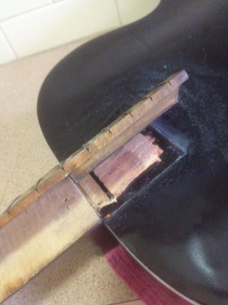

With some bow in the neck and my desire for a different radius fret board (and I dont like the original), off it comes:
http://i271.photobucket.com/albums/j...roject/056.jpg
Combination of heat gun, heated putty knife and wedging the fret board:
http://i271.photobucket.com/albums/j...roject/057.jpg

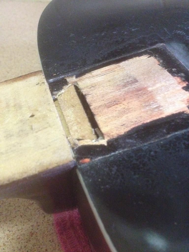

Last bit of fret board attaches quite well to the block that takes up the overhang...
http://i271.photobucket.com/albums/j...roject/058.jpg

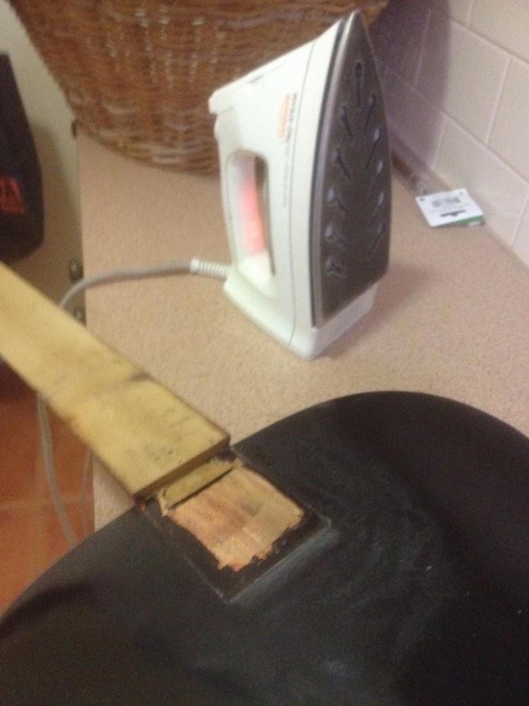

Time for the steam iron:
http://i271.photobucket.com/albums/j...roject/065.jpg
The glue separated nicely, but the steam damaged the surface:
http://i271.photobucket.com/albums/j...roject/064.jpg
http://i271.photobucket.com/albums/j...roject/063.jpg
http://i271.photobucket.com/albums/j...roject/066.jpg

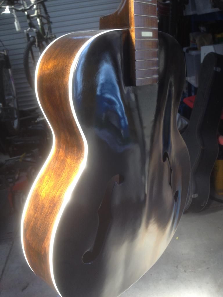

No problem, I am the paint it more than once master... haha:
Rub back - yay, only the clear was damaged:
http://i271.photobucket.com/albums/j...roject/067.jpg

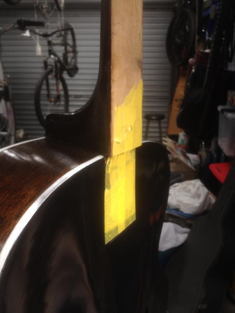

Mask up and re clear:
http://i271.photobucket.com/albums/j...roject/085.jpg
http://i271.photobucket.com/albums/j...roject/096.jpg

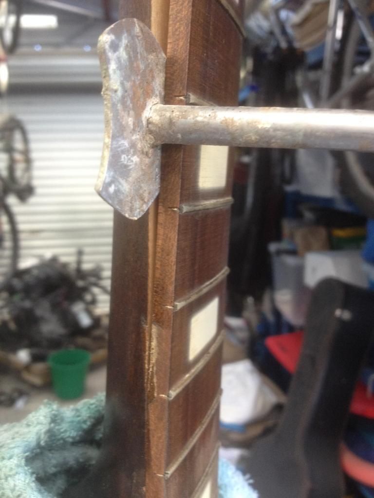

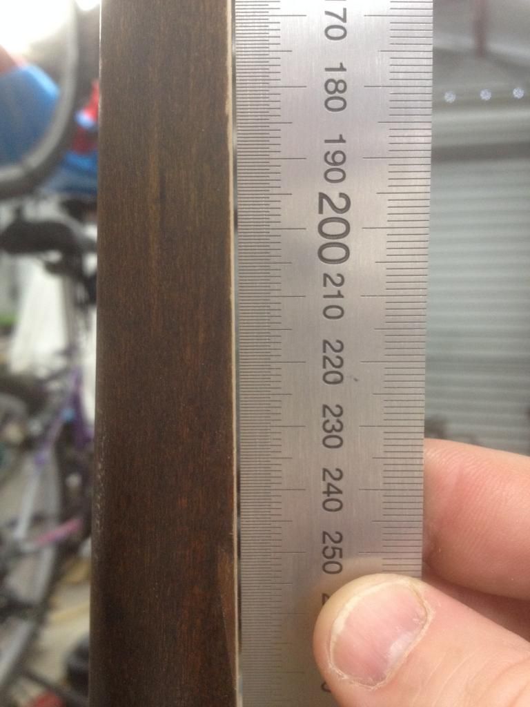

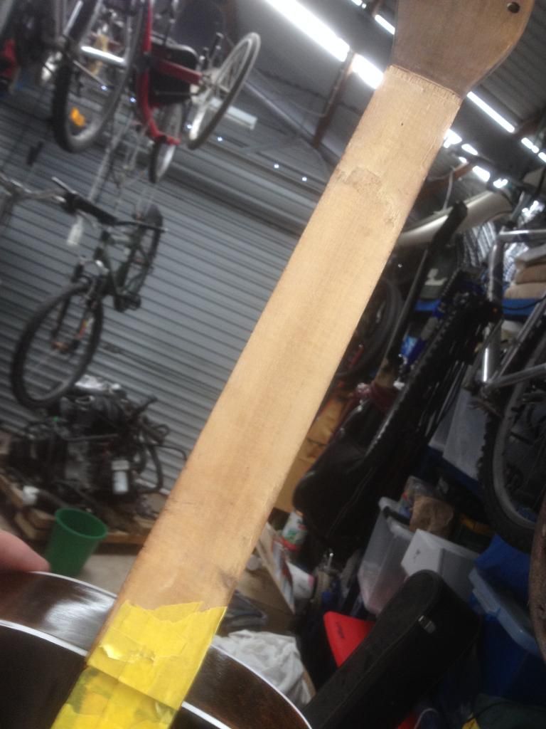

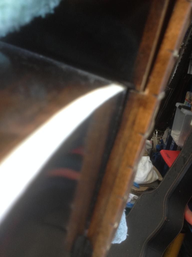

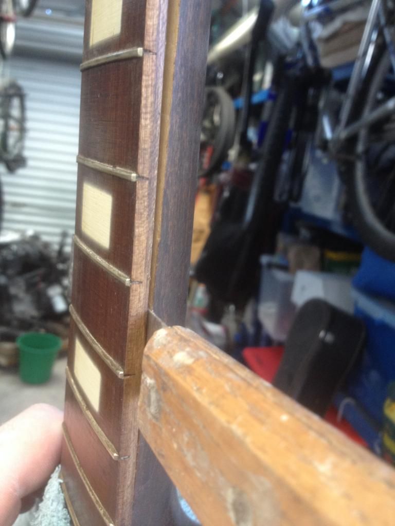

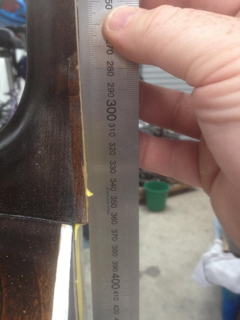

Check the flatness of the neck:
http://i271.photobucket.com/albums/j...roject/094.jpg
http://i271.photobucket.com/albums/j...roject/091.jpg
http://i271.photobucket.com/albums/j...roject/092.jpg
Not perfectly flat...
So, steam it and clamp it
or just put pressure on it
or sand it?
I do know I want a Tassie Blackwood finger board...
Maybe rout a channel for a truss rod?

yep Pablo, was thinking exactly that, truss rod would make it very easy to get right, just have never done it before.
I am thinking this is the way to go though...

It makes sense to do it now the finger board is off, looks like I have some reading to do...
From what I gather, I route a channel and pop one in. I have also seen fingerboards partly routed to fit over the top as well. Happy for the experts to set me straight here.
