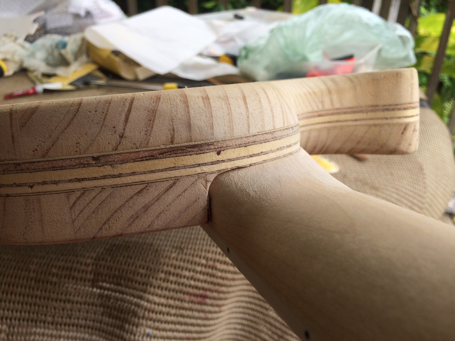

Another quickie.
Before I go too far down the sanding route I thought I had better get the neck pocket/heel problem sorted.
I contoured the neck pocket for better access to the 24th fret and also reshaped the heel of the neck a tad to make it a bit more aesthetically palatable.
This shows the reshaped neck pocket. I could have positioned the screws a bit better, but I had drilled them before actually deciding how I was going to reshape the pocket. Planning 101 – FAIL!!
Attachment 39459
These two shots show the reshaped neck heel and the fit into the pocket. This is still in the rough state but I feel that I can probably live with it once I clean it up a bit and add filler here and there.
Attachment 39460 Attachment 39461
As O’Reilly often said “a lick of paint, a lick of paint”. Those old enough to remember Fawlty Towers will get it. (Thanks Fretty for reminding me of those classic shows.)
That's it for now, lots of shaping and sanding to be done before the next update.
Cheers guys
rob
