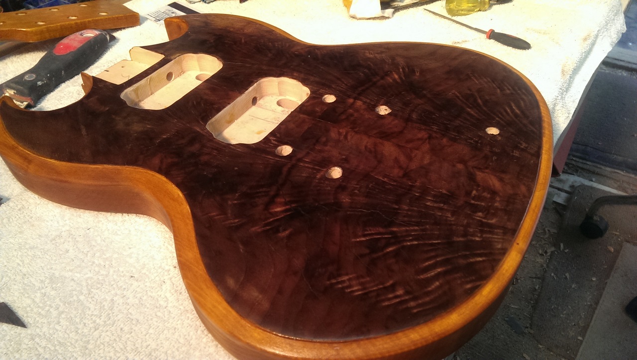

Double filled all the veneer cracks with the black timbermate and gave it a good sand, came up well.
Gave the neck only 2 thin coats of wipe on poly, a light sand with 1,000 grit and one more thin coat. It looks good, matt finish but it has highlighted the grain without a heavy buildup of poly.
Gave the veneer a coat of wipe on ploly

Had a spare weekend so decided to some more work on the SG.
When i glued the veneer on the the top of the guitar there was a bit of gravel that got caught between the bench and the back of the guitar, leaving a considerable dent!
Attachment 15019
So after some considerable youtube research i decided to have a crack at it. I had to sand and redo the stain on the back again anyway as the stain brought out some considerable scratches that i had been too slack to sand out..
Attachment 15020 Attachment 15021
Attachment 15022 Attachment 15023
Youtube said that if you use a wet cloth and a soldering iron the wood will swell, esp if it is bare, so i power sanded out all the scratches and went over it with 240 and then 400 grit
Attachment 15024 Attachment 15025
and then used the wet rag and soldering iron technique
Attachment 15026 Attachment 15027
As you can see it turned out a treat.
I put on a coat of stain and you could hardly see it.
Attachment 15028 Attachment 15029 Attachment 15030
( On the pic above the dent is in the exact center ) 2 coats of stain and one coat of wipe on poly, very happy with the results.
Attachment 15031
Good save and looks terrific.
good save Nitro and you have learnt a new skill so win win !
