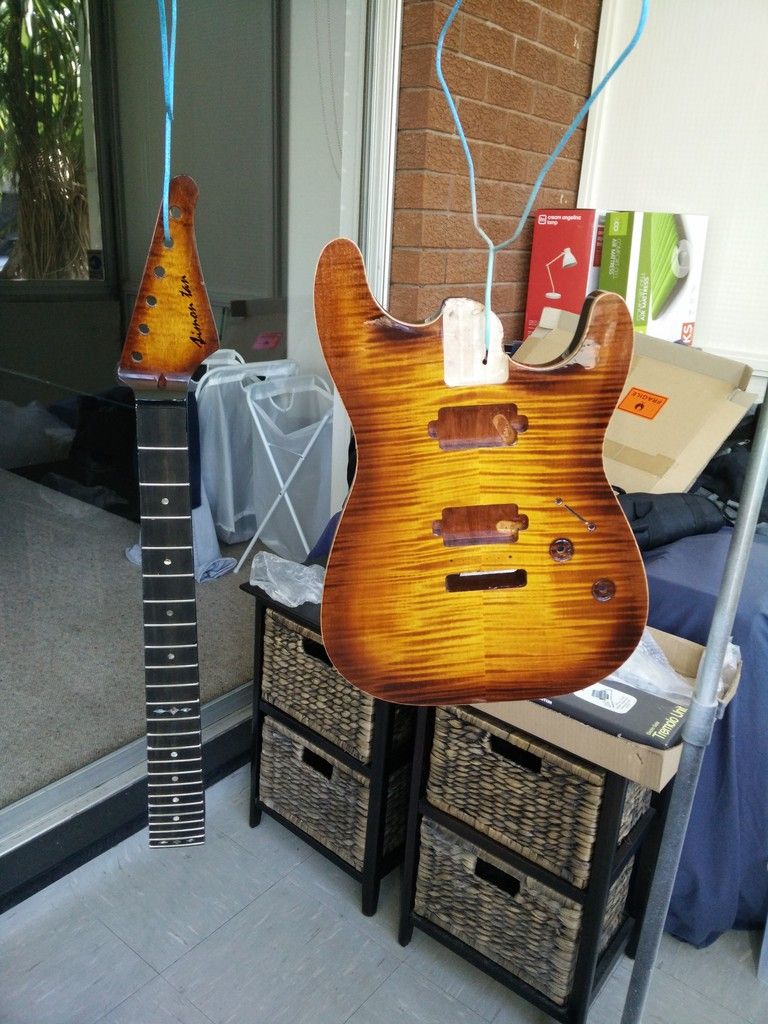

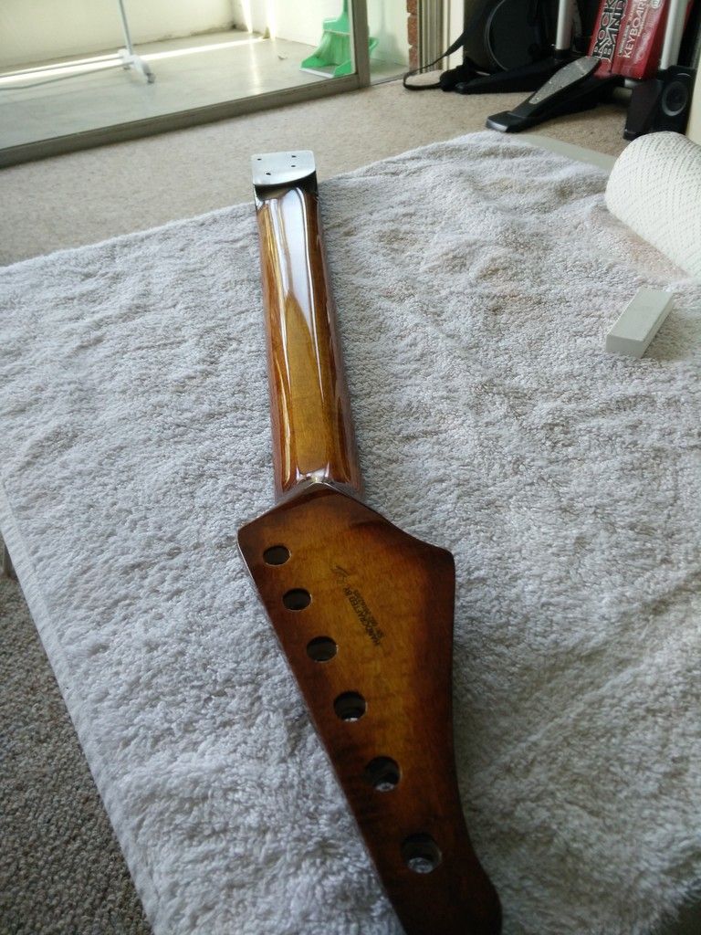

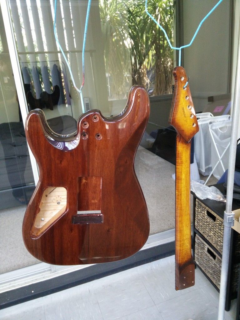

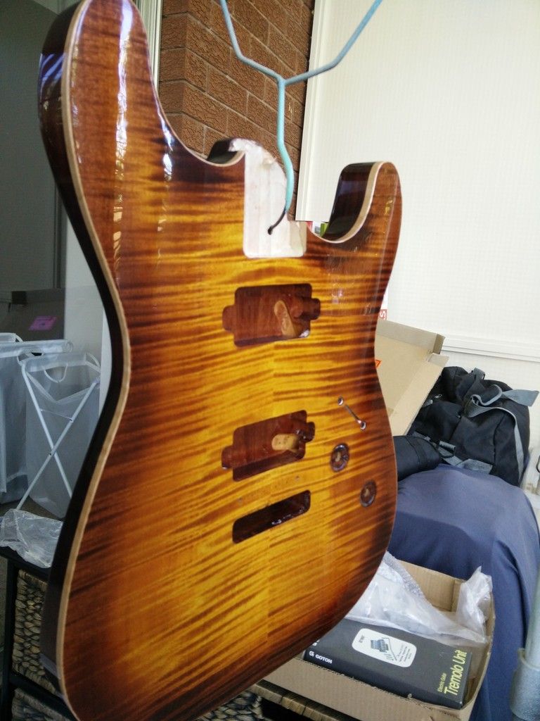

Got the neck done today.
http://i23.photobucket.com/albums/b3...pswtpihm2u.jpg
http://i23.photobucket.com/albums/b3...psd6kpppxl.jpg

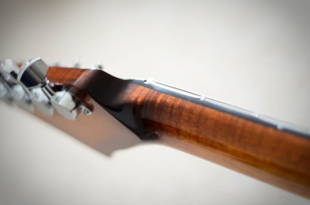

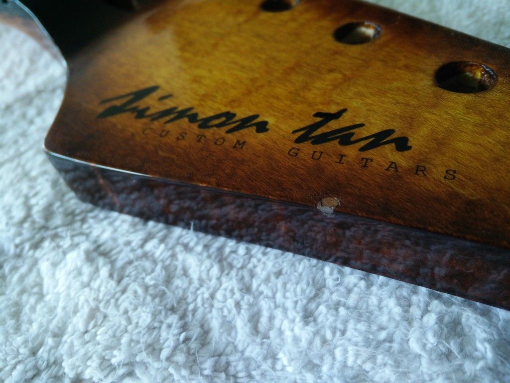

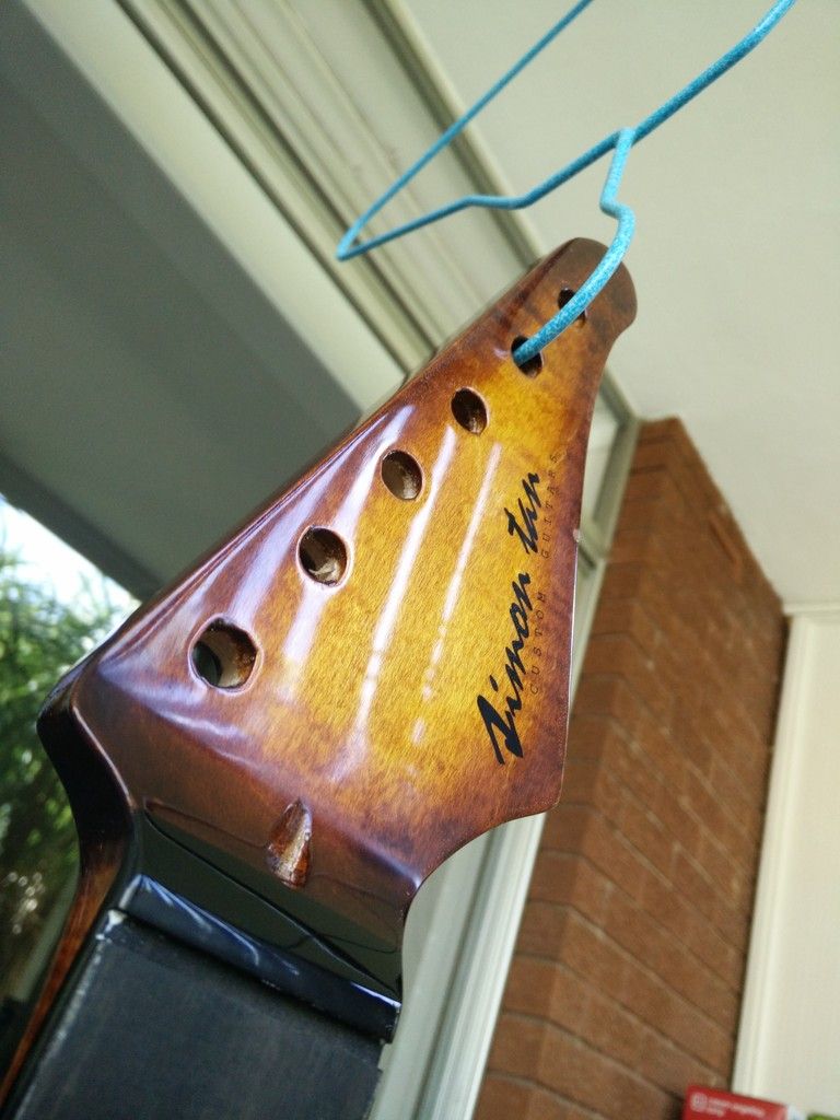

But in my excitement, I accidentally knocked the headstock against the table and this happened...
http://i23.photobucket.com/albums/b3...psownwaymb.jpg
After much cursing and swearing, I've decided to fix this. I don't think it will be hard to touch up. I repaired dings and chips before but the fact that I destroyed it just after making it perfect just made me really sad. :( Don't think I'll be able to get it perfect again but some drop fills with lacquer or even super glue should do the trick. I think the dye is still in the wood.

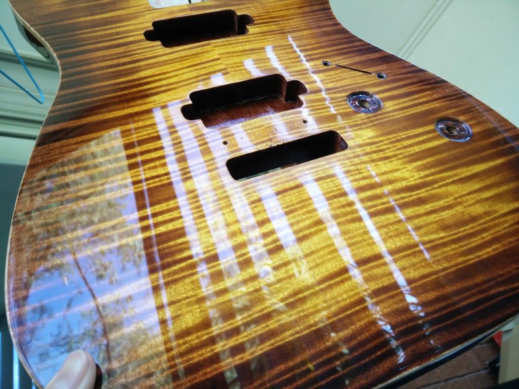

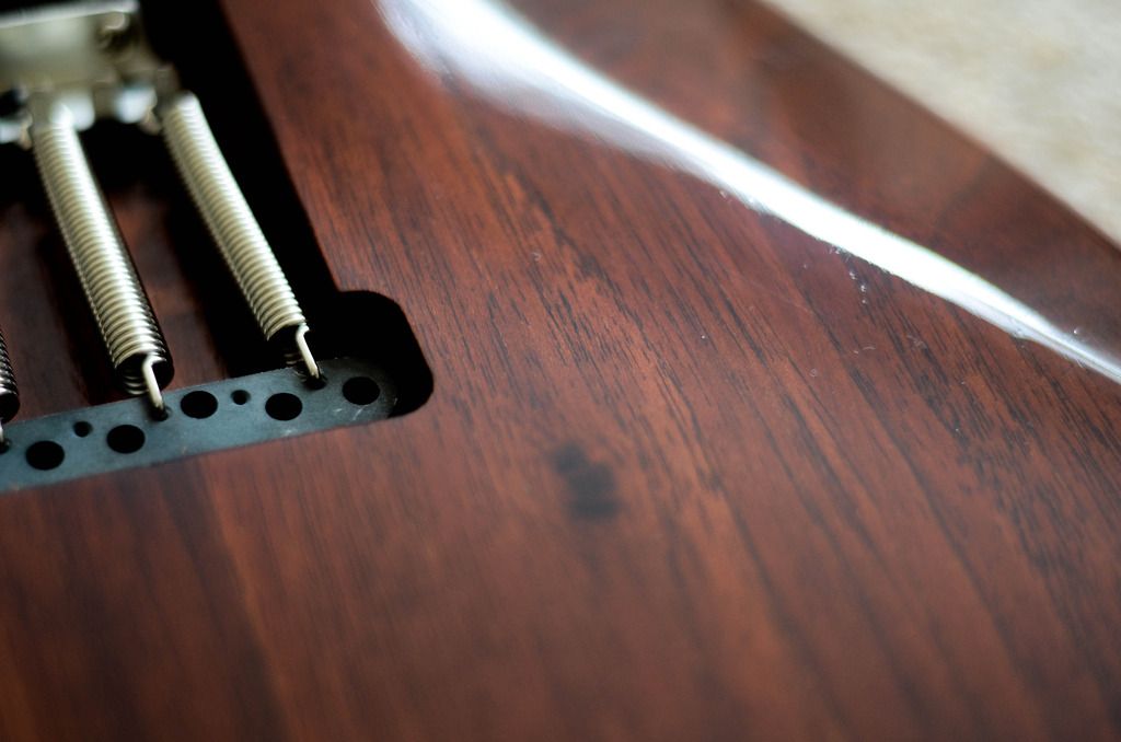

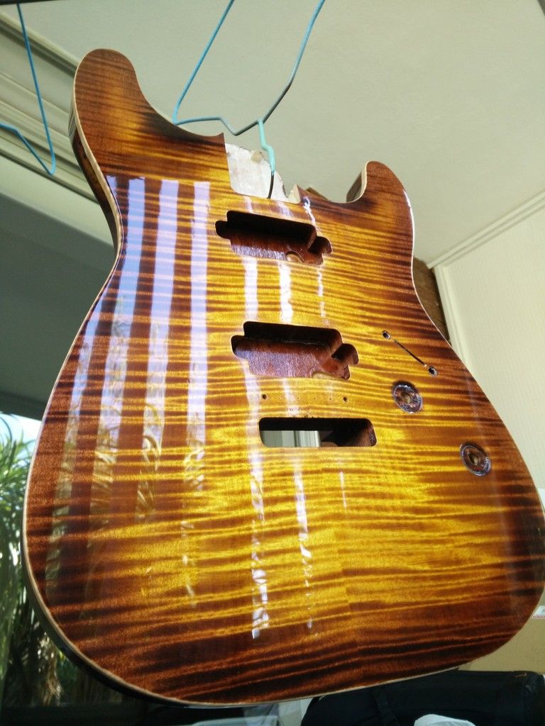

Some more shots of both the neck and body. I think I may have to re-sand some low shiny areas on the body.
http://i23.photobucket.com/albums/b3...psgiyg1a2a.jpg
http://i23.photobucket.com/albums/b3...psdez3un1z.jpg
http://i23.photobucket.com/albums/b3...psrjbxyvof.jpg
http://i23.photobucket.com/albums/b3...psmsgyklq0.jpg
http://i23.photobucket.com/albums/b3...pskb1nsmyd.jpg
http://i23.photobucket.com/albums/b3...pswv16yyun.jpg
http://i23.photobucket.com/albums/b3...pskgtxxv5v.jpg
Apart from that stupid chip and some low spots on the mahogany back, I think I'm pretty satisfied with this rattle can job. This is probably the best high gloss finish I've ever done. It only took me 6 tries hahaha.

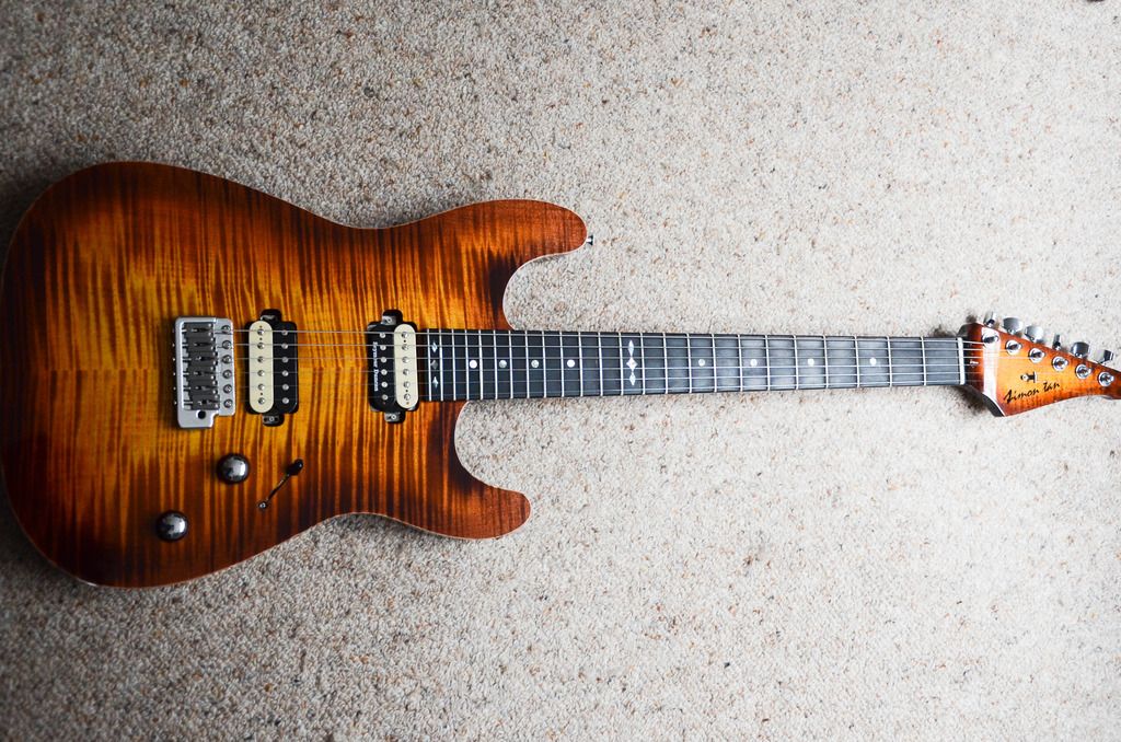

Wow it has almost been a month since I buffed it out. I was working on the bass and was also waiting for a hard case but thanks to Auspost that hard case is lost and I don't know where it is. I was holding out for the hard case before assembling but enough was enough so I bought a gig bag locally instead. I think I have too many hard cases anyway haha. Of course I'll be getting a refund.

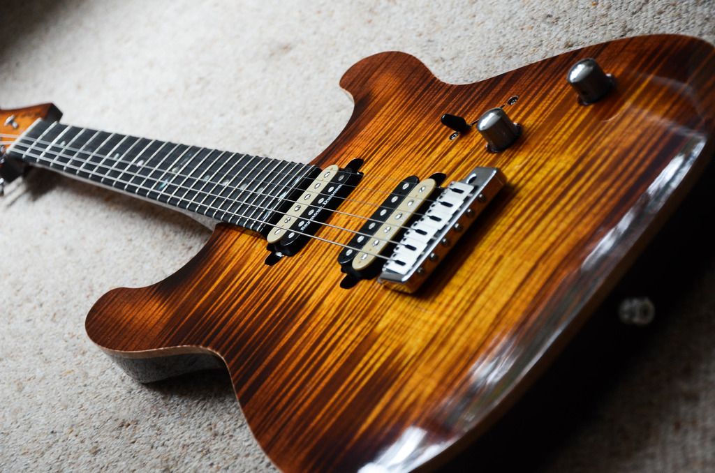

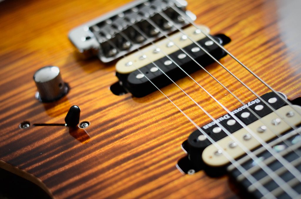

So I hereby present to you, my second build. I will take better pictures with my DSLR on a better day of course. I just spent the last 2 days trying to wire it together, only to find out the problem was with the pot, not my wiring!
Specs:
Hardware:
Gotoh SG318 tuning machines
Kluson modern string retainer
Wilkinson 5+1 contemporary tremolo
Electronics:
Seymour Duncan JB (trembucker) in the bridge
Seymour Duncan Jazz in the neck
5 way super switch wiring: 1. bridge, 2. bridge (north) + neck (south), 3. bridge + neck, 4. neck (north) + bridge (south), 5. neck
500K audio Push pull volume pot, with a blower switch to bypass all electronics and send the bridge pickup straight to the output jack, plus treble bleed mod.
500K audio tone pot with Fender's grease bucket tone circuit.
http://i23.photobucket.com/albums/b3...ps8fzugnu1.jpg
http://i23.photobucket.com/albums/b3...pseue6yigv.jpg
http://i23.photobucket.com/albums/b3...psrahkpa7j.jpg
http://i23.photobucket.com/albums/b3...ps0d2de3ku.jpg
http://i23.photobucket.com/albums/b3...ps1xbr3mdr.jpg
http://i23.photobucket.com/albums/b3...pss0govfus.jpg
Sorry for the blur pics. Will take better ones soon.

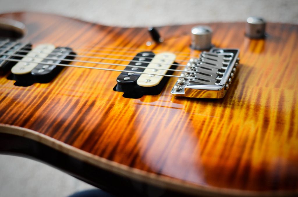

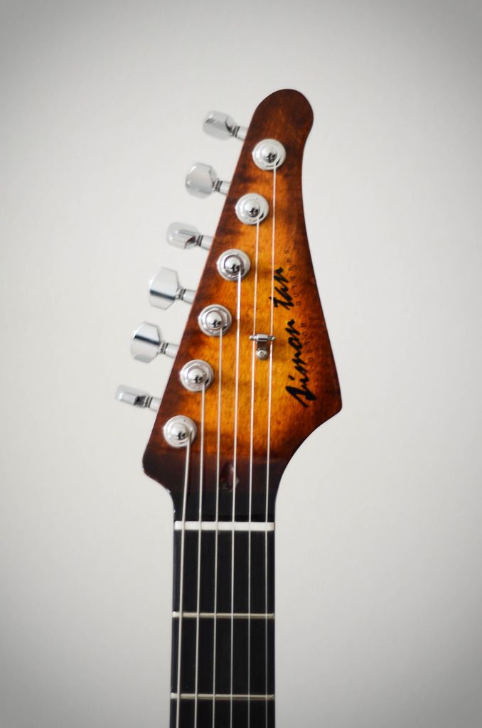

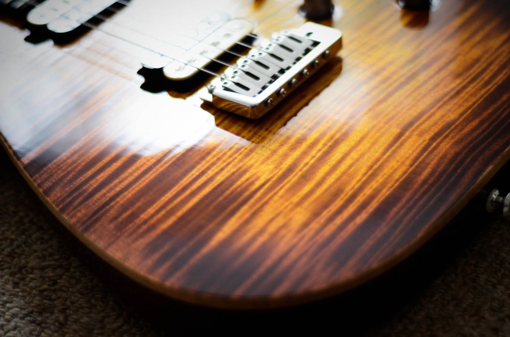

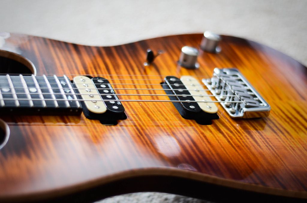

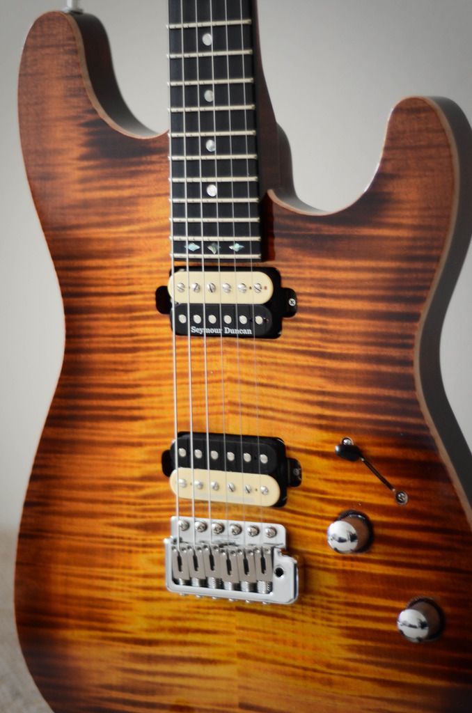

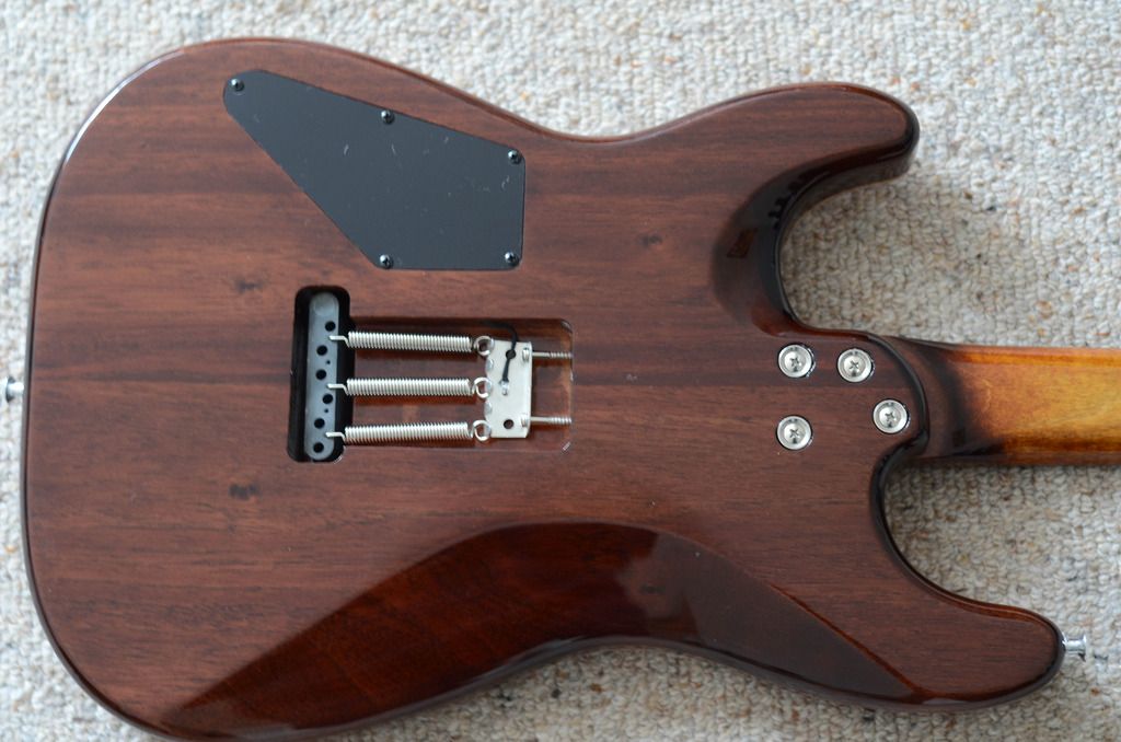

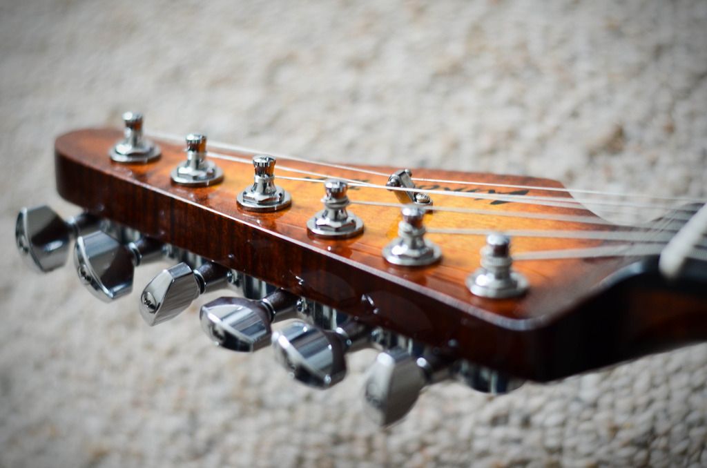

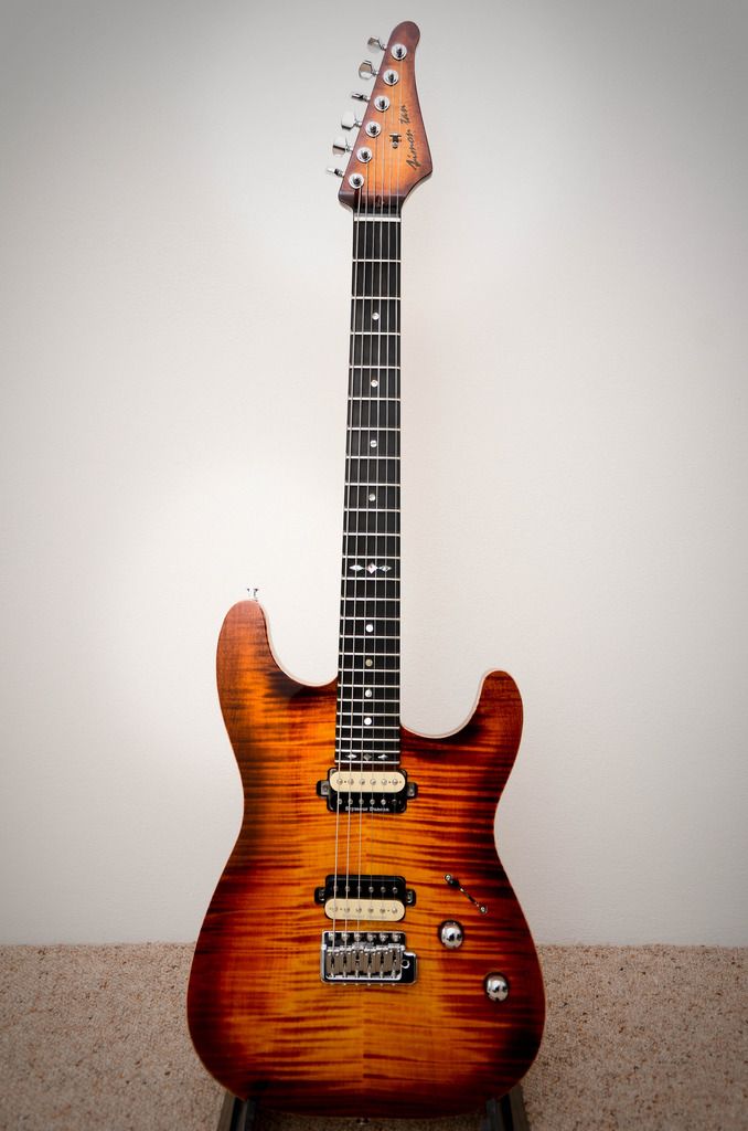

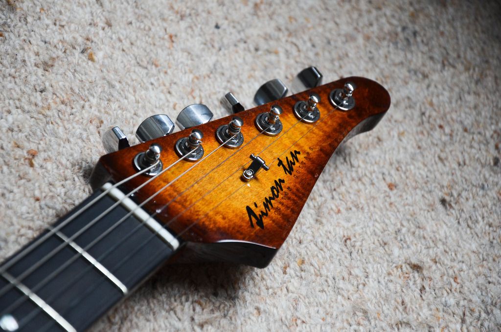

Ok some nicer pics as promised. It wasn't a sunny day so I had to make do.
http://i23.photobucket.com/albums/b3...psguw54eno.jpg
http://i23.photobucket.com/albums/b3...pscqpcyhmy.jpg
http://i23.photobucket.com/albums/b3...pshnlobyqy.jpg
http://i23.photobucket.com/albums/b3...psdy8hpjao.jpg
http://i23.photobucket.com/albums/b3...psvbprjcly.jpg
http://i23.photobucket.com/albums/b3...pswslwh566.jpg
http://i23.photobucket.com/albums/b3...psjbpjrfnb.jpg
I apologise for so many photos of the top - it's just too pretty!
very tasty Simon. Is that bridge set a little high so you can pull up on the whammy bar?
cool, so how is the string action at 24th fret with the higher set bridge?
Never apologise for too many pics! I could look at photos of that thing all day.
Well I must have measured it wrongly because the action was too low to begin with. Hence I also had to raise the entire bridge and the saddles. I could use a shim and may consider using a shim in future but I'll like to see how it holds for now.
Also because I had to raise the saddles higher the string break angle is a bit too much. Plus I'm using 10s on this as I only had them lying around. Hence I think these two factors result in quite a stiff feel. Bending isn't as easy and slinky as the first guitar. I may eventually have to shim the neck to lower the action if it still doesn't feel as fun with 9s.
