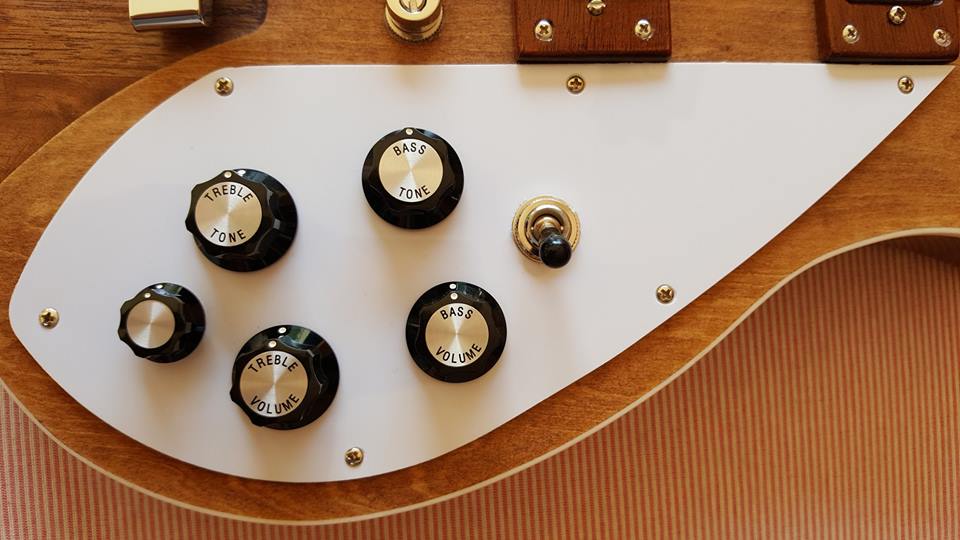

Here you have the specifications:
-Body: Mahogany wood
-Color: Walnut matte nitro finish.
- Mast: Glue mahogany same body finish. Front of logo shovel Black Wolf imitation wood engraving, wide nut (41.4 mm).

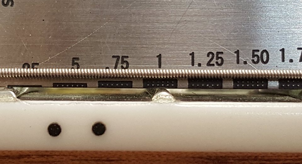

- Fingerboard: Blackwood Tek, 24 jumbo / medium frets, 24.75 "scale, 12" radius, dot inlays.
-Martin made mahogany tablets.
- Pickups: Mini Humbucker bridge position Seymour Duncan SM-1 vintage firebird. and original Epiphone mini Humbucker neck position.
-Place: Gotoh tunomatic modern nickel.
-Cordal: short trapeze cordal.
-Clavijero: Grover 3x3 rotomatic nickel 1:14.

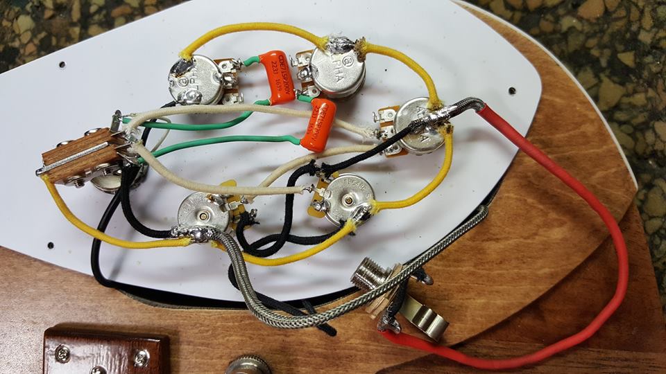

-Electronics: 2 Mini Volume Controls CTS USA 500K (Log.), 2 Tone mini ALPHA Japan 500K (Linear), 1 Mixer mini ALPHA JAPAN 500K (Linear), selector 3 positions Japan, Orange Drop capacitors 0.022 mF and Jack output Switchcraft in rectangular chrome plate.
-Weight: 2,8 Kg
