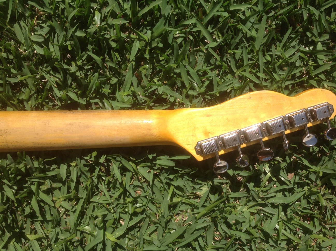

Here it is all done, just the usual fettling to go
Attachment 28162
Attachment 28163
Attachment 28164
Attachment 28165
Attachment 28166

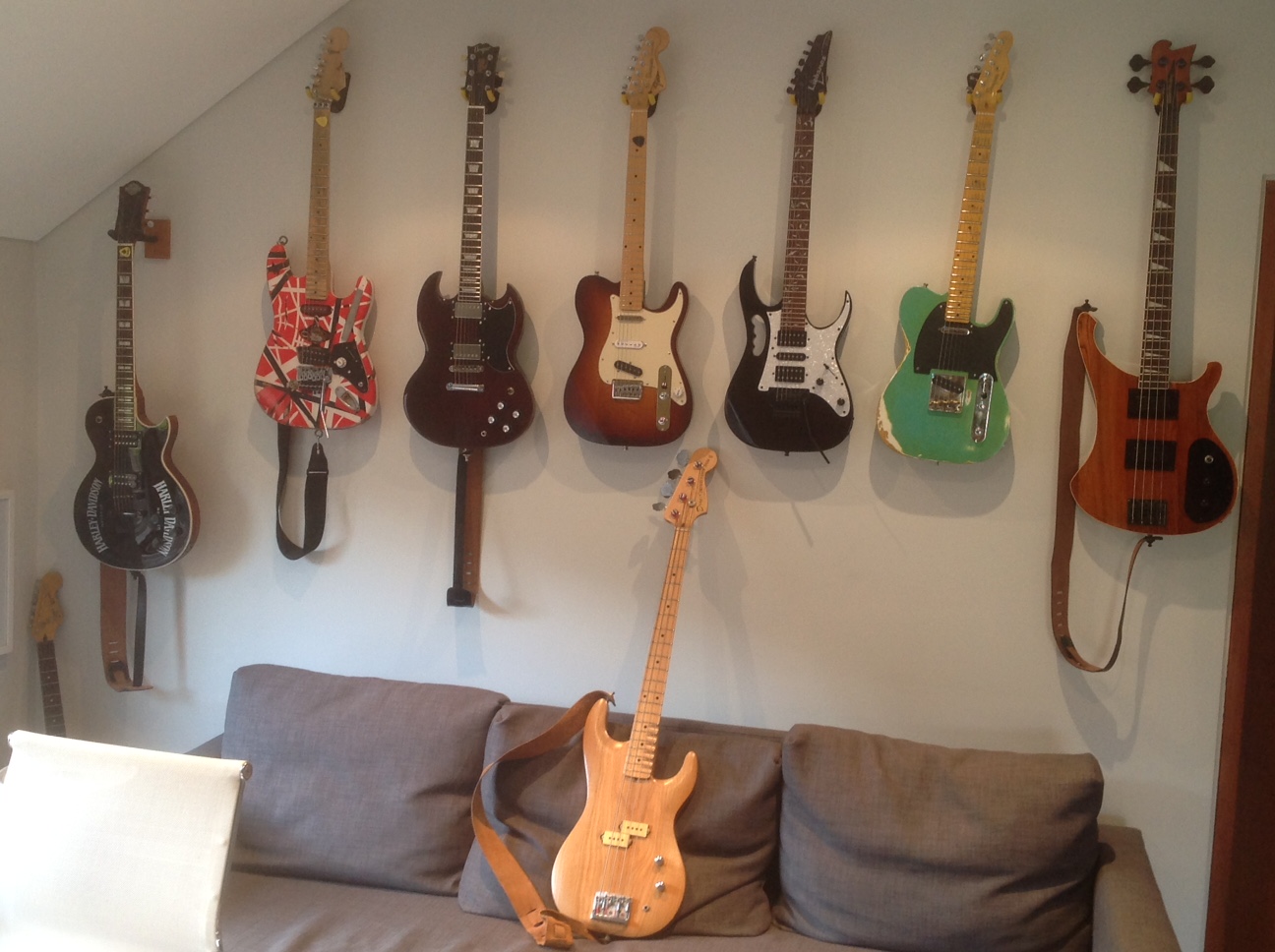

Here it is among the other creations. I guess you can see now how I'm getting close to finished with the guitar building unfortunately!
Hopefully will find family and friends decide they want to take up guitar and give me an excuse...
From the left...
Non PBG LP kit with tonerider rock songs
non PBG strat kit Van halen Frankenstrat with Artist Bullbucker and strat front pickup, bought these two before I found PBG!
PBG AG mahogany kit with bound fretboard, tonerider ac2 pickups
PBG Ash TLa kit with strat bits and tonerider hot classics and entwhistle strat centre pickups
PBG SV1, stock, needs new steel nut
PBG TL51 with tonerider vintage classic pickups
PBG RC4A with Chinese humbuckers
In front, my homemade bass (the one that started it all!), with dmarzio model p pickups
I think that the pick of the guitars is the TL51, so it's good to be finishing up with the best!
I still have the PBG2 and a jazz bass kit on the bench before signing off.........
