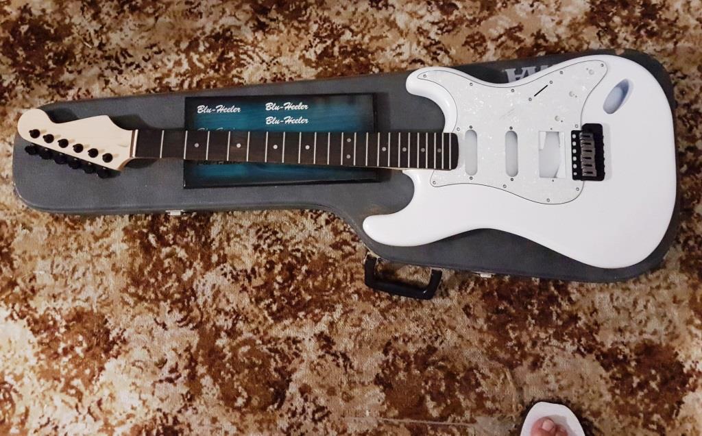

Howdy all!.
Been a while , but always lurking and slowly building- white strat.
finally got he black bridge i wanted and the black tuner uograde from PitBull
next is a zebra HB and 2 black sinlgles
Attachment 29798
regards all,
Guvna
