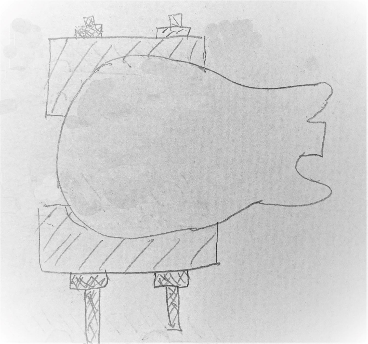

Would anyone have any idea on how to solve this problem? I’d really like to stain the back of this body and not fill The gap and spray solid colour on it? Some glue and clamps maybe?
Is the join exactly on the centreline of the body, such that you’ll be wanting to put a strap button there? And, if you have clamps large enough, can you squeeze the gap closed dry with clamp pressure?
If it’s on the centreline I’d squeeze it closed, mark where your strap button will be, drill a hole for a thin dowel (~5cm deep) at the button mark, unclamp it and squeeze in Titebond (thinned with some water if needed), push in the dowel to force in the glue, then clamp to close the gap. Leave to set and then trim the dowel flush. The dowel provides a solid point for your strap button and will in turn be hidden by it.
If you can’t squeeze it closed dry then injecting thinner glue (CA/super) and/or filling with a glue and sawdust mix may be needed. If it’s not on the centreline then some more pictures and info will help to assess the situation.
1 Attachment(s)
I'd certainly try it, with some lightly watered down wood glue to penetrate the cracks. Use a syringe with a thin nozzle if you have one as it's important to get glue on all those inner surfaces. But it's very awkward shape to clamp, as the edges you want to clamp down hard on are all curved. All I can think of is cutting out a couple of pieces of wood that compliment the edges but the curves go past the middle so that you can clamp it in on both sides of the 'hump' of the body curves to hold it in place like this*:
Attachment 36925
Use the outline of the body as a template to draw out the shape on some wood, and cut it out with a jigsaw or coping saw. You don't need to be super accurate, just good enough so that it fits around the body shape.
*Note how I've deliberately altered the body shape to avoid infringing any possible copyright infringement, and not just drawn it badly. ;)
+ Wierdy's idea is a good one.
I'd check the clamping actually works and closes up the gap with a dry run before using any glue. You don't want a mess of glue in there and then find you can't clamp it and so the glue dries without filling the gap or providing a proper join.
